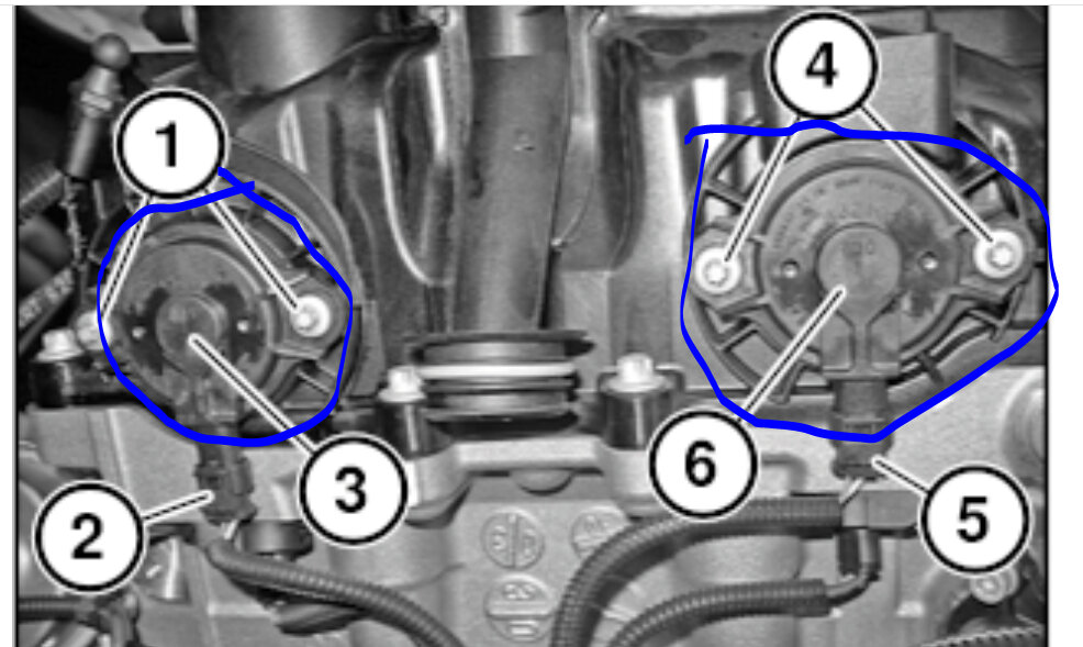

More specifically, the code indicates camshaft A is retarded at start up. Most commonly, this is going to be an issue with either a VVT actuator or VVT timing solenoid. However, it could be a timing issue as well.
Keep in mind, the VVT is controlled by engine oil. If you are hearing a lot of noise, I suspect the solenoid was starved of oil due to dirt or extremely low oil.
I attached a pic below showing the actuators. Start by removing and inspecting them. Also, inspect the timing chain for wear.
See pic below.

So, the front ones are the actuators, where are the solenoids?
Feb 10, 2024 at 6:59 PM
  • 110,194 POSTS
The solenoids are behind those. That is an actuator, the solenoid is at the cam.
