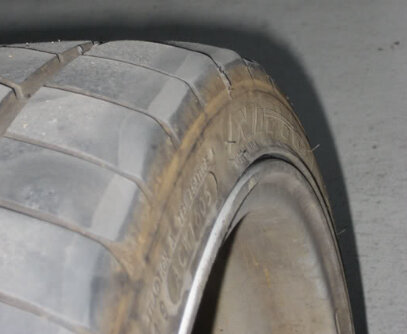

I believe I heard it. It is a deeper growing sound, correct? Please understand, listening to a recording can change things, but to me, it sounds like a wheel bearing. Pay close attention when turning if it changes the sound. If it does, let me know how it changes and what direction you are turning.
Also, make sure the front tires aren't cupped. Make sure they are worn evenly. See pic below. Note that the edge of the tire has both high and low spots. That can cause this type of noise as well.
See pic below.
Feb 16, 2023 at 11:32 AM
ASHLAN0512
  • 6 POSTS
You are correct about it being a deep sound. I haven’t had the chance to test the steering yet, however I have relatively new tires on and there is no cupping or anything so it must be the wheel bearing. How do I know which one and how much will they cost?
