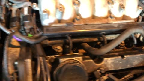

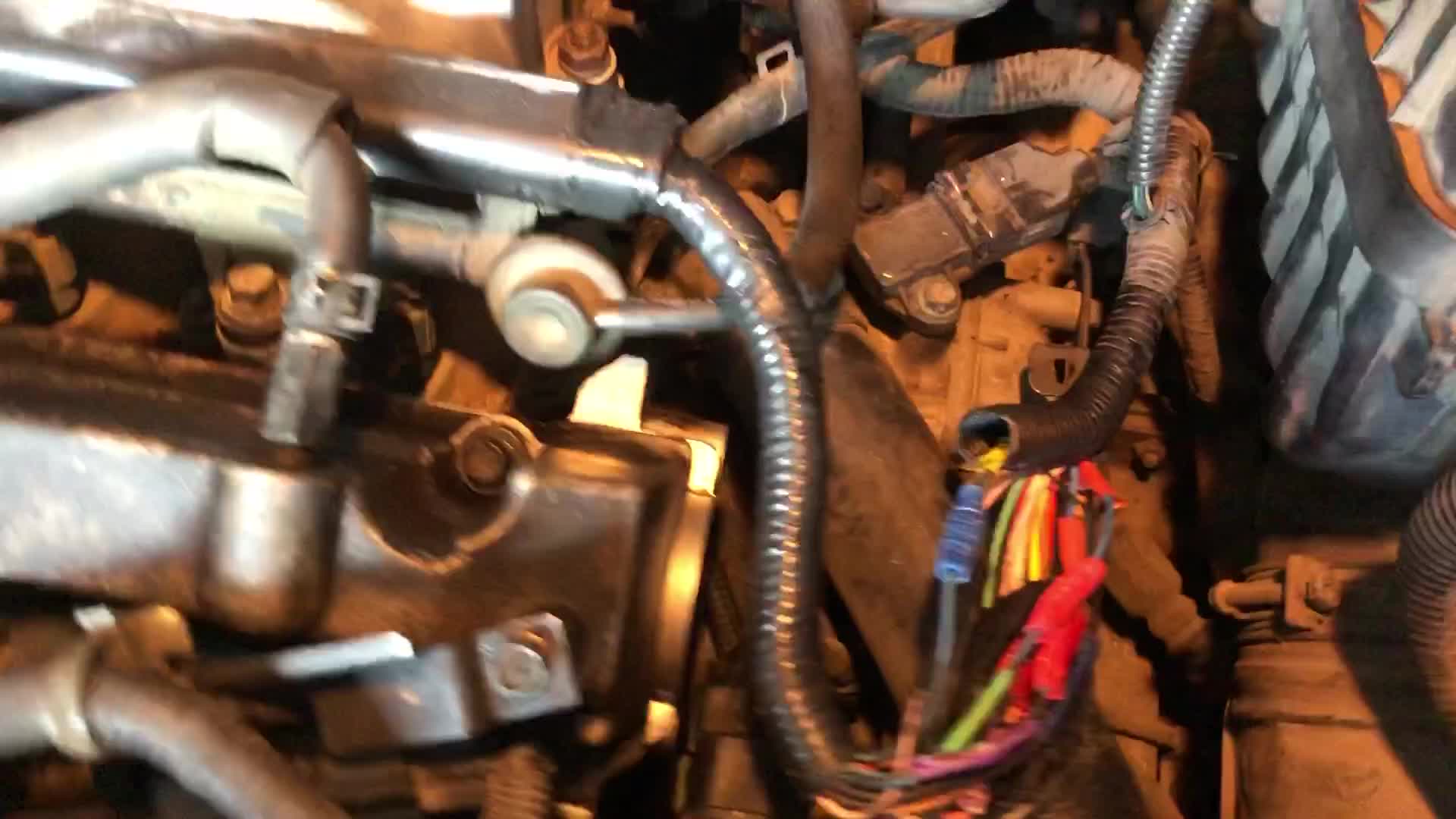

Please listen to the sound in the attached video clip.
There is a noise that I did not notice before I changed the spark plugs, spark plug wires, valve cover gaskets, alternator, A/C compressor, serpentine belt, and idler pulley. It seems loudest at idle speed. It sounds almost metallic to me, but it reduces to barely audible when I disconnect the spark plug wire to the center back cylinder. I thought it might be a spark arcing to the engine, but it continues quietly from near the firewall when the spark plug wire is disconnected. My only other guess is air/fire escaping through the threads of the spark plug. Suspecting a cross-threaded spark plug, I removed the back three new spark plugs and reinstalled them with anti-seize grease. They all came out and went back in without any resistance until tightened normally. I even used a torque wrench to make sure I did it right the second time. The noise seems not quite as loud now, but is still worrisome.

I heard the sound. It sounds like a lifter ticking. However, I don't think that is the problem. If I had to guess, I would say you have a leak at the exhaust manifold. Does it go away or get less noticeable as the engine warms up? The idea that it changed when you disconnected plugs leads me in this directions simply because a lifter noise wouldn't change.

Thank you for listening and commenting. Having a hint that neither of the two most probable causes of the noise would cause immediate serious damage, I felt a lot better about taking it out for a test drive. After warming up, the engine quit making the noise. Later, I listened carefully when I restarted, and heard it again quietly for the first minute or two. All is good!

First, you are very welcome. Since it went away when the engine warmed up, I feel somewhat confident it is an exhaust manifold leak.
