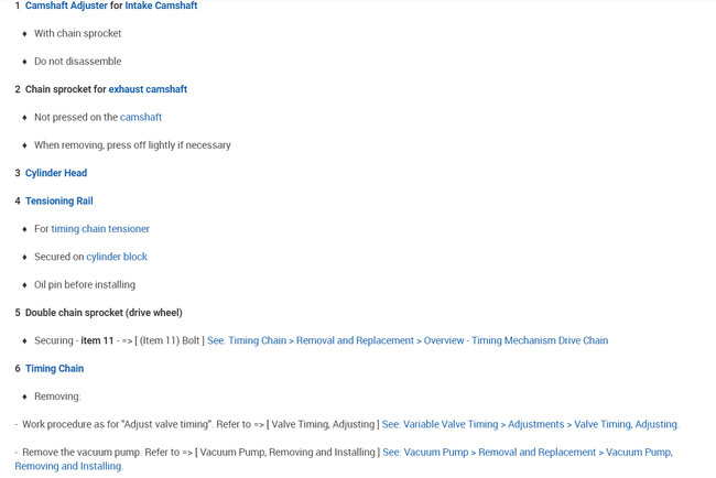

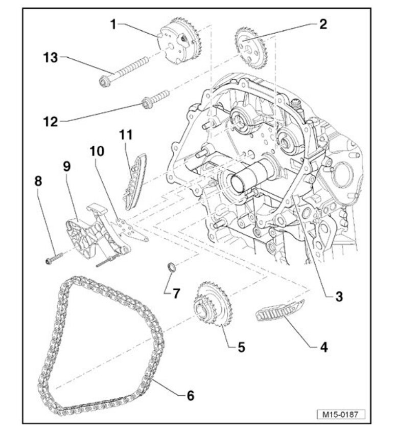

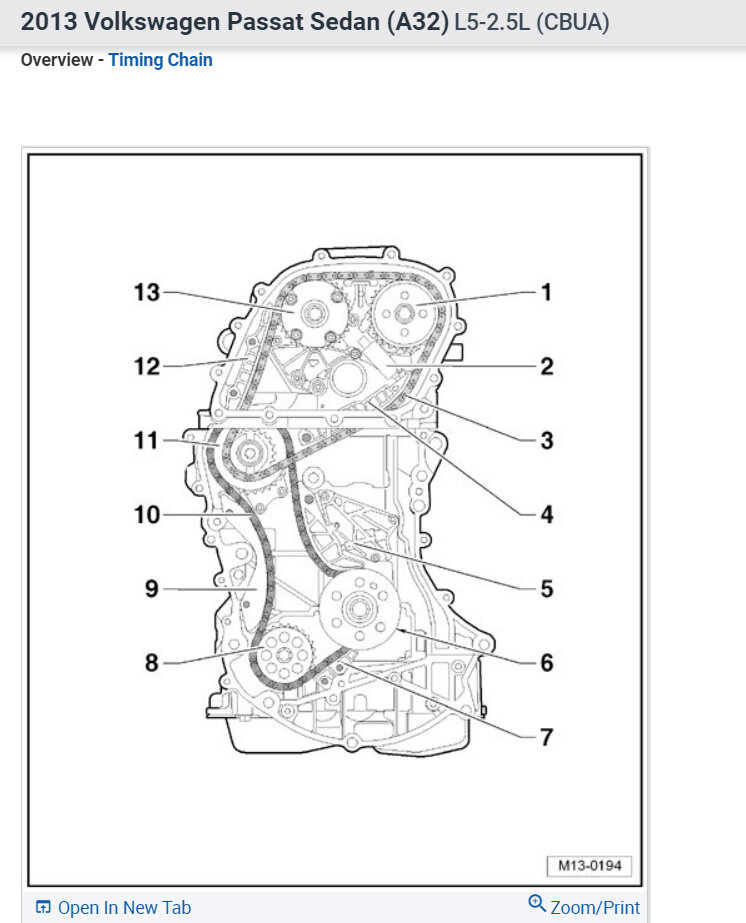

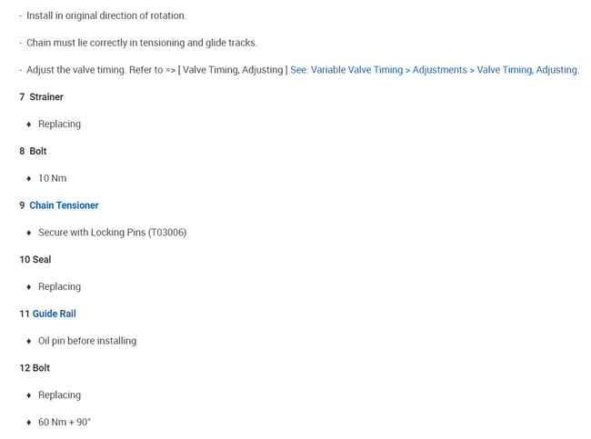

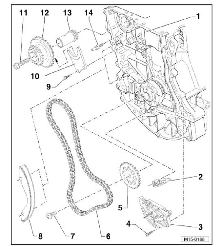

Thanks for the video, it really helps when it comes to noise. The engine noise in the video is caused by the timing chain guides are worn or broken. I have included the timing chain and guide replacement diagrams and instructions in the images below. Check out the images (below). Please let us know if you need anything else to get the problem fixed.

Yes, it is a good size job, and yes, I would do the chains, guides and tensioner. If you let the job go it will end up breaking something and the engine will need to be replaced if this happens.
