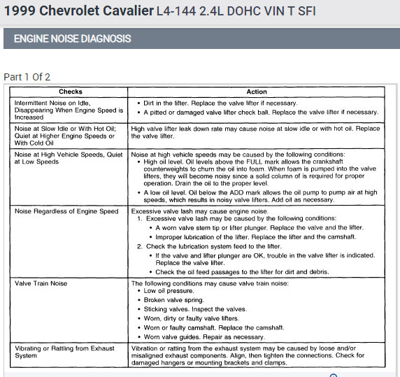

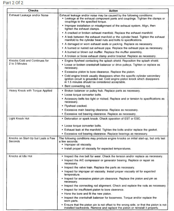

First thing you should do is check your oil level. Low oil could make noise from the engine.
This article might be helpful:
https://www.2carpros.com/articles/engine-noises
https://youtu.be/OTeg2CUB5NE
I have attached a step by step diagnosis procedure.
Let me know if you have any questions.
