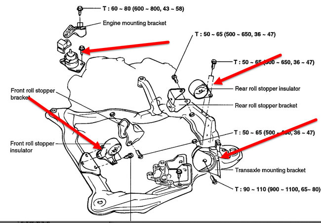

I am needing to take a blown engine and only the engine out of a 2004 Hyundai Santa Fe and replace it. I cannot find all the engine mounts that are holding the engine in. Do you have a diagram for the engine mounts and location of them?

see picture. this shows all there are four for engine/transmission.
