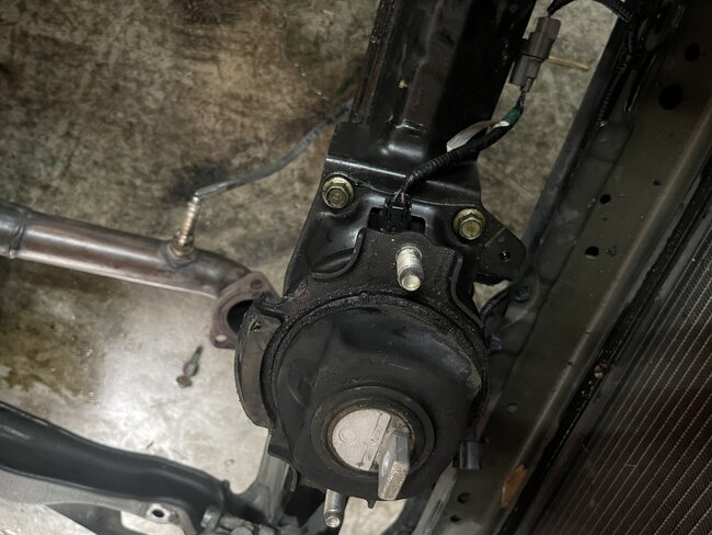

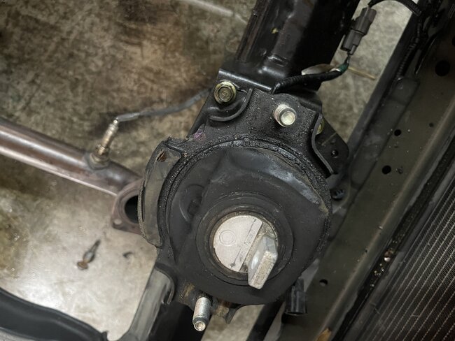

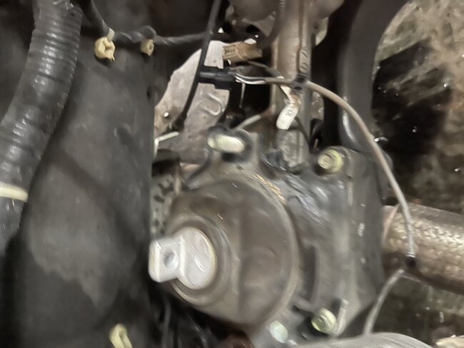

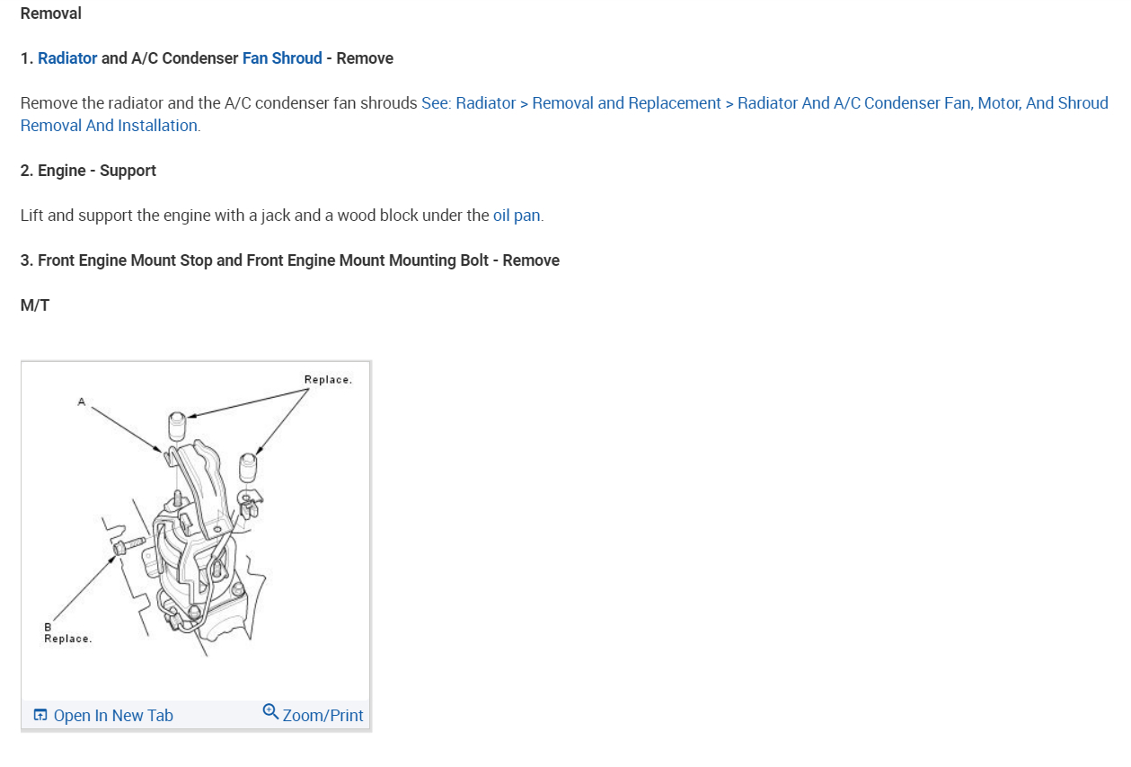

Do these look bad? Nothing is leaking from them and moving them they are sturdy, not sure if they been replaced before, but i think most Hondas engine mounts look like this with the weight on them.
Mar 29, 2023 at 7:09 AM
  • 55,433 POSTS

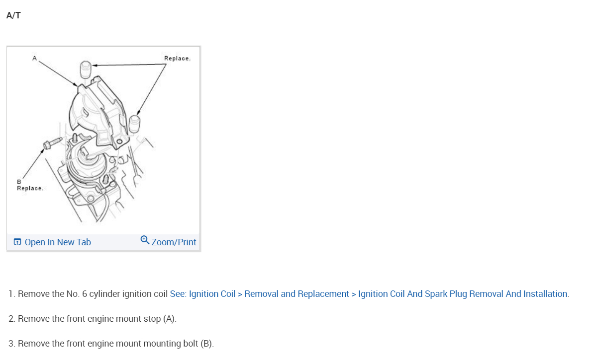

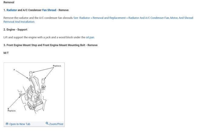

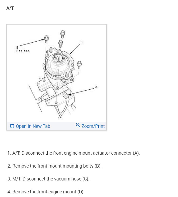

Thanks for the images, it helps, if the mounts are not leaking you are okay, I think I see a little seepage around the base of the mount can you inspect the mount further to confirm if so, the mount should be replaced, here are the instructions in the images below. It looks like you are supposed to replace the mounting bolts along with the mount FYI.
Mar 30, 2023 at 3:25 AM
BHAMDOC1973
  • 2,007 POSTS
They just trying to sell you more bolts lol...
Mar 30, 2023 at 3:27 AM
  • 55,433 POSTS
lol yep. Use 2CarPros anytime, we are here to help. Please tell a friend.
