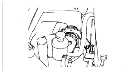

Hey, I want to change engine mount for my car. (Front two mount )
If possible valve cover gasket.

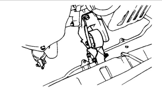

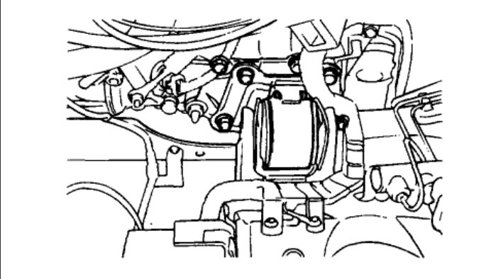

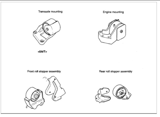

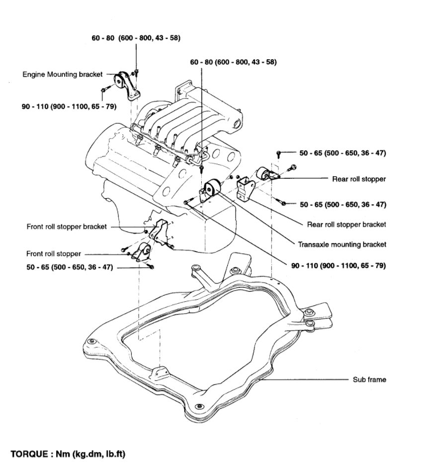

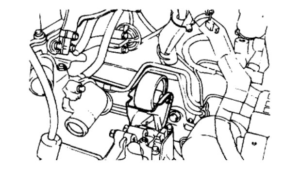

  • 55,710 POSTS
Yes a jack is used under the engine.
Here are some diagrams (below) and a couple of guides to help you see what you are in for when doing the job:
https://www.2carpros.com/articles/replace-motor-mounts
and
https://www.2carpros.com/articles/how-a-motor-mount-works
and
Below are the diagrams.
