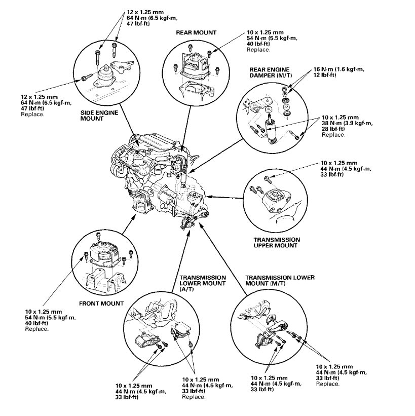

I have 2 broken bolts in the top of my side engine mount bracket. I have removed the 3 bolts that attach the bracket to the block but it still doesn't want to come free.
What is the procedure for removing the side engine bracket (not the side engine mount itself}?

There must be a bolt that is still holding it. here is a diagram to show you how below. Can you please shoot a quick video with your phone so we can see what's going on? that would be great. You can upload it here with your response. Check out the diagrams (below). Please let us know what happens.
