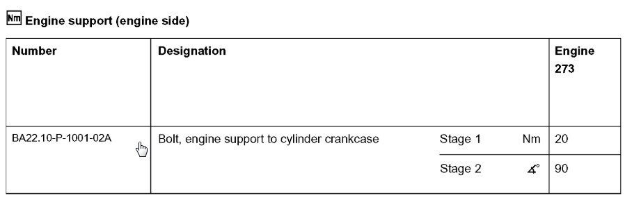

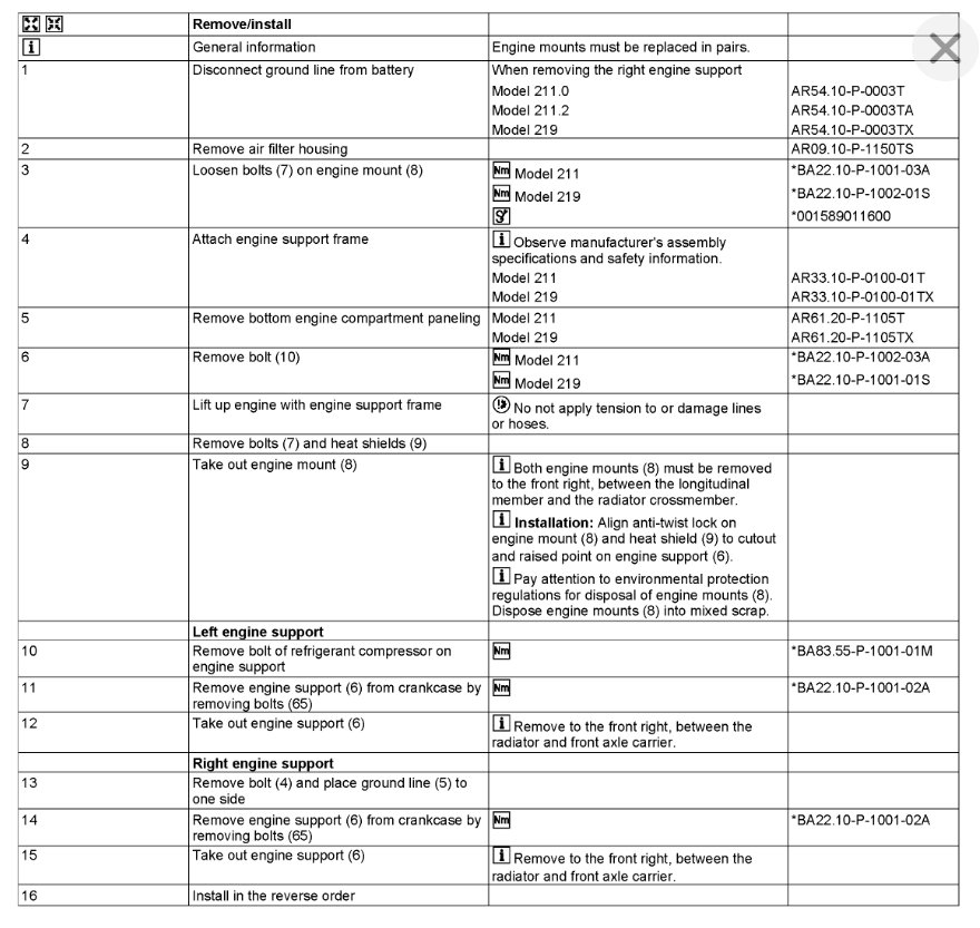

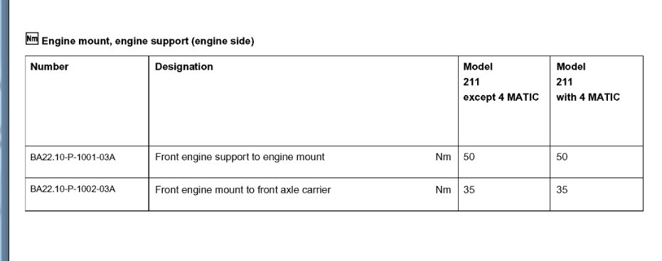

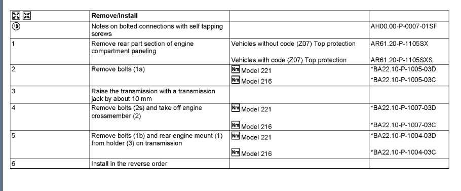

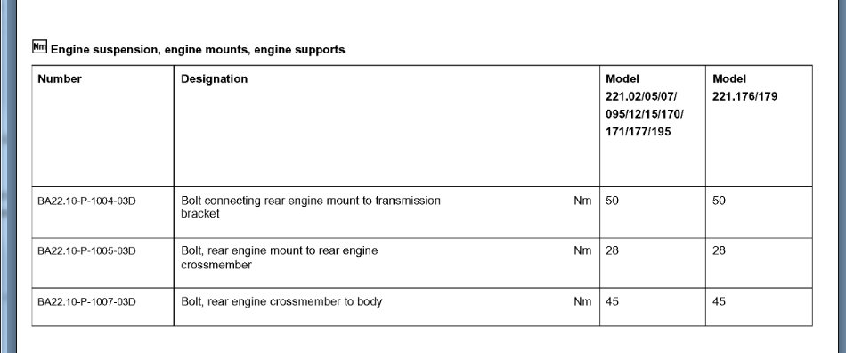

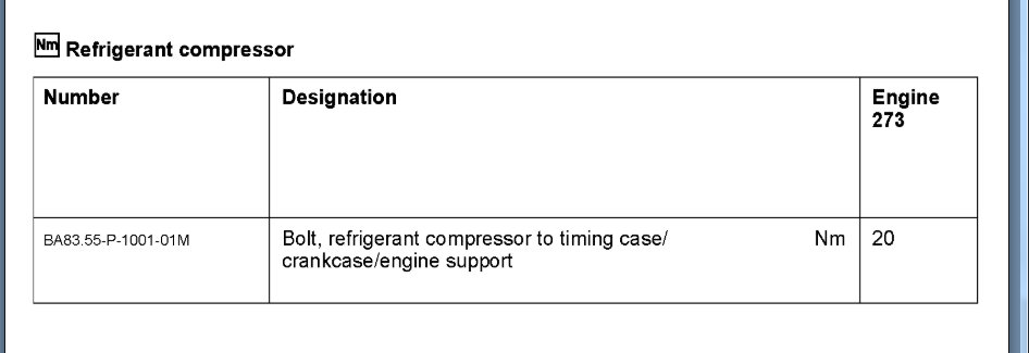

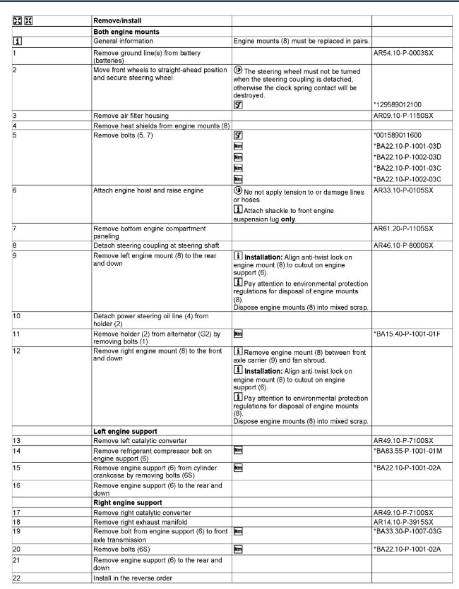

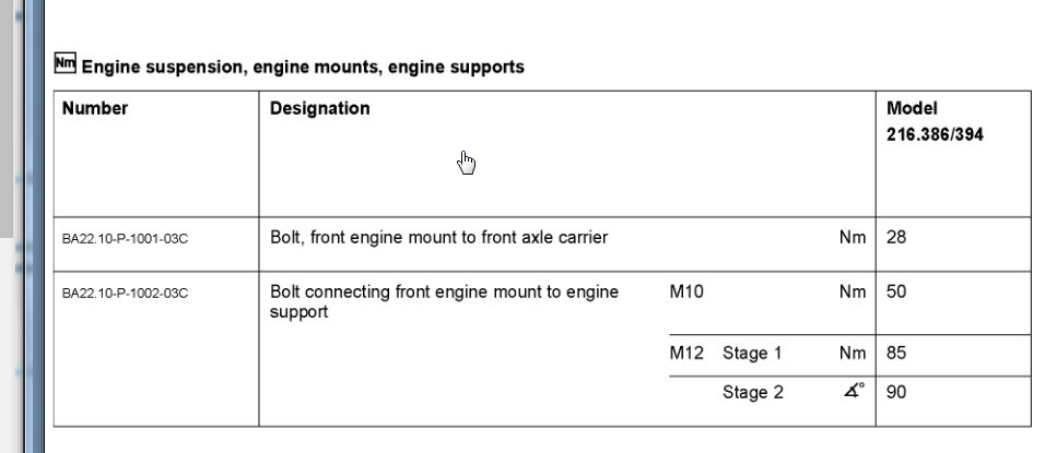

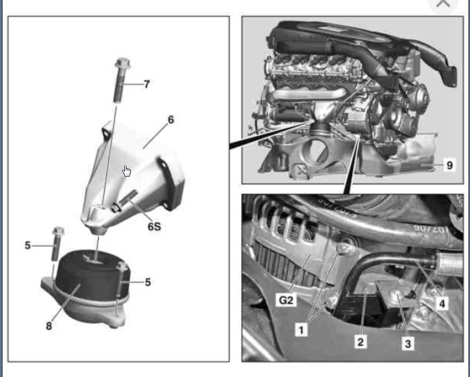

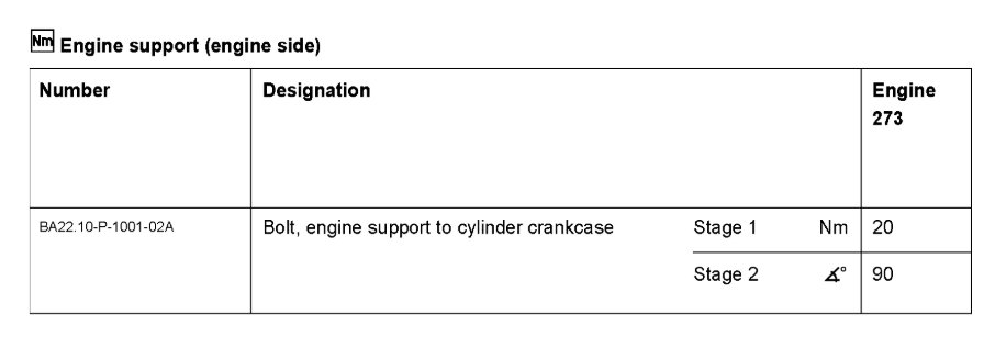

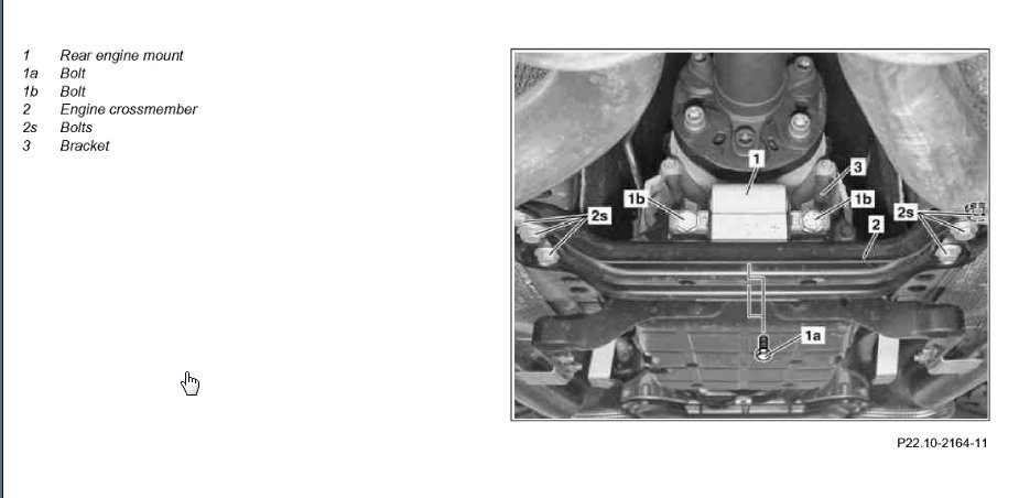

I believe an engine mount(s) have caused one of the axles to go bad, replaced that. now i need to see how to go about replacing the engine mounts. 4matic.
Jul 10, 2020 at 5:51 AM

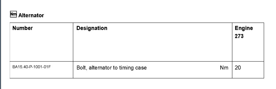

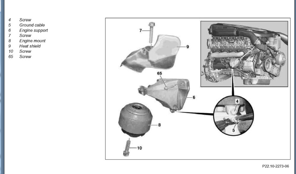

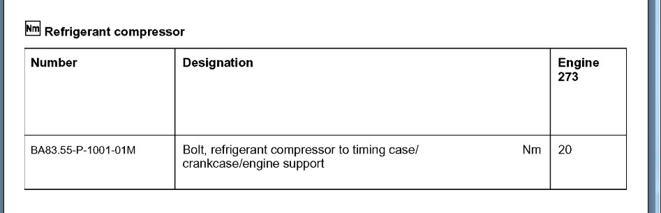

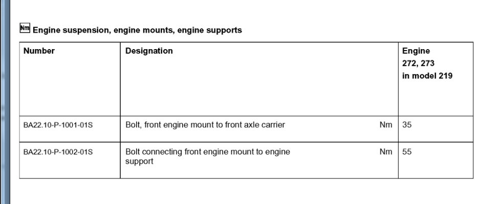

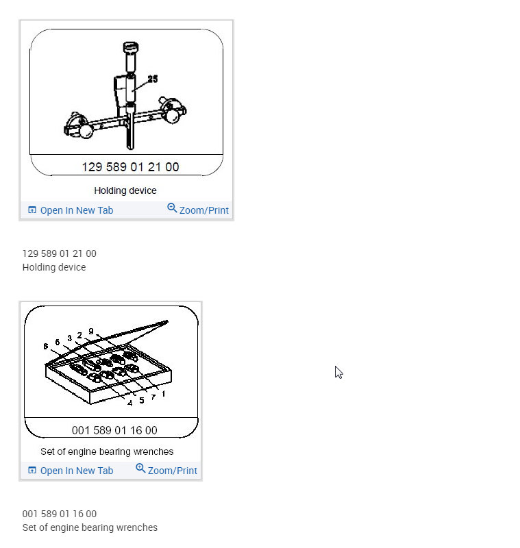

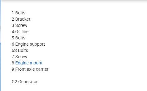

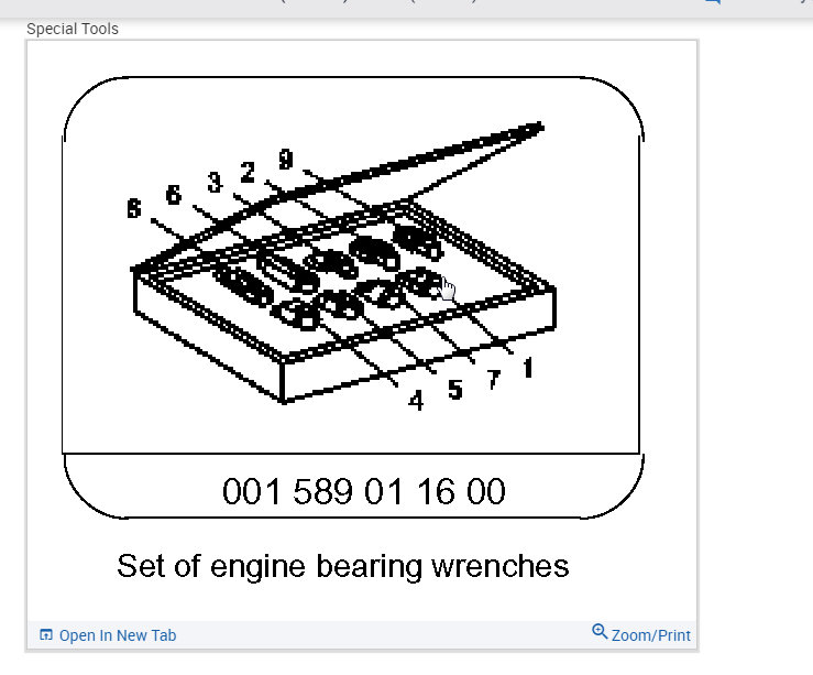

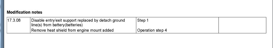

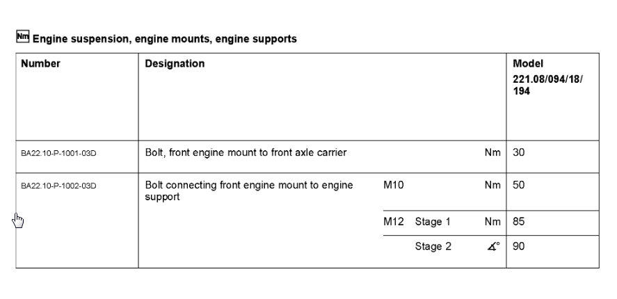

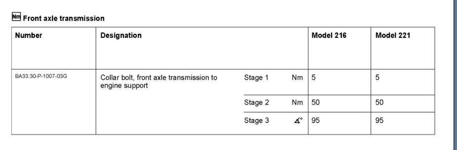

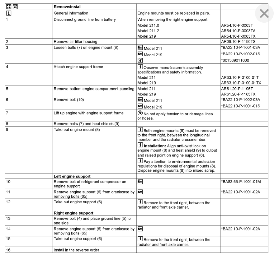

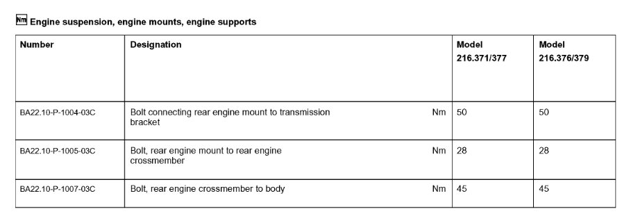

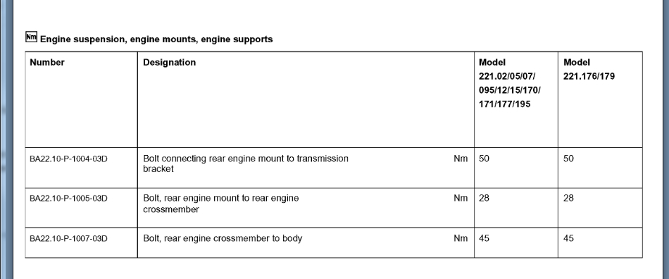

I attached the process for all 3 mounts. Let us know if you need more info. I have never been a fan of these Mercedes manuals as they are not extremely detailed but it appears all the info is there for each one.
