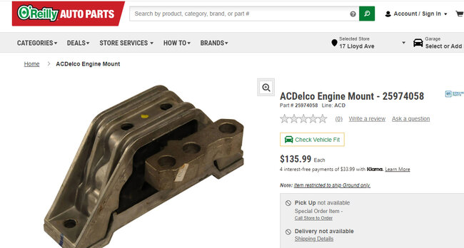

Left engine mount discontinued for my car listed above ion 2. i cannot find one anywhere. Do you know if any other years or models are interchangeable with mine?

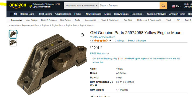

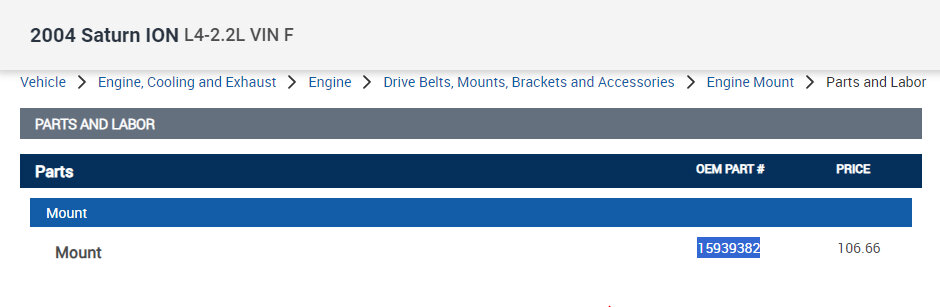

I found several. Part number 25974058 has superseded all of the original numbers. The original manufacturer part number was 15939382.

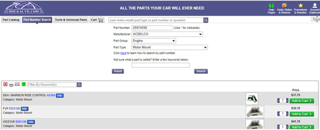

If you check on google, type in Saturn part number 25974058 and you will find what is needed. I attached some pics below. Rockauto.com is a lot less than the others.
Let me know if this helps.
