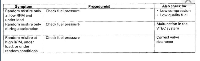

driving at different speeds the car starts missing like there is water in the gas. i changed gas stations and added water remover in gas.still does it. it doesn't do it all the time.sometimes drive 10 to 15 miles but it starts again. timing belt,plugs all been changed.
Jul 22, 2019 at 2:57 PM
SCGRANTURISMO
  • 4,897 POSTS

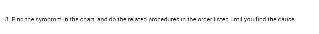

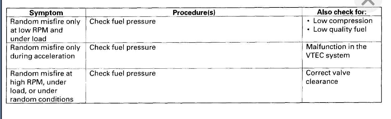

In the diagrams down below I have included the Honda factory diagnostic troubleshooting guide for random misfires for your vehicle. Please go through this guide and follow the directions and get back to us with what you find out, or you need more specifics on the directions.
