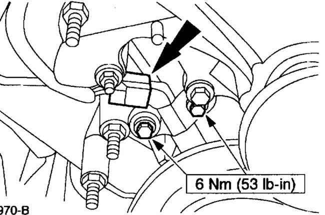

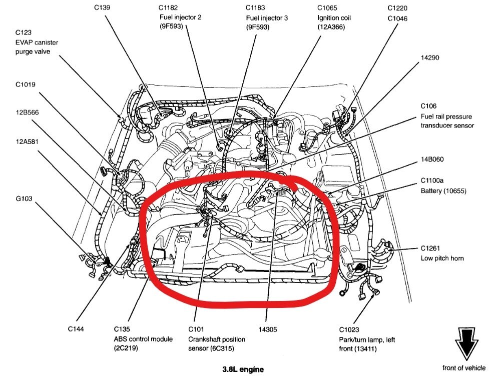

As the belt broke, I would look at the crankshaft sensor to see if it was damaged by the belt. It is located near the balancer on the front of the engine. Also look at the other wiring in the area and look for any damage.

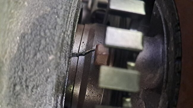

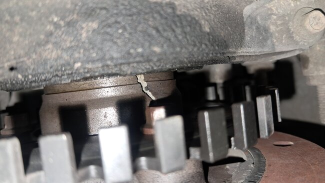

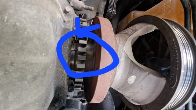

Could this have made it jump time? Because that's what it acts like.
May 21, 2025 at 1:47 PM
LUTTRELLDAVID21
could this have made it jump time? Cause that's what it acts like.
STEVE W.
  • 15,353 POSTS
That is a keyed system, so it is possible that it grabbed and cracked it and sheared the key in the process. That is an easily replaceable part at least. I would get a replacement balancer, front seal and key. Then it's a matter of removing the belt, unbolt the balancer and use a puller to remove it. Replace the sheared key and install the replacement part. Torque it to 118 lbft and reinstall the belt.
