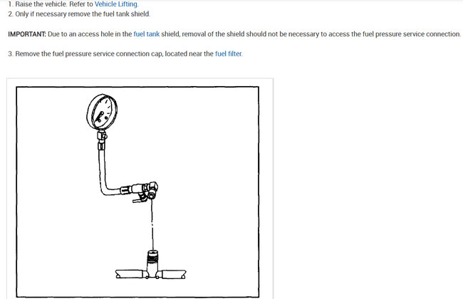

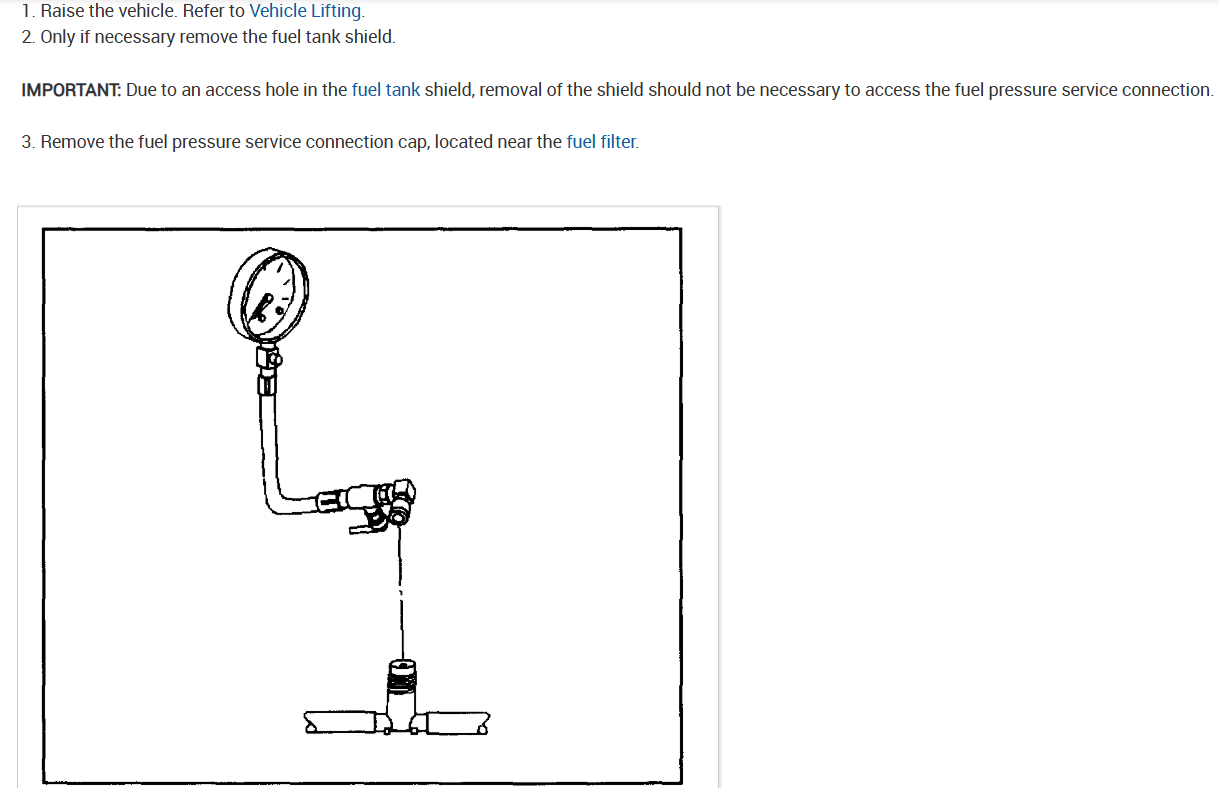

I would definitely replace the plug wires. Also, I have seen weak fuel pressure cause this issue, but we should run the codes to see if any are stored, it could be an EVAP purge valve that is stuck open.
Here are two guides that can help us find out what's going on:
and
Fuel Pressure .................... 334 - 375 kPa (48 - 54 PSI)
Fuel Pressure Drop (After 1 minute) .................... 34 kPa (5 PSI)
Check out the images (below). Let us know what you find.
