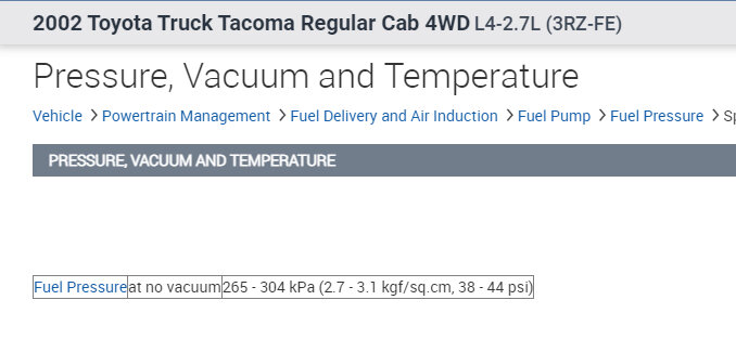

The idea that you have the P0171 leads me to think either you have an engine vacuum leak, or the fuel pressure is low.
If you haven't already, confirm there are no leaks.
Here is a link that explains how to locate and repair engine vacuum leaks:
If you are unable to find any leaks, I would move to checking fuel pressure to make sure it is within spec.
Here is a link that explains how that is done:
If you look below, I included the manufacturer's fuel pressure specifications.
Let me know what you find.
See pic below.
