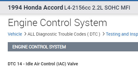

The engine light tells me Code 14 Idle air control valve or bad ECM.

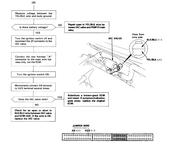

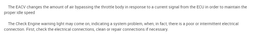

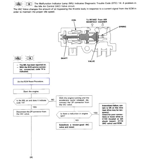

Does the misfire only happen at idle? I ask because once you press the throttle, the IAC is bypassed, and air enters via the throttle body/throttle plate.
As far as the code, I attached the description and diagnostics specific to the code and this vehicle. Take a look through them and let me know if you are comfortable performing them.
