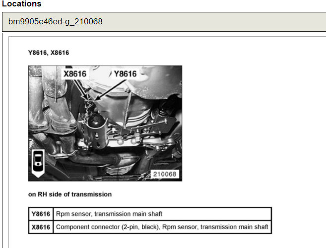

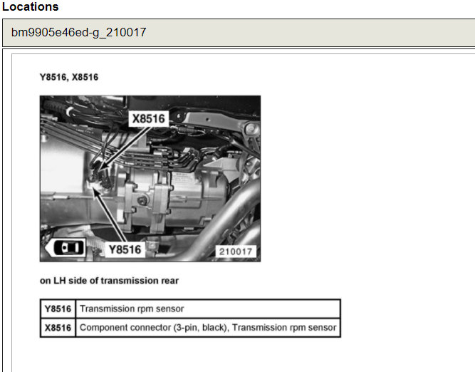

These codes can be caused by a shaft speed sensor that is out of range. Here are the sensors locations. I would try the sensors first
Feb 13, 2018 at 11:13 AM
LIAM MCCAULEY
Is this for the manual gearbox?
Feb 14, 2018 at 12:31 AM
LIAM MCCAULEY
Thanks for the reply! Yes I am sure it is u0303, but like you said it is not four wheel drive. possibly maybe the code reader I am using? It is more of an engine misfire so it sounds as though it could be p0303.
Feb 14, 2018 at 1:05 AM
  • 55,721 POSTS
My bad, I did not see the transmission type. I would go with what Steve W. has suggested.
