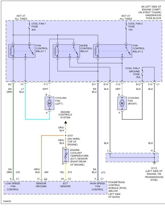

This vehicle only has 43,000 miles on it. It starts and runs fine until the water temperature gauge reaches 180 degrees. Then the engine starts to run rough. It idles okay but from 3,000 to 4,000 rpm it starts to misfire, backfire, pre-detonate, and the water temperature quickly jumps to 210-215 degrees. Both of the cooling fans operate but only on high.
Neither the "Service Engine" nor "Service Vehicle" lights illuminate so there are no codes. I checked for them anyway but there are not any codes so at this point I am just guessing.

Try replacing the mode control relay and the fan control relay #1 both in the underhood fuse block shown here.

Thank you. I will trying that today.
