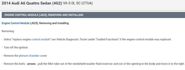

I would run the codes to see if any are stored. This guide can help. You may have a cracked spark plug causing the problem FYI.
This guide can help as well:

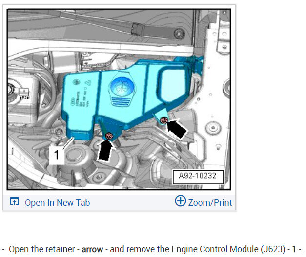

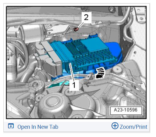

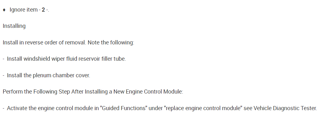

The water damage on the ECM is not good as well, you can send it out for testing or get a rebuilt preprogrammed unit. Here is the location and how to change it out.
