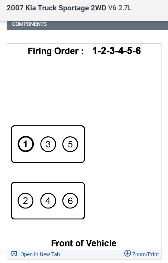

My engine seems to run fine, but I have a check engine light on and ODB codes for misfires on cylinders 2,4,6 as well as multiple cylinder misfire. I've replaced the ignition coil, affected spark plugs, affected spark plug wires, oil cap, distributor vacuum advance hoses (they were cracked), and cleaned the MAF. Light is still on.

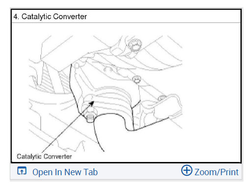

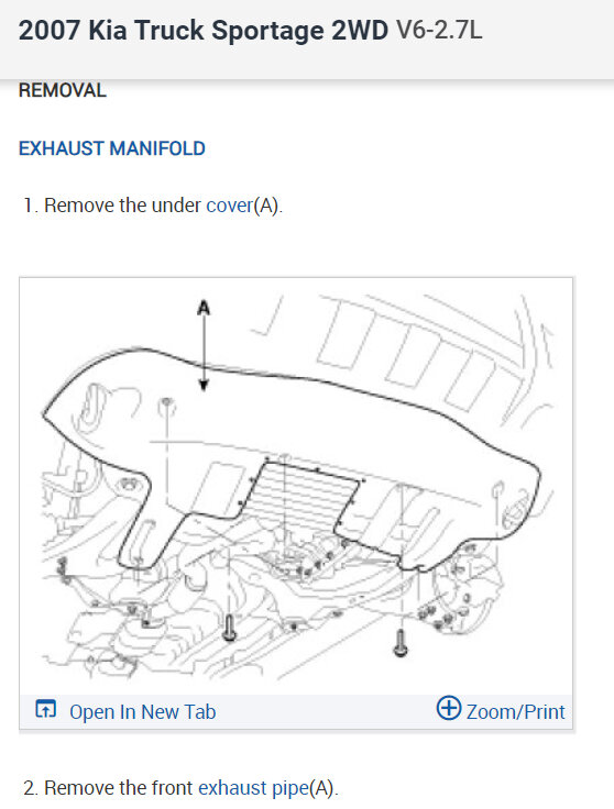

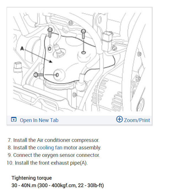

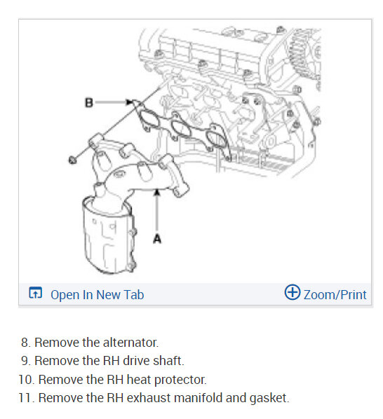

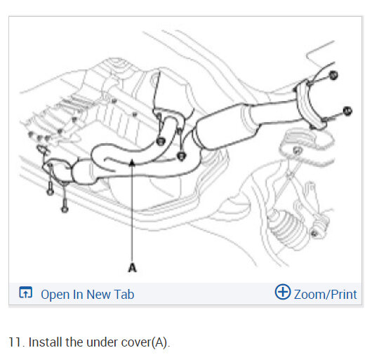

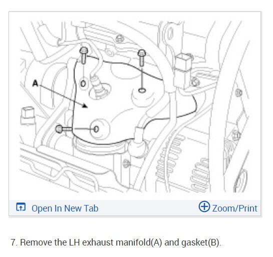

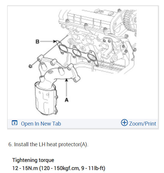

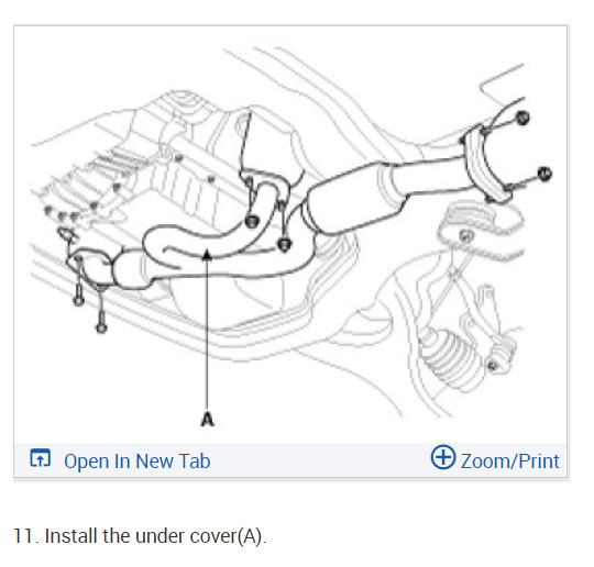

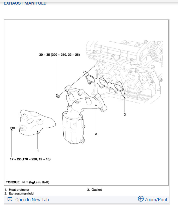

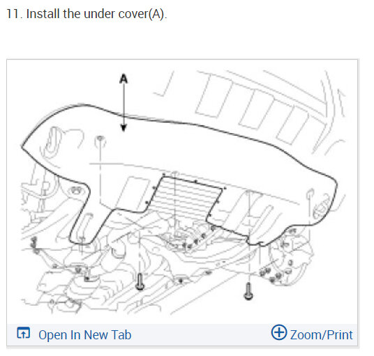

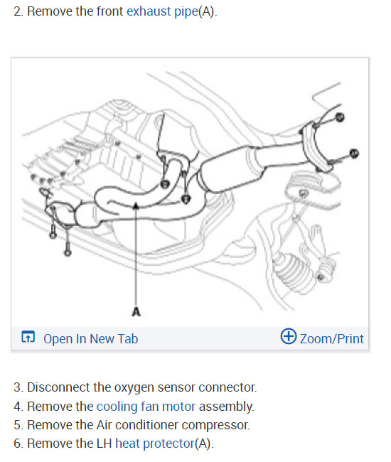

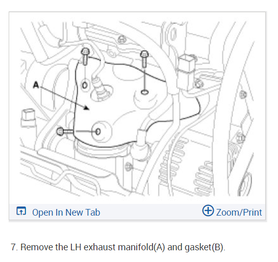

Yep, yep, this is caused by a bad catalytic converter on the same side as the misfires. Here is how to remove it so you can inspect the catalyst material inside. The converter you are looking at will be on the left side of the engine, (closest to the front of the car). This is a common problem. Check out the images (below). Please upload pictures or videos in your response to the problem so we can see what's going on.

It is pretty much the only thing that can affect all the cylinder on one side, so I am pretty sure this is the problem.
