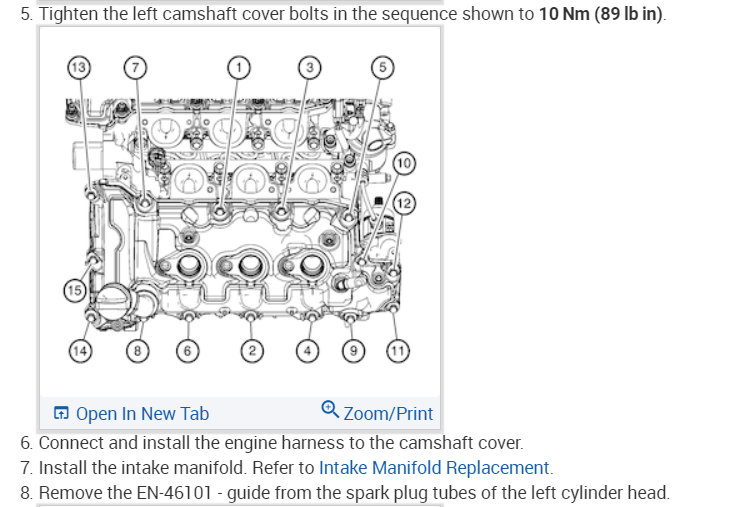

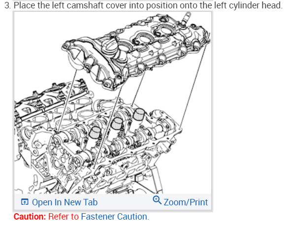

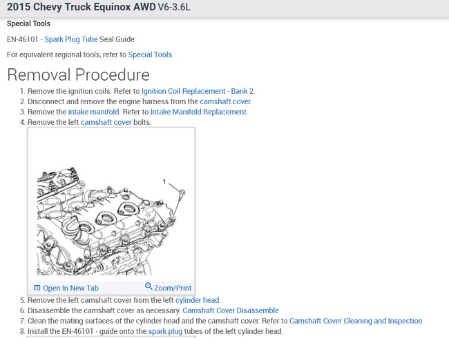

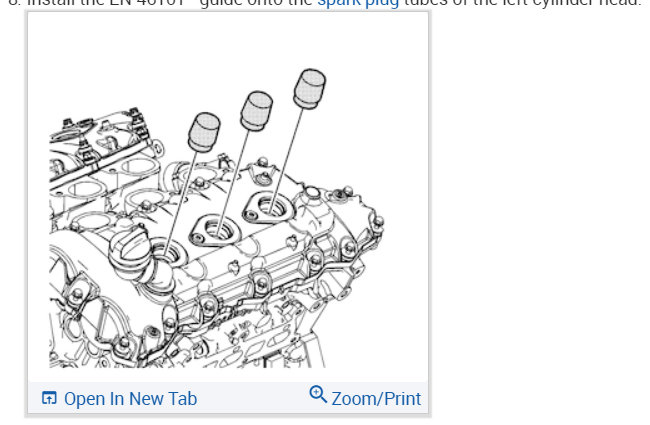

Yep, low compression in #3 cylinder is causing the issue. I would pull the valve cover to see if you have a broken valve spring which can cause the problem. here is a guide to help you step by step to pull the cover with diagrams below to show you your car. Use a flashlight once the cover is off the check the valve spring winding's.
https://www.2carpros.com/articles/replace-valve-cover-gasket
and
https://www.2carpros.com/articles/the-reasons-for-low-compression
