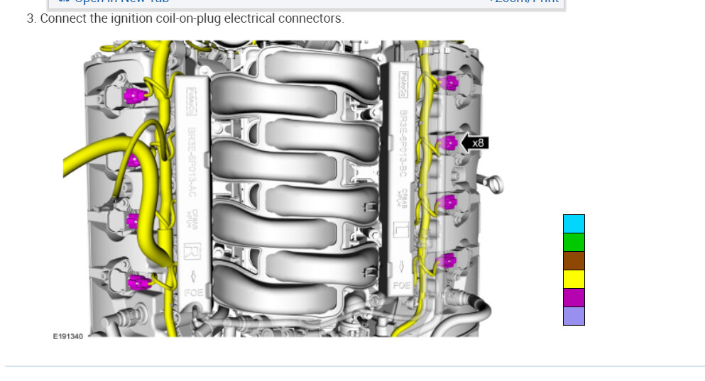

I replaced the VCT solenoid on my truck listed above and it fixed the issue. However, I started to get a cylinder misfire (P0301) after replacing the solenoid. The check engine light turns off sometimes and comes back on with the same misfire. The code wasn't there before.
Feb 22, 2023 at 10:05 AM
  • 55,381 POSTS

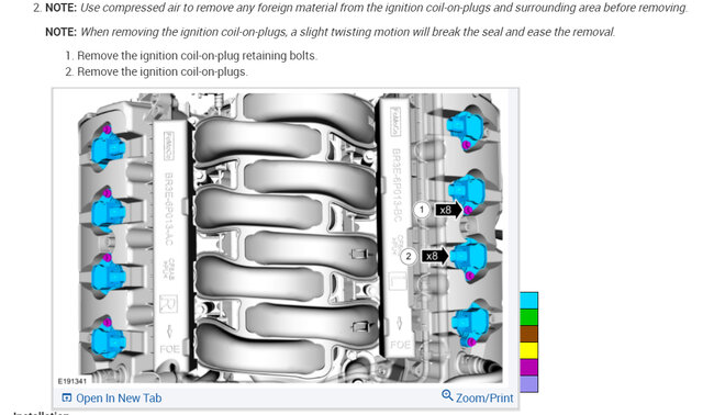

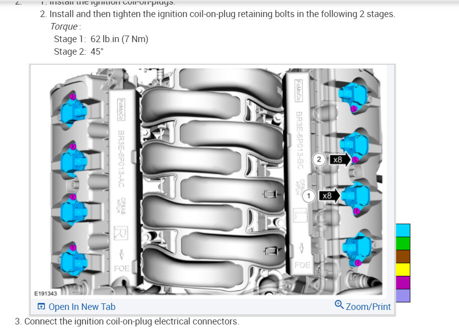

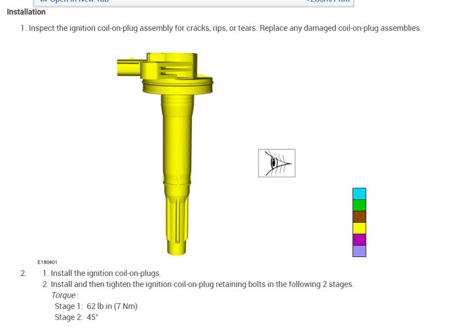

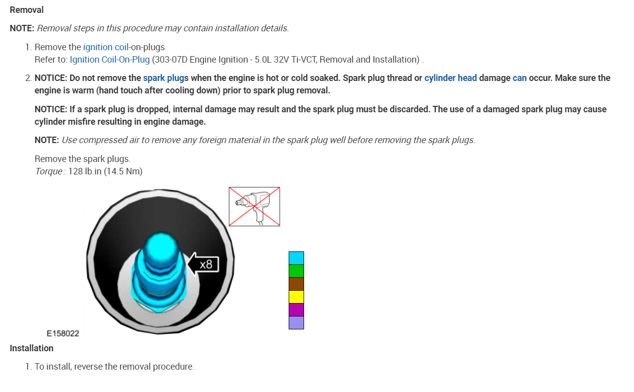

It is common for the ignition coil/spark plug to fail and they need to be replaced on the number 1 cylinder. Here are the instructions in the images below to show you how, once completed, clear the codes to recheck. I would consider doing the remainder of the spark plugs and coils as well. Please let me know what happens.
