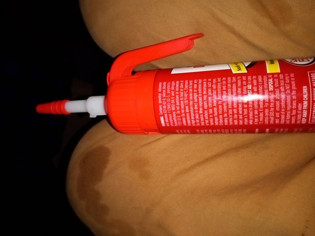

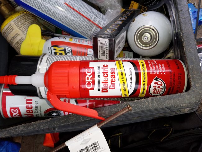

Would FreezeOff being cold cause any problems when sprayed onto warm spark plug? Also, I was going to use CRC Dielectric Grease. See image.
No silver in it but it looks good.
What do you think?

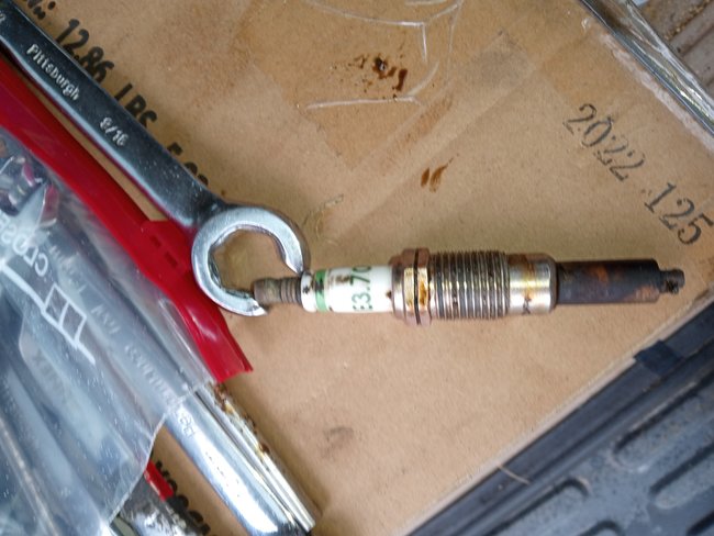

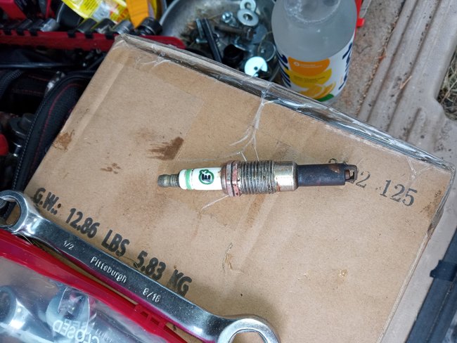

So, the plug I pulled out was E3 brand.
See images
Does this mean I don't need to worry about
breaking off top of plug?
Or are these E3 plugs 2 piece also?
They have about 100,000 miles on them.
Thanks!
Oct 1, 2022 at 5:31 AM
  • 110,244 POSTS
As far as the plug, regardless of what is there, take your time and act as if it can break off. Also, the freeze-off would have actually worked better if the engine was warm. LOL However, what you used is also good and worked. That is what is important.
The CRC is really an electrical connector grease. It is good to use in the spark plug boot. Is that where you plan to use it? If so, yep, it's fine. I have the same can in my toolbox. LOL

I was wondering why TSB does not recommend antiseize grease on threads of spark plug? I thought that is where you would
normally put antiseize grease?
Oct 3, 2022 at 1:19 AM
  • 110,244 POSTS
It is really based on the spark plug design. If you have plugs that are shiny steel, they are designed to do the same as anti-seize. If the threaded portion is black carbon steel, then you can use it. However, only use a very small amount.
Also, keep in mind that the CRC dielectric grease won't hold up to the temps it will see. If you use anything use anti-seize.
