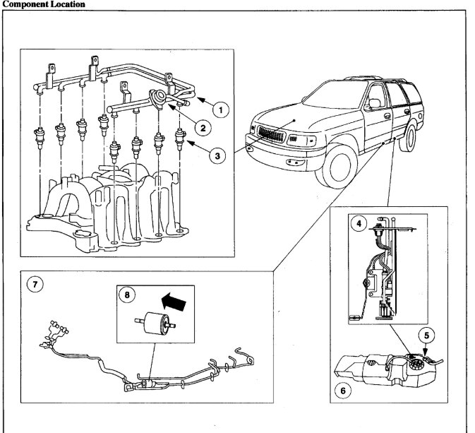

self diagnosed misfire, it's not throwing any codes, nor does it have CHL. decreased RPM while idling and sometimes decreased RPM while accelerating. I replaced the fuel filter and used fuel injector cleaner as well as seafoam, but issues stay the same. Also, sometimes i notice a Sulphur smell when exiting the vehicle after driving.

I agree with MECHTRIX, I would use a rubber mallet and tap the exhaust system to see if you can hear any loose parts inside, this will tell you the cat has come apart. Also, if you use a scanner you can tell me the short and long trims it will help. It could have a weak fuel pump as well. Here is a guide to help test the fuel pressure, you can rent a fuel pressure test kit from the auto parts store for free in most cases. Please check the instructions in the images below.
Fuel Pressure .................... 30-45 psi (207-310 kPa)
Install the gauge in place of the fuel filter. Please go over this guide and get back to us.
Check out the images (below).
