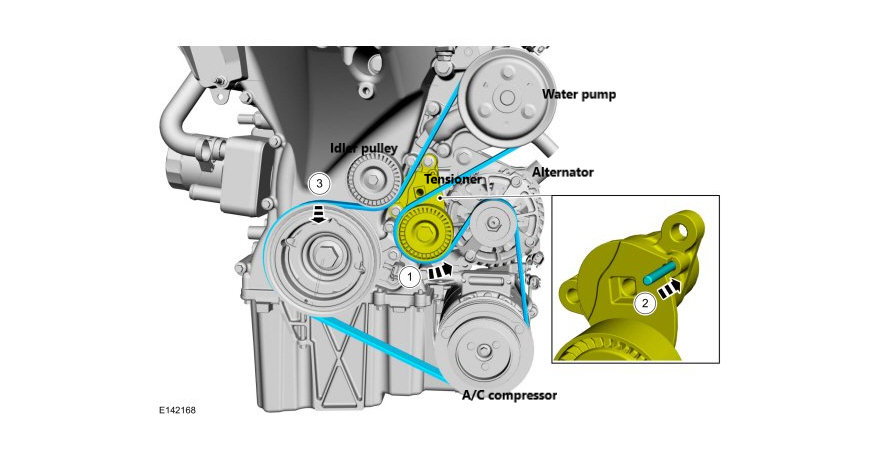

There are literally dozens of possibilities for this scenario, but I would start with the basics like checking the oil level and coolant levels, and have a look under the vehicle for any leaks or foreign objects. The message "engine failure" will come on any time there is a loss of engine revolutions while the power-train control module is commanding normal operation. Also have a look at the accessory belt on the front of the engine, the low torque of this engine can be susceptible to an accessory or pulley locking up and causing the engine to stall. I've attached an illustrated picture of the accessory drive system in case you have an issue with this.
