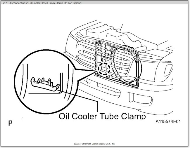

Disconnect the 2 oil cooler hoses from the clamp on the fan shroud.
Fig 1: Disconnecting 2 Oil Cooler Hoses From Clamp On Fan Shroud

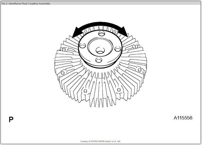

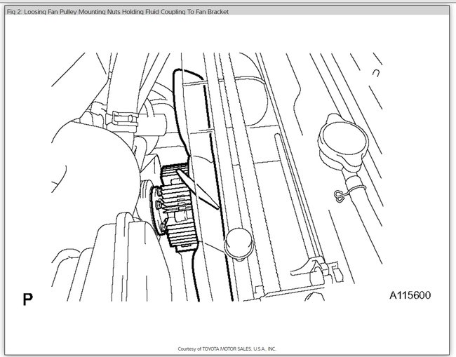

Loosen the 4 fan pulley mounting nuts holding the fluid coupling to the fan bracket.
Remove the drive belt (See REMOVAL ).
Fig 2: Loosing Fan Pulley Mounting Nuts Holding Fluid Coupling To Fan Bracket

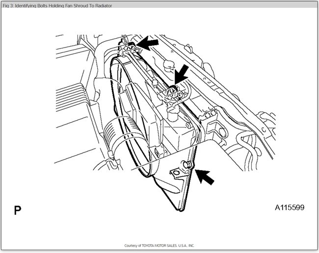

Remove the 3 bolts holding the fan shroud to the radiator.
Fig 3: Identifying Bolts Holding Fan Shroud To Radiator

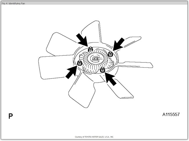

Remove the 4 fan pulley mounting nuts.
Pull out the fan with fluid coupling, fan pulley and fan shroud.
NOTE: Be careful not to damage the radiator core.
REMOVE FAN
Remove the 4 nuts and fan from the fluid coupling.
