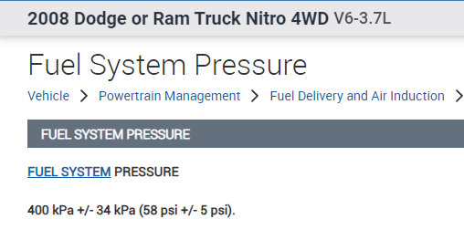

If there are no trouble codes, the first things I suspect are either low fuel pressure or the crankshaft position sensor (CKP). The CKP can fail and not produce a trouble code. Also, if the engine is running out of fuel, it won't set a code.
Does your scan tool read live data? If it does, let me know. Also, take a look through this link and let me know if it seems to mirror what you experienced:
Also, here is a link that explains in general how to check fuel pressure. You will need a fuel pressure gauge, but most parts stores will lend one to you.
If you look below, I attached the manufacturer's fuel pressure specifications.
See pic below.
