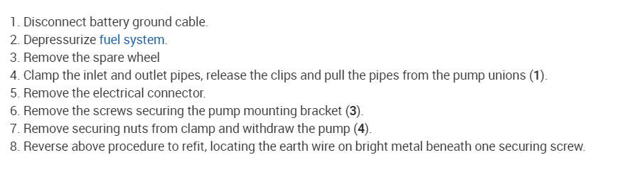

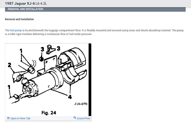

That fact that one tank effects the problem more than the other tank tells us the fuel pump is starting to go out or you have a clogged fuel filter if the filter is new, we can check the fuel pressure to confirm this guide will help with instructions in the images below to show you how to change the pump out.
The Fuel Filter is located in the right, front corner of the luggage compartment next to the spare tire.
1. Depressurize fuel system.
2. Loosen clip securing cold start injector supply line to fuel rail and remove fuel supply line from rail.
3. Install a suitable pressure gauge onto fuel rail and tighten clip.
CAUTION: The pressure gauge must be checked against an approved standard at regular intervals.
4. Disconnect "-ve" low tension lead from ignition coil, and switch on ignition.
5. Check pressure gauge reading, reading must be 36.25 psi (allow a +/- difference of 0.725 PSI).
NOTE: When the fuel pump stops running, the pressure reading may drop slowly through either the regulator valve seating or the pump non-return valve. A slow, steady drop is permissible; however, a rapid fall must be investigated.
6. Operate fuel change-over switch on center instrument panel and recheck the pressure gauge reading.
Note: If satisfactory results have been obtained, depressurize the fuel system. Disconnect the pressure gauge. If satisfactory results have not been obtained, replace the regulator with a new unit.
