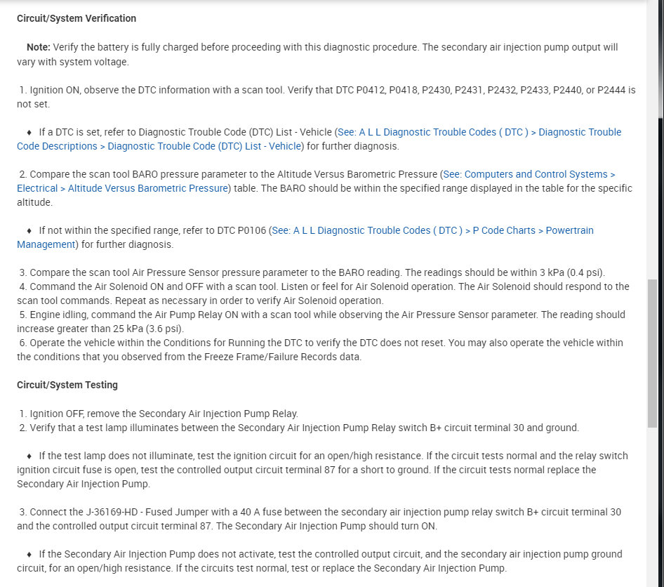

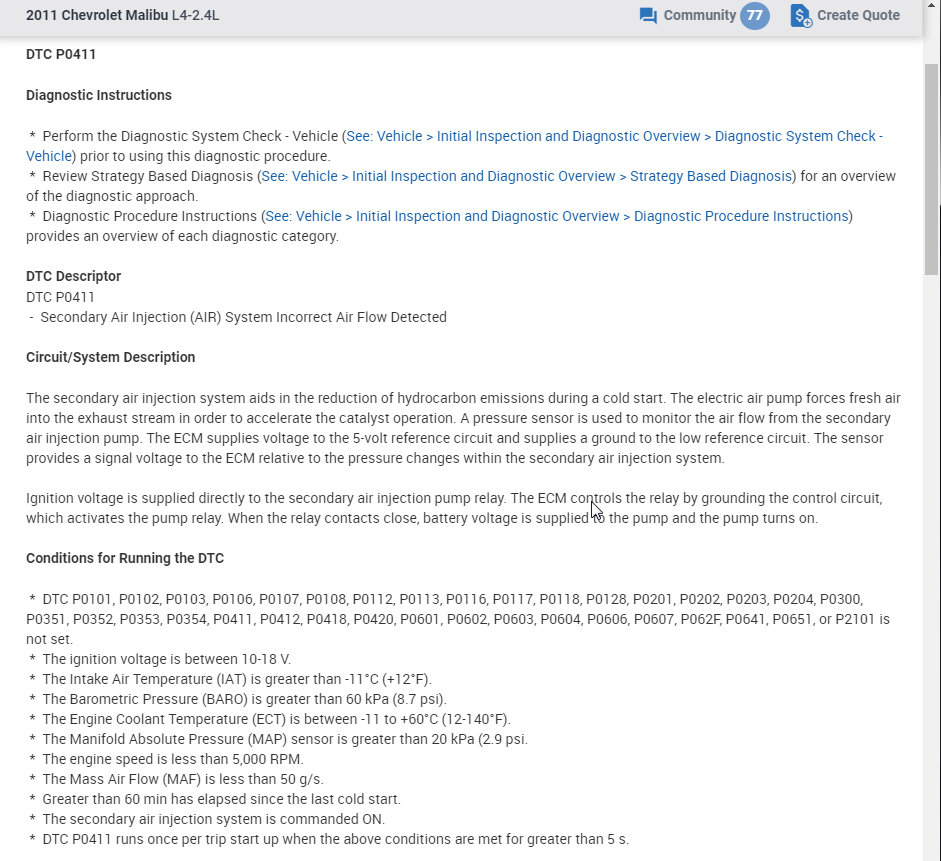

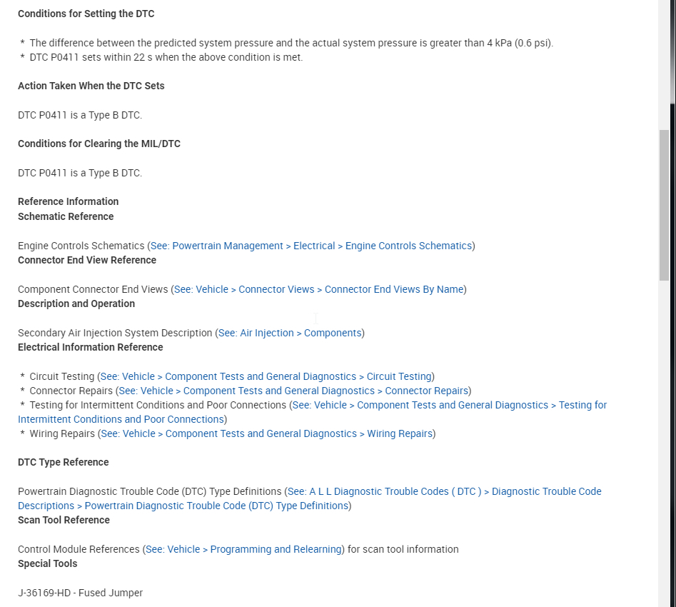

Can seem to get rid of my engine lights it showed me a code P0411 so I thought that pump I had it put on but light is still on
Feb 23, 2020 at 1:29 AM

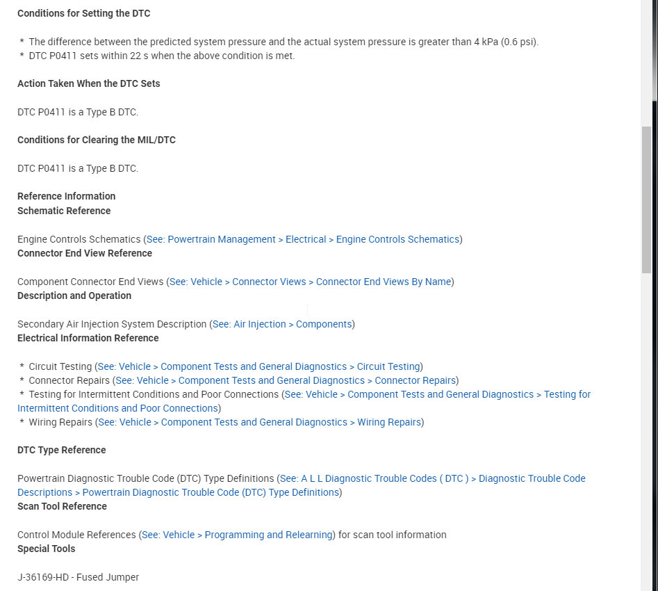

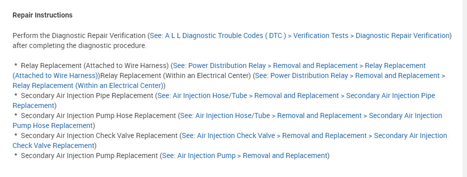

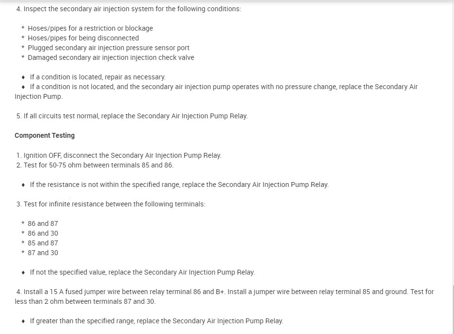

This code can be pesky so I understand. I attached the test. Unfortunately the only way to know is to run through this and see what the outcome is based on testing.
Let me know if you have questions but as I said, there is not "easy button" answer for this one. Thanks
