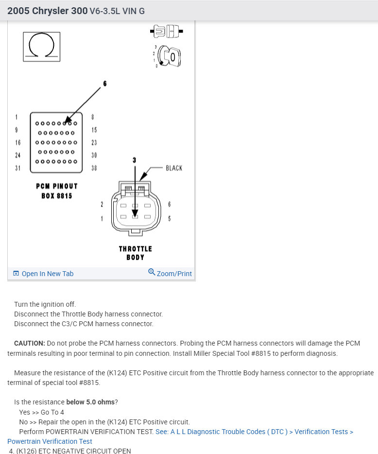

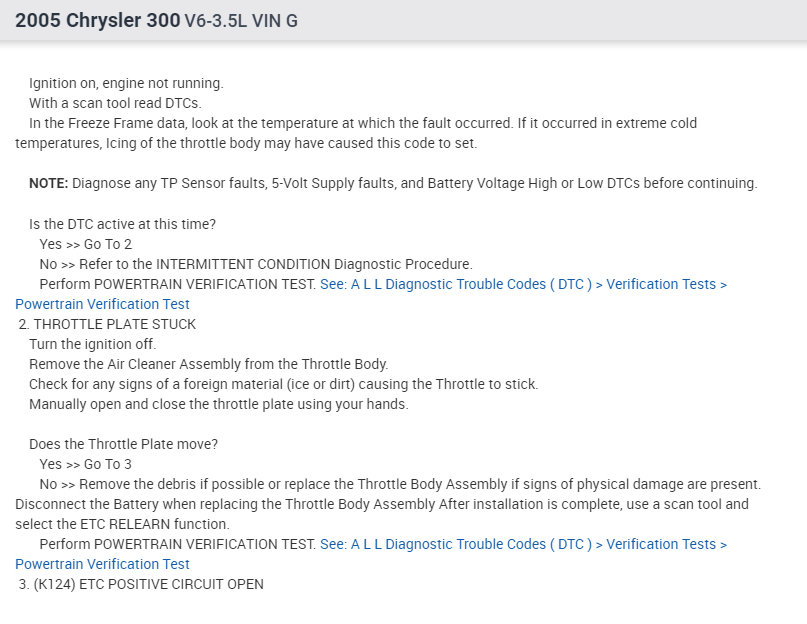

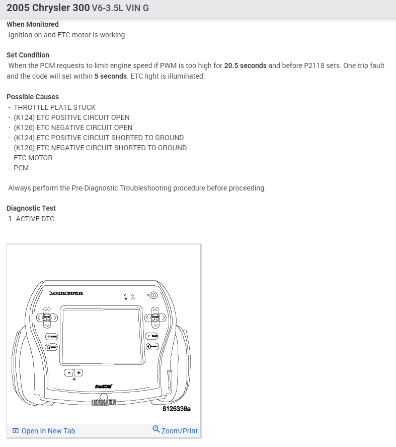

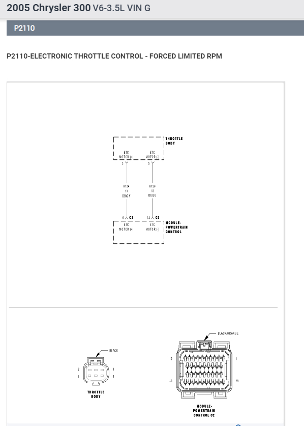

Hi, I am having a problem with my car. I originally had an issue where I would start it and it would run fine for about 30 seconds and then it would go into a limp mode with the lightning bolt, and it would idle high and just sound funny. I threw in a new throttle body hoping that it would fix it, did the whole relearn process and there was no difference. Not sure if it could be the ECM or something else. It would throw codes 2110, 2118 and 2101
Hope to hear soon.
Mar 18, 2022 at 6:14 AM
SQM
  • 6,383 POSTS

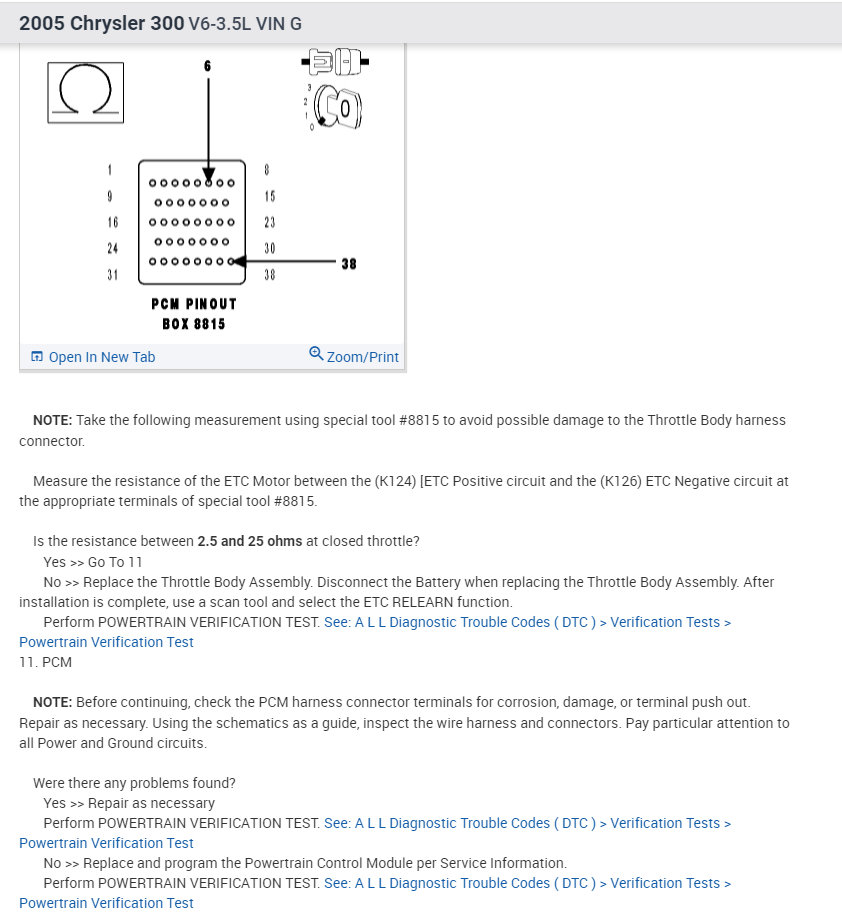

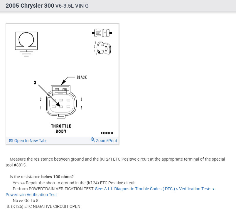

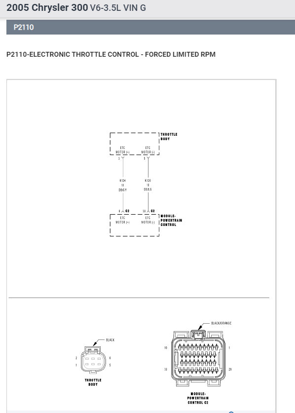

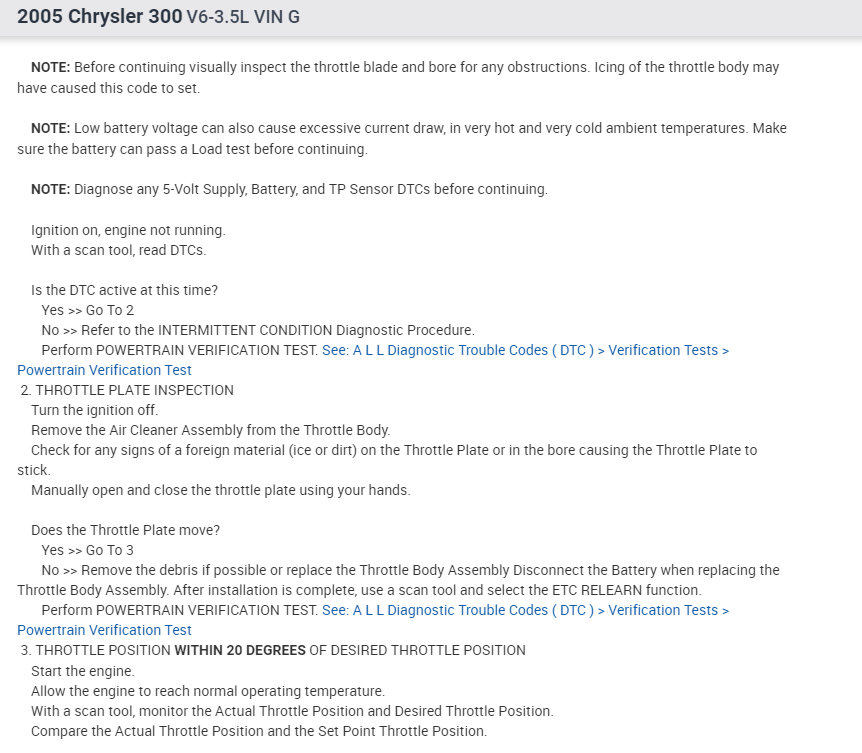

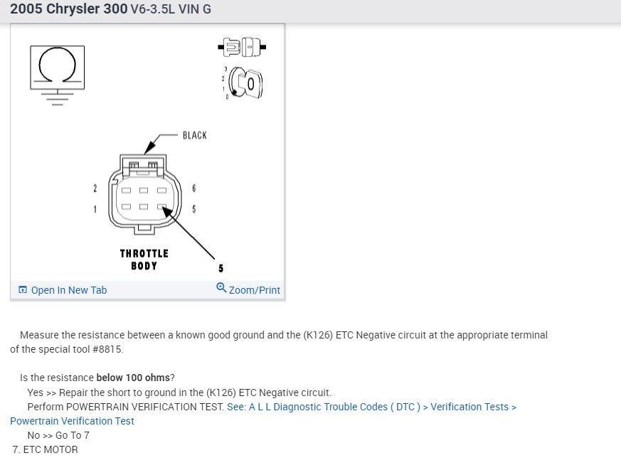

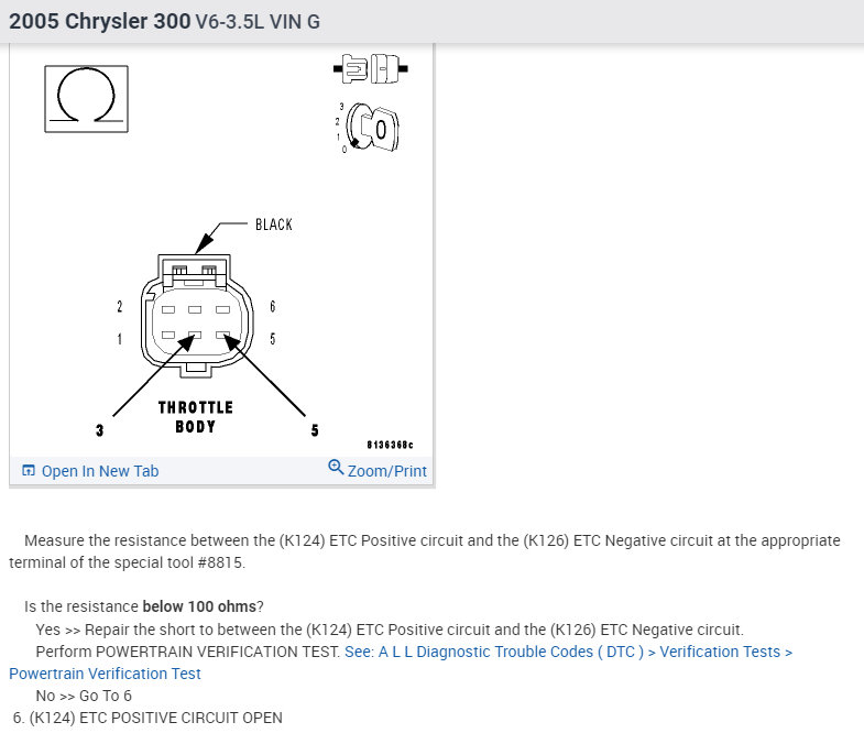

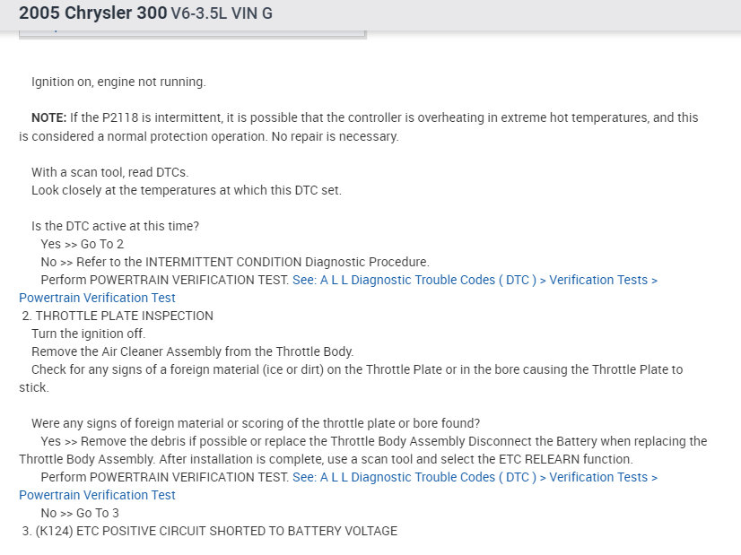

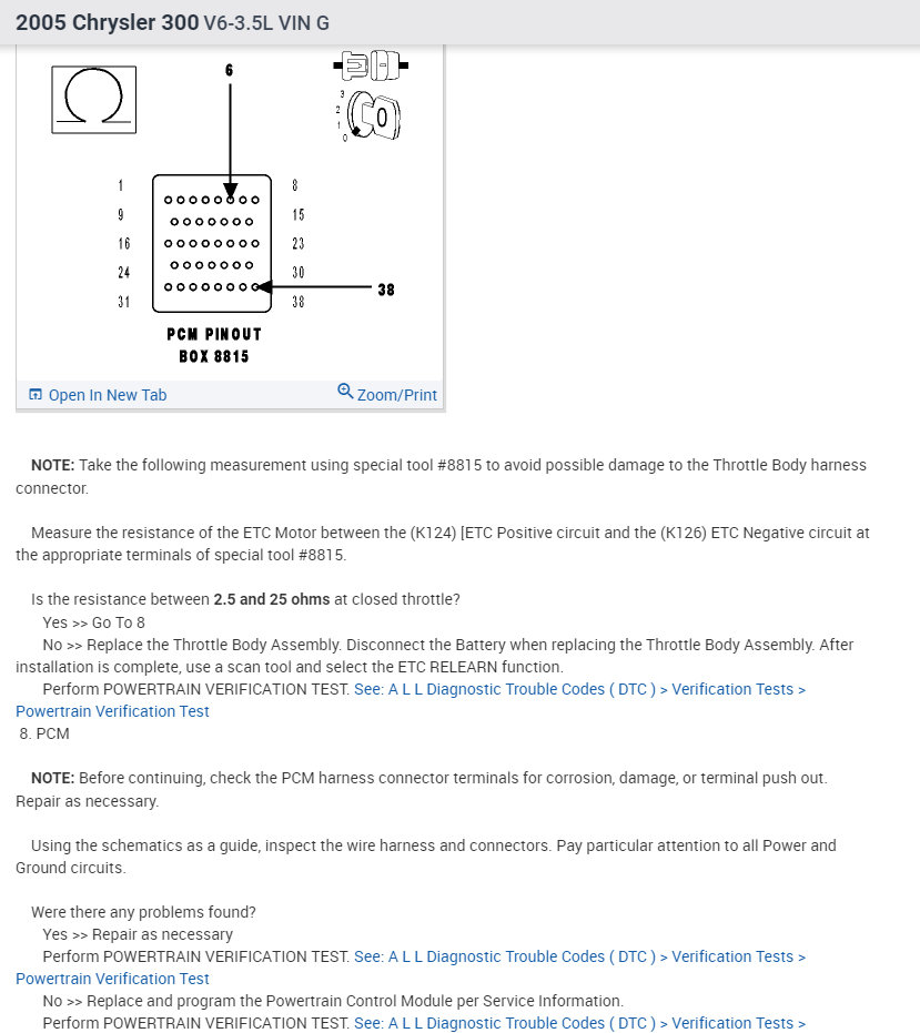

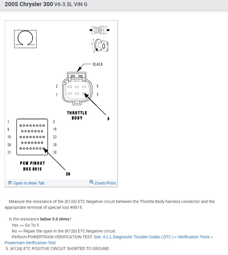

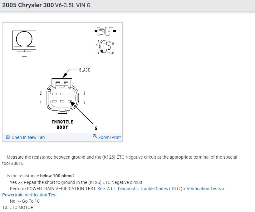

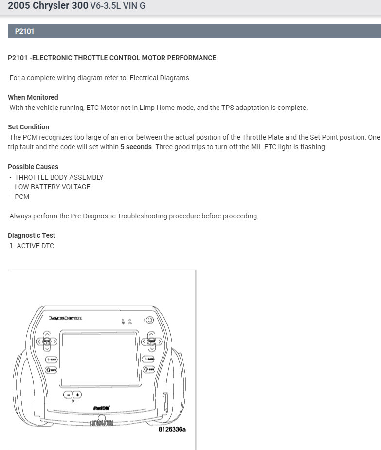

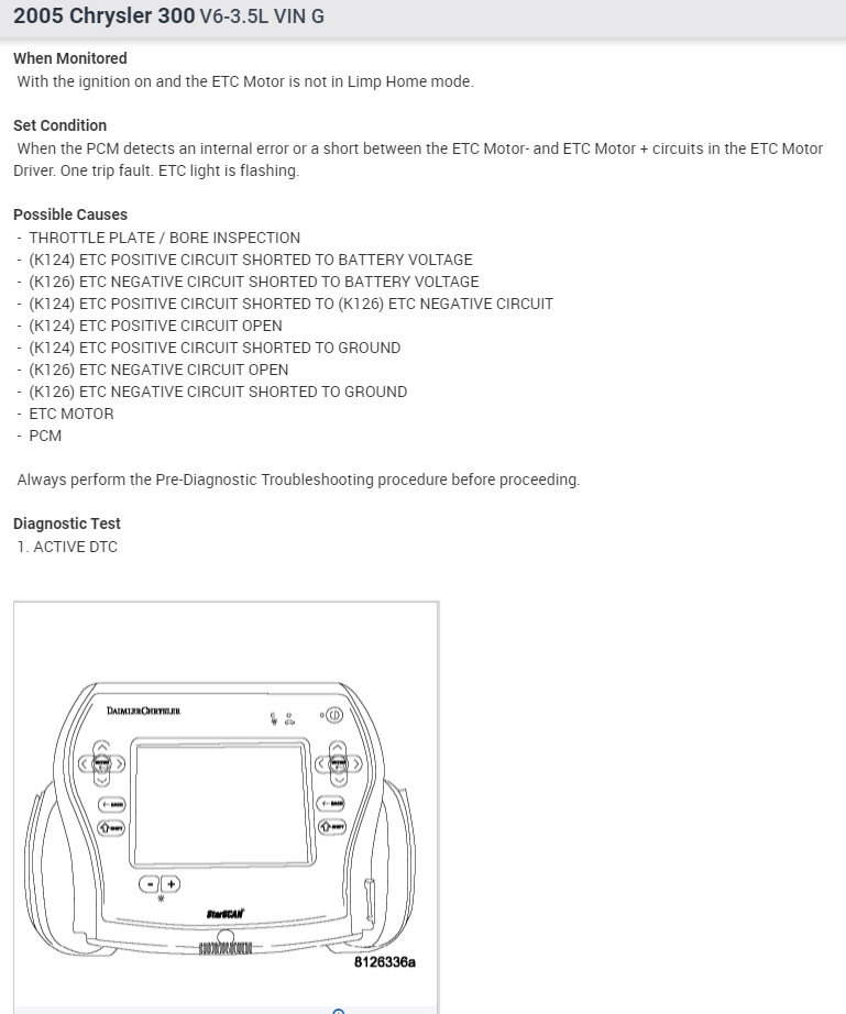

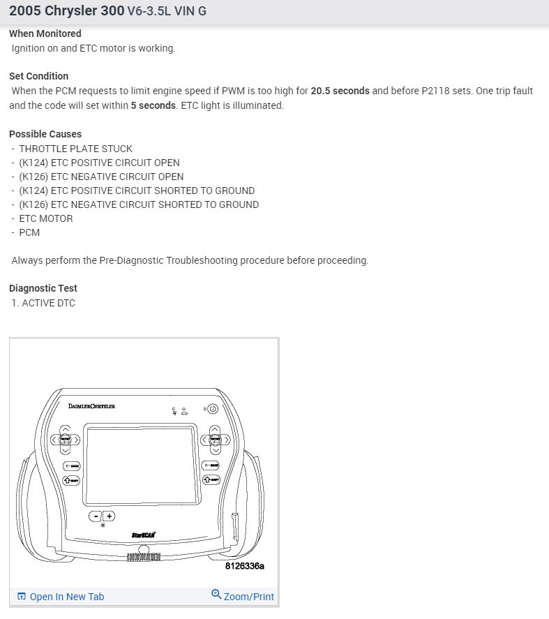

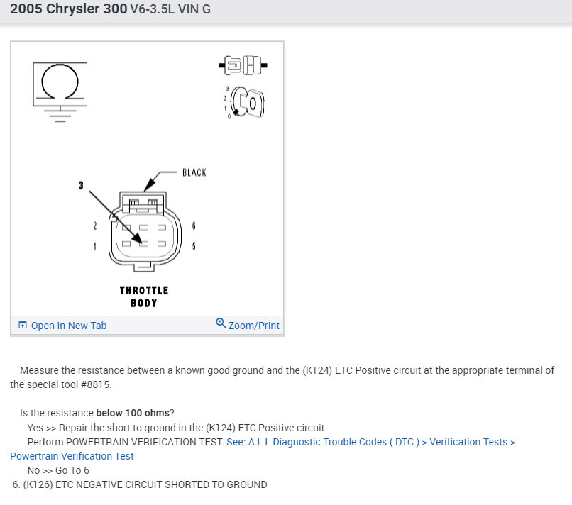

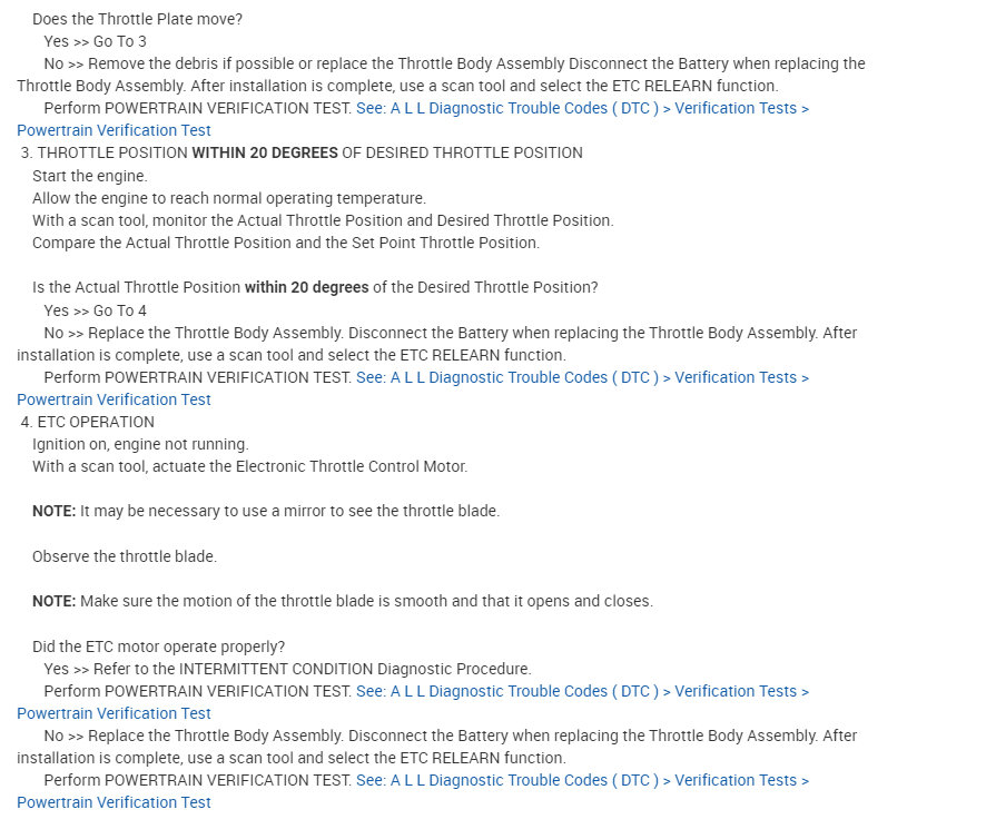

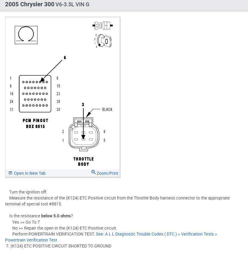

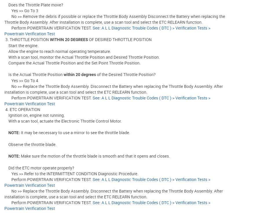

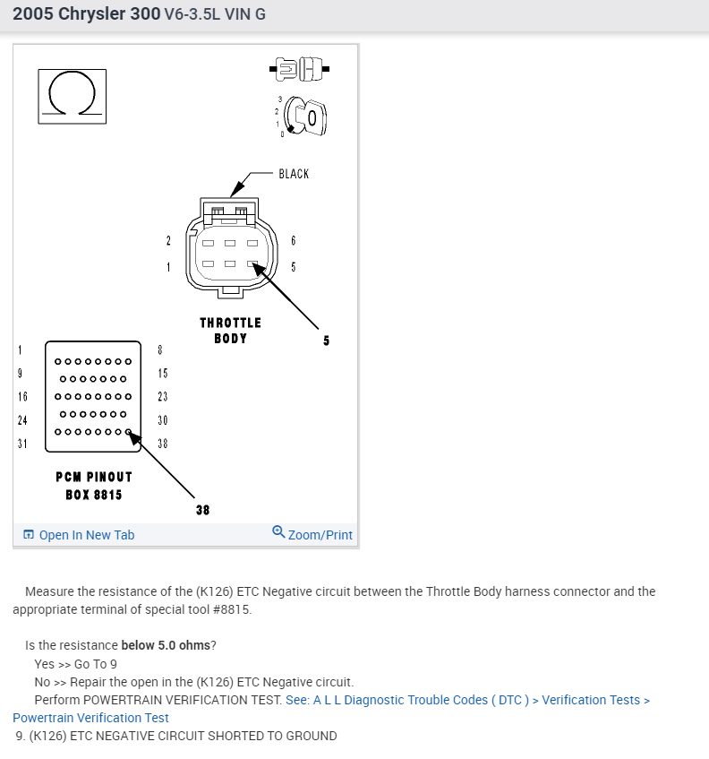

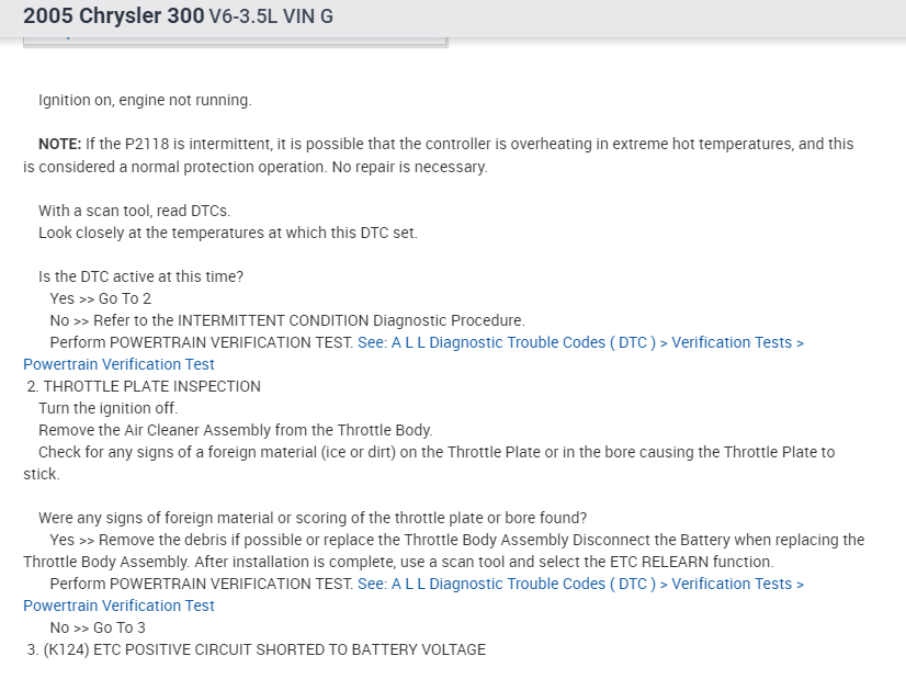

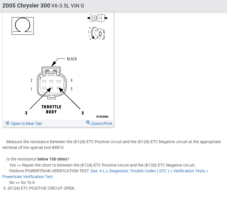

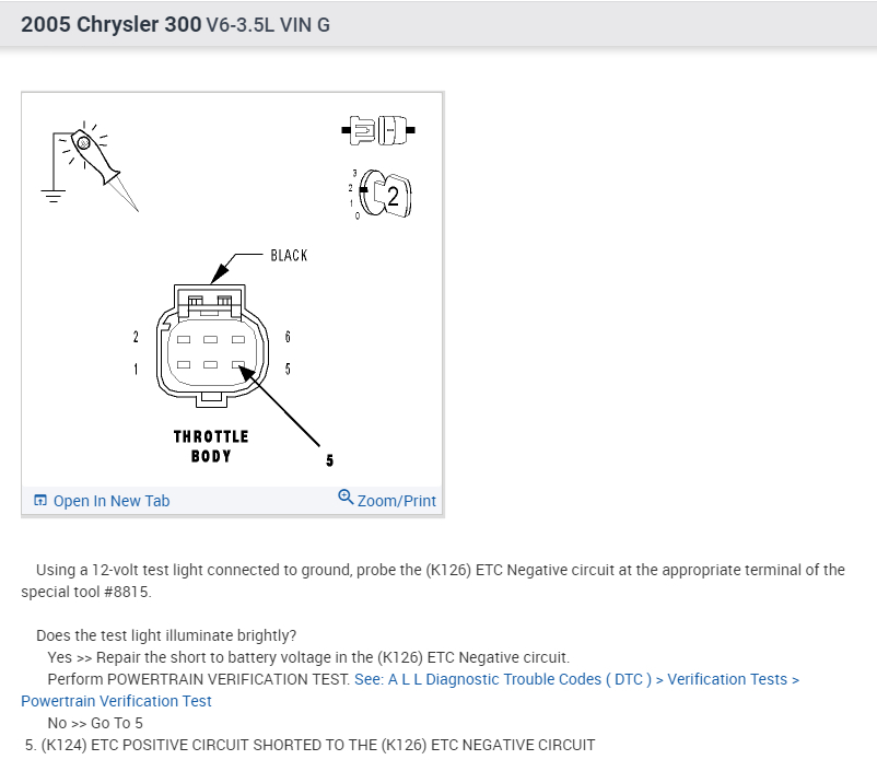

Did you clear the codes after replacing the actuator?

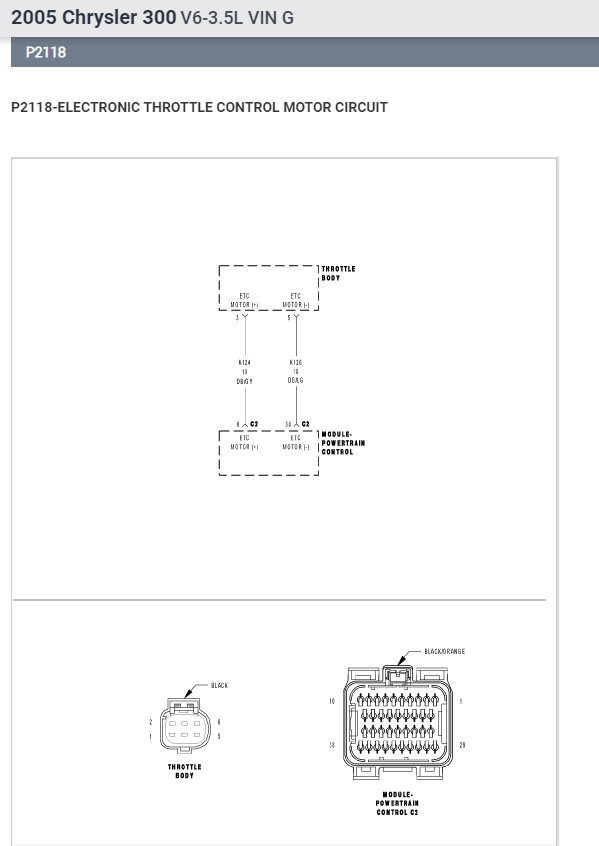

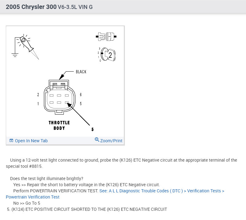

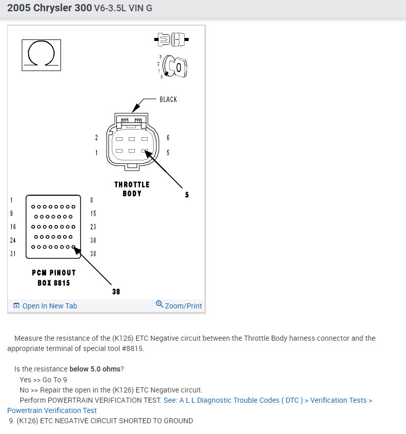

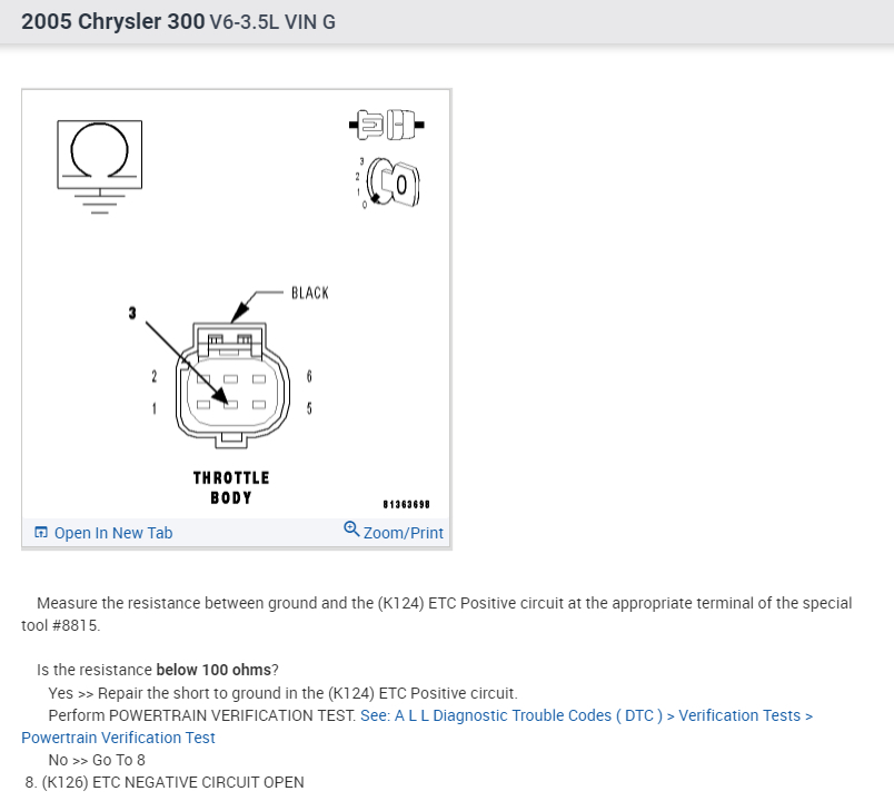

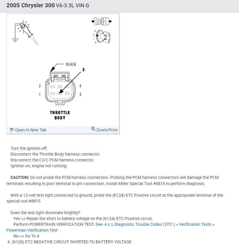

All those codes are related to the throttle actuator or the wiring for the actuator.
This could also be due to an issue with the PCM.
I have attached the detailed trouble shooting guide for P2110, P2118 and P2101 codes below.
Following those steps can help you determine the issue.
