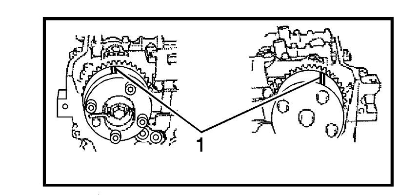

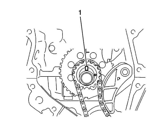

From the looks of the compression, you may have a timing issue between the cam and the crank.
https://www.2carpros.com/articles/the-reasons-for-low-compression

I think you need a timing chain
