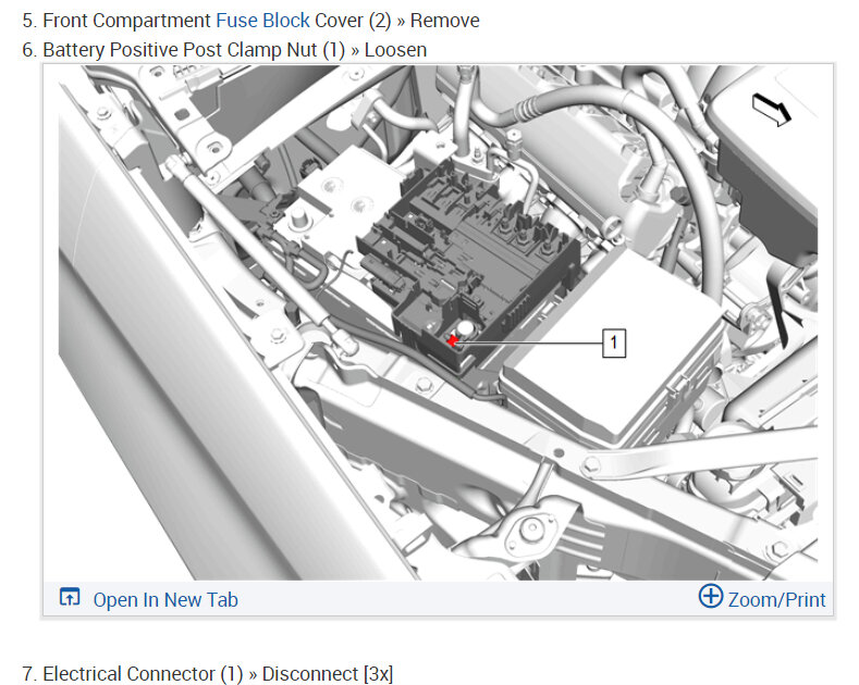

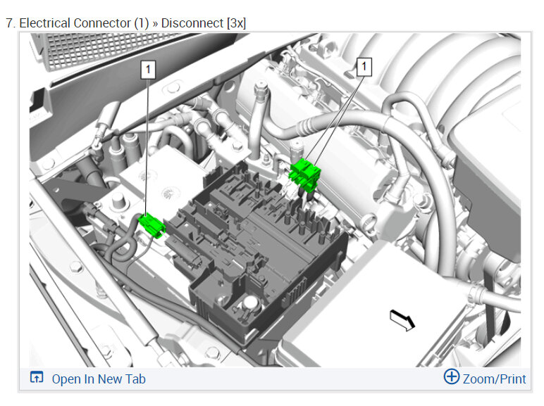

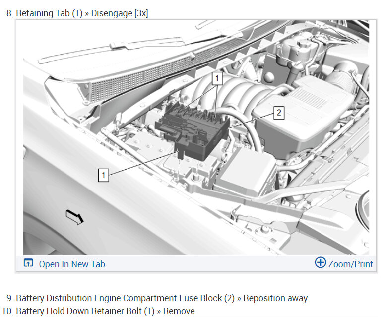

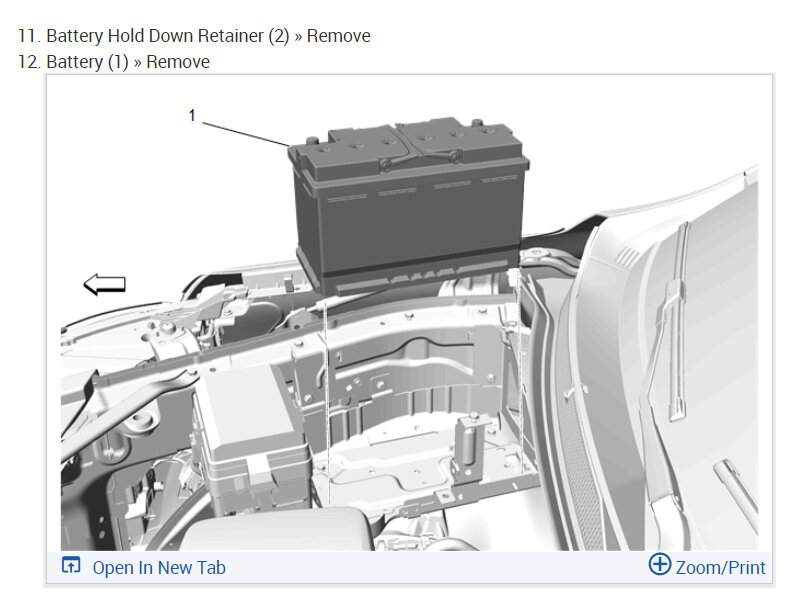

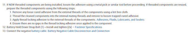

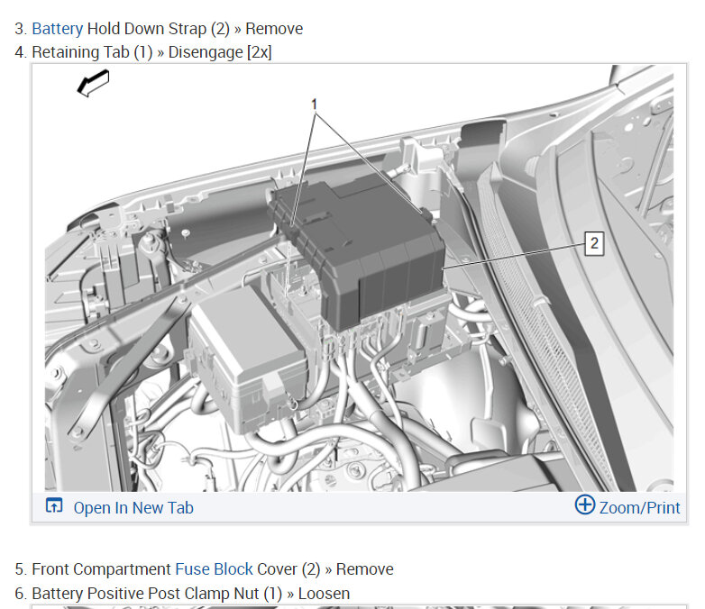

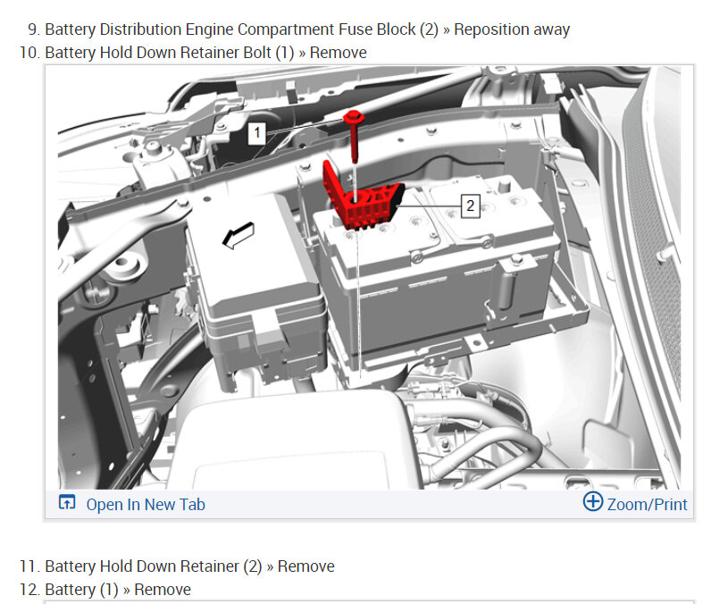

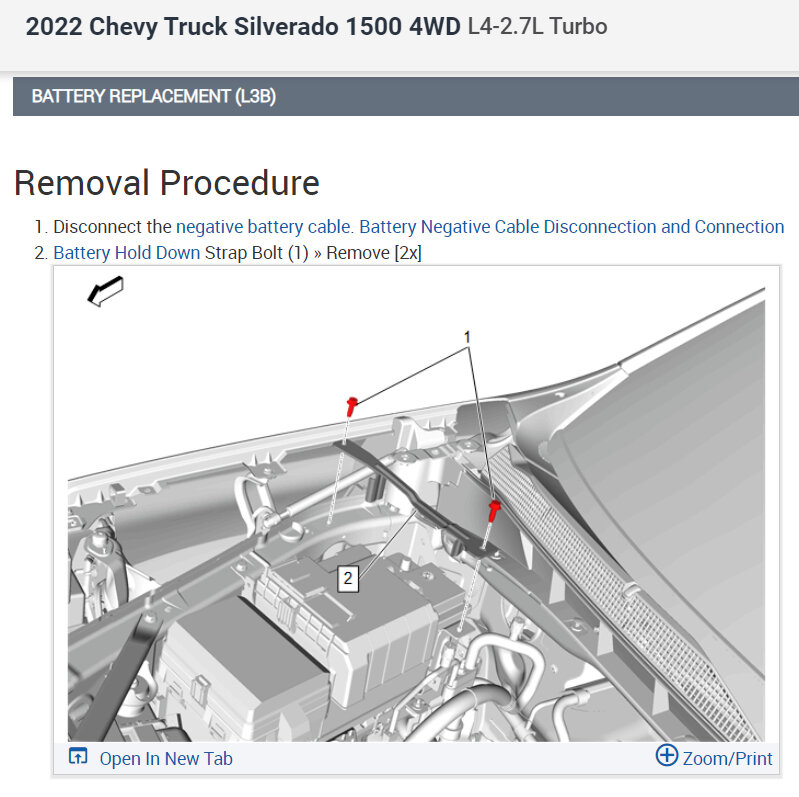

The reason I ask is it doesn't take that long to do the update the battery should have been okay. I would install a new battery to be safe. Here is how, check out the images (below). Let us know if you need anything else.
