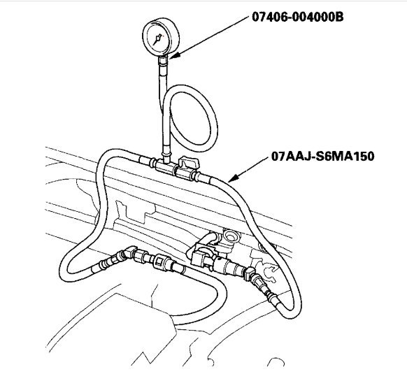

What I would start with is to simply try using a quality fuel injection cleaner. See if that changes things. If it doesn't, the next step would be to check fuel pressure and pressure drop-off. If there is a stuck injector, pressure will drop faster than it should once the pump is off.
Here is a link that shows how that is done:

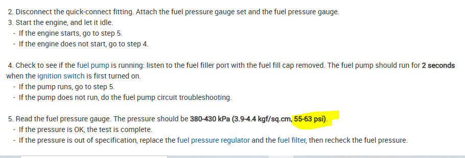

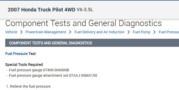

If you look below, I attached the manufacturer's procedures because they are a little different than the link. The fuel pressure specifications are included in the directions.

See pics below. Note: Most parts stores will lend you the fuel pressure gauge for testing.
