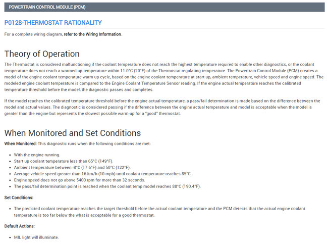

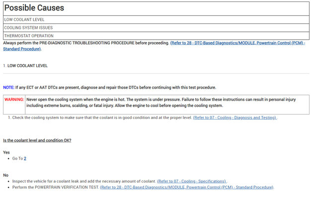

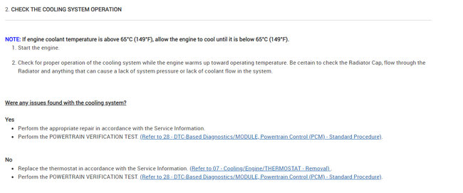

Here are some pretty interesting service info on how the engine computer (PCM) keeps track of the thermostat operation. If this is the code that set, and it came back after they replaced the thermostat, they might be confused on its operation. In this case even an Ambient Temperature sensor that's out of range could cause the code to come back because certain conditions are not met.

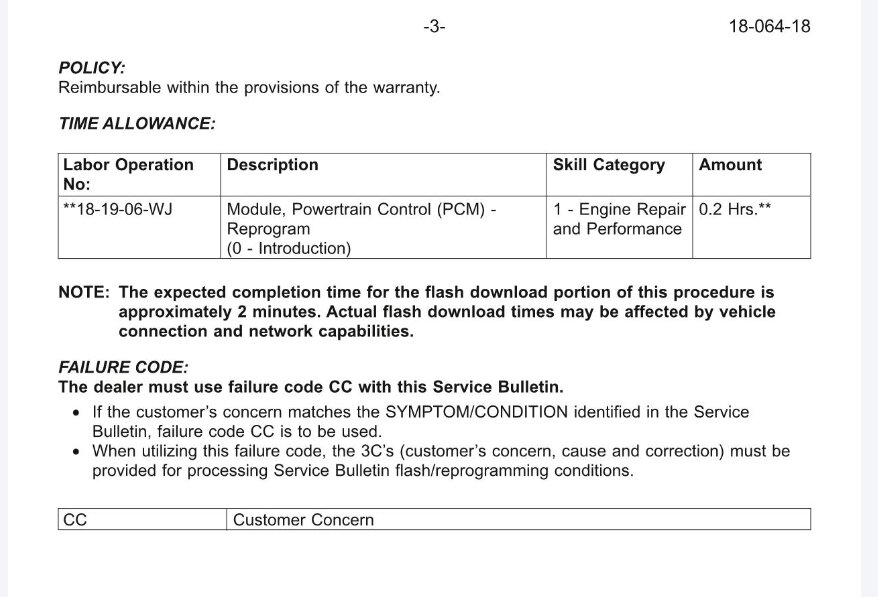

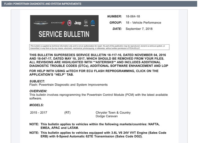

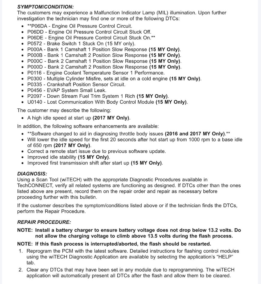

There is also a Technical Service Bulletin on a software update for the PCM due to some certain codes setting, as well as some idle issues and also aid in diagnosing throttle body issues. PCM software updates are pretty normal, every vehicle will have software updates that are programmed if a module is replaced, or if you happen to have the vehicle at a dealership. If you're within your warranty still, I would consider getting the PCM updated. There might be codes setting that are not actual faults. (diagrams 4-6 below)
