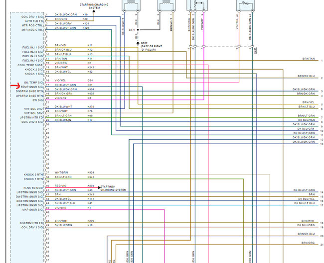

engine light on the time code P0073? I replaced sensor.
Mar 29, 2025 at 12:58 AM
  • 55,616 POSTS

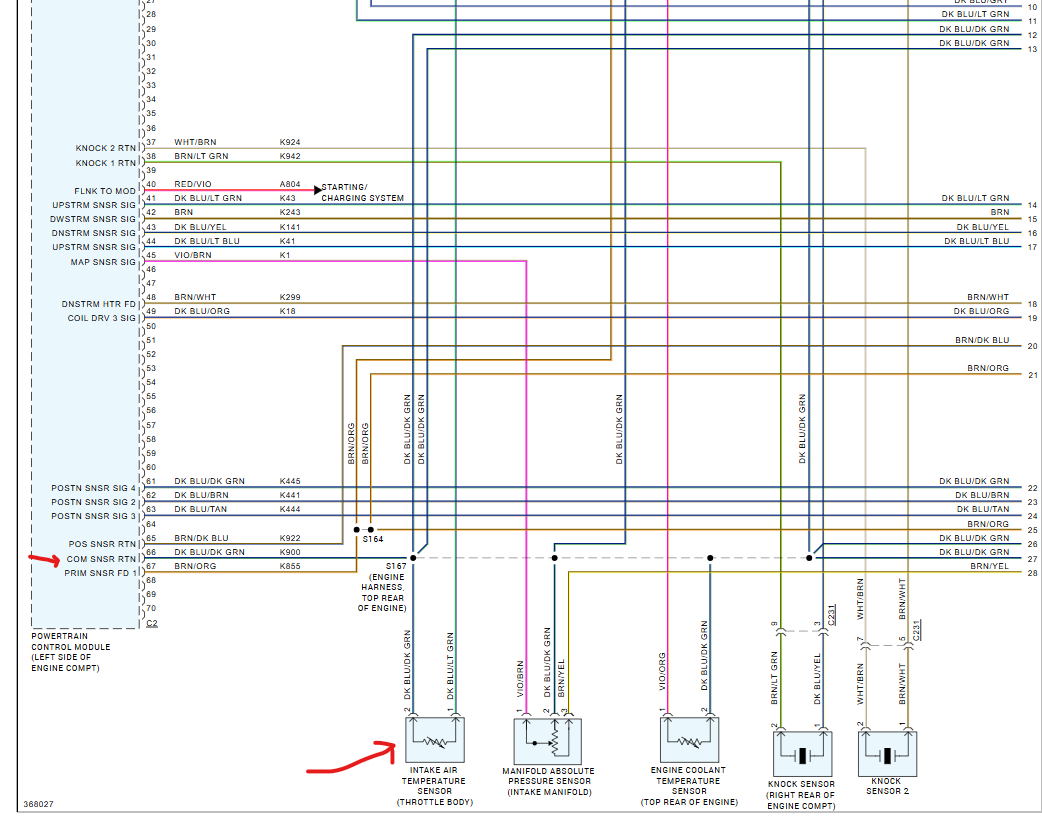

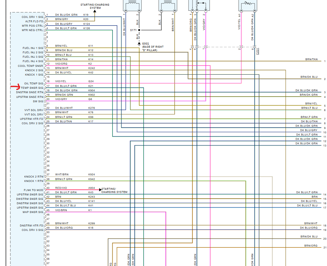

So if you replaced the ATS sensor then I would check the wiring. Here is a guide to help and the wires you should be checking in the images below.
P0073 – Ambient Air Temperature Sensor Circuit High
You must have a broken wire or bad connection, check out the images (below). Let us know what you find.
