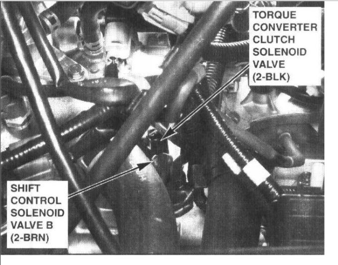

Engine light on code indicated an issue with the tc clutch, a P1740

What is the cost to fix this issue. Had transmission done at 150,000 miles in 2011. Car well maintained if repaired what is the likely hood of it lasting at least 3-5 years.

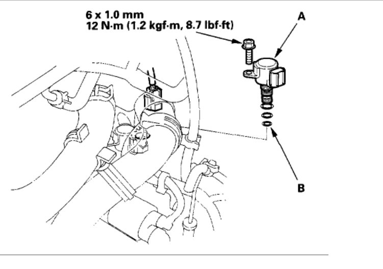

It could be just the TC solenoid that is out which would cost about $70.00 for the part and you can install it yourself.
Here are diagrams below to help you
