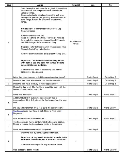

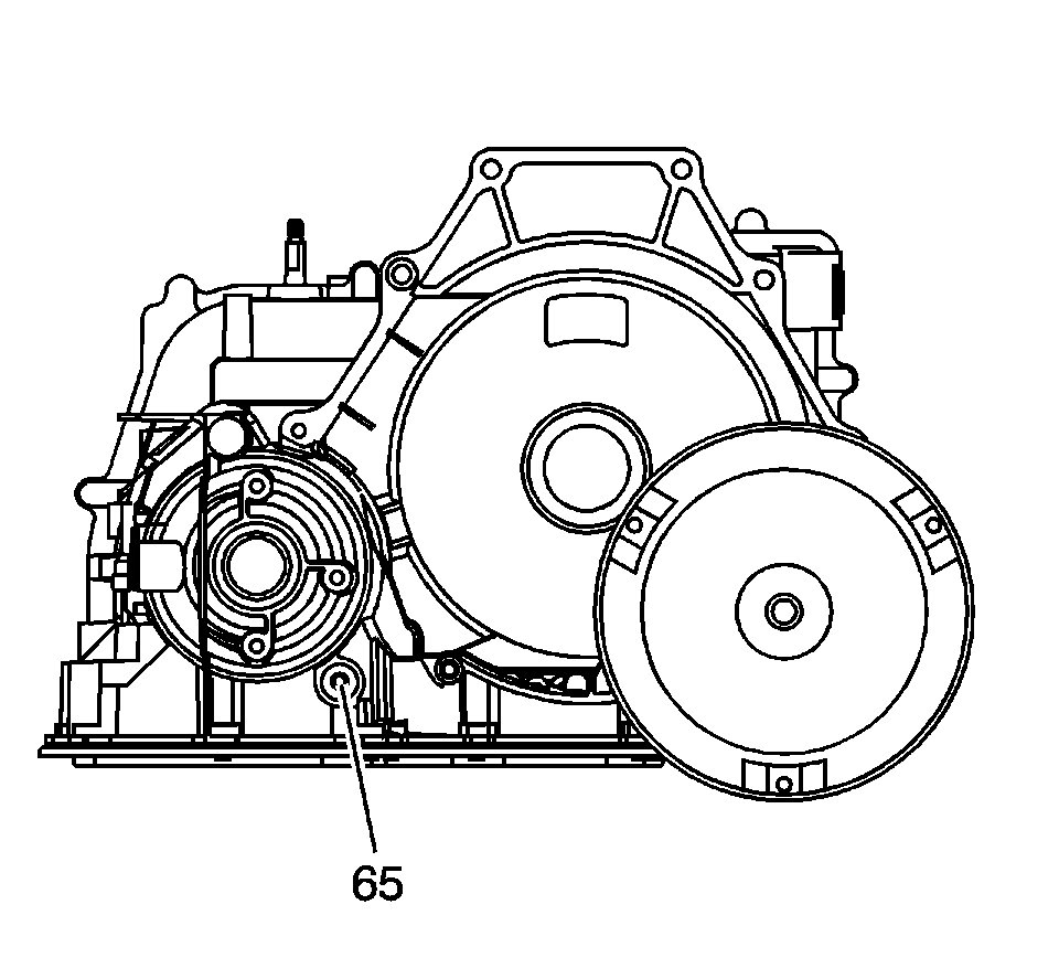

There are two different transmissions that were used. I will provide the directions for checking the level for both. Note, one does have a dipstick, but it isn't easy to see.
__________________________________
No dipstick: Note these directions continue by telling how to check for leaks and condition. The first section contains the directions.
2007 Saturn Truck VUE FWD L4-2.4L Hybrid
Transmission Fluid Checking Procedure
Vehicle Maintenance Fluids Fluid - A/T Testing and Inspection Component Tests and General Diagnostics 4T45-E Automatic Transaxle Transmission Fluid Checking Procedure
TRANSMISSION FLUID CHECKING PROCEDURE
see pic 1
The oil level control plug (65) is located on the torque converter side of the transmission.
See Pic 2 for directions.

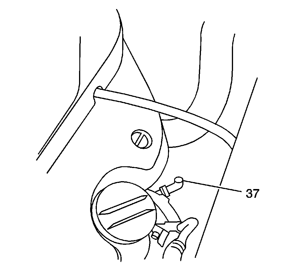

With Dipstick:
Vehicle Maintenance Fluids Fluid - A/T Testing and Inspection Component Tests and General Diagnostics 5AT - Automatic Transaxle Transmission Fluid Checking Procedure
Important:
* Keep all foreign particles out of the transmission.
* Turn the engine OFF when checking fluid level.
Warm the engine to normal operating temperature - until the electric radiator fan turns on at least once.
1. Park the vehicle on a level surface.
2. Depress the brake pedal and move the shift lever through the gear ranges, pausing a few seconds in each gear.
3. Turn OFF the engine.

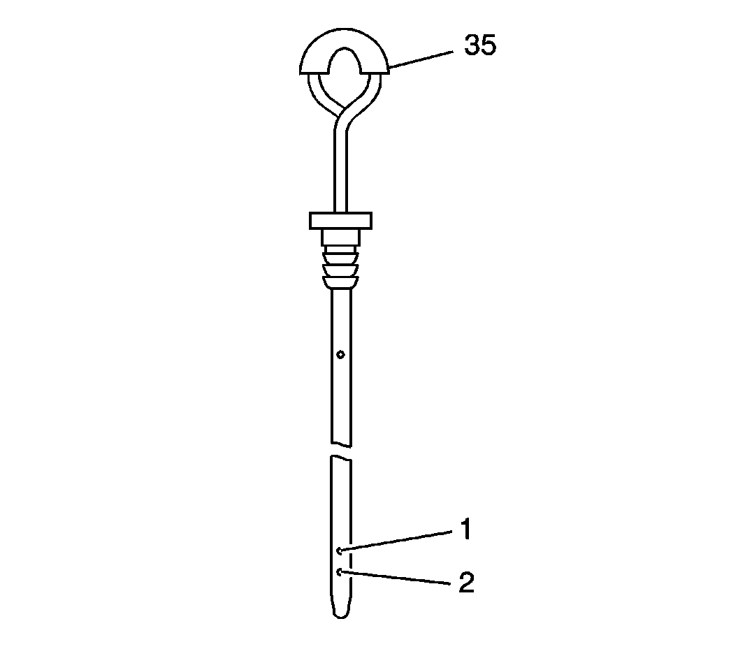

pic 3
4. Remove the fluid level indicator (35) located at the rear of the engine compartment with the black loop, from the automatic transmission fluid (ATF) level indicator tube (37).
5. Wipe the fluid level indicator (35) with a clean cloth.

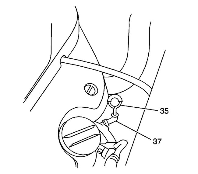

pic 4
6. Insert the fluid level indicator (35) into the fluid level indicator tube (37).
pic 5
7. Remove the fluid level indicator (35) and inspect the fluid level. The fluid level should be between the upper mark (1) and the lower mark (2).
8. If the fluid level is below the lower mark (2), inspect for fluid leaks at the transmission, the hose and line joints, and at the cooler lines. If the fluid level is above the upper mark (1), determine the cause of the overfill condition and correct as needed.

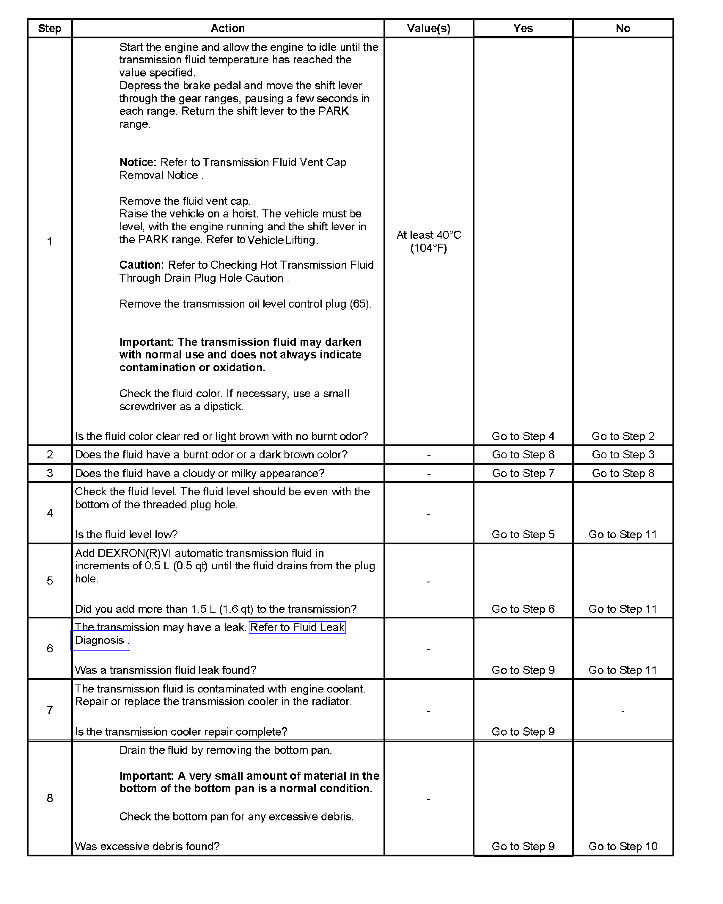

pic 6
Important:
* Always use the specified ATF. If specified ATF is not used, shift quality is affected.
* Only add enough ATF to bring the fluid level to the upper mark on the fluid level indicator (35).
When adding less than 946 ml (1 qt) of ATF, insert a funnel into the fluid level indicator tube (37), and add the correct amount of ATF to bring the level to the upper mark.
9. When adding more than 946 ml (1 qt) of ATF, open the transmission fluid fill plug (79) located on top of the transmission case section (31).
10. Insert the fluid level indicator back into the fluid level indicator tube (37).
