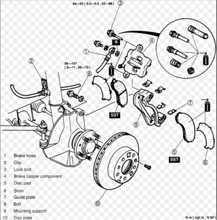

Hard to stop the car while driving. engine light on and vss lights on?

Hello.
Hope the following links and diagrams assist in your repair, not the exact vehicle but very similar.
https://www.youtube.com/watch?v=Gzgh_LVAIDE
Hope this helps with your repair. Please keep us updated on your repair outcome and do not hesitate to contact us again for further information or assistance.
