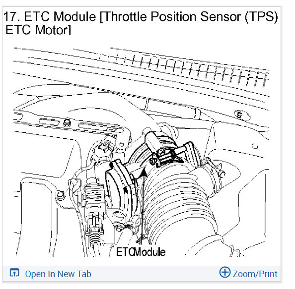

With these codes it looks like you have a throttle body that needs to be replaced, the last code is for engine oil temperature so I would check the oil level and change it with the filter if it has been a while since the last change.
P2138 - Throttle/Pedal Position Sensor/Switch "D"/"E" Voltage Correlation:
P2106 - Throttle Actuator Control System - Forced Limited Power:
P0198 - Engine Oil Temperature Sensor High:

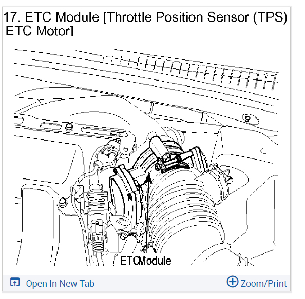

Here is how to change the throttle actuator out and when you are done, please clear the codes. Check out the images (below). Let us know how it goes.

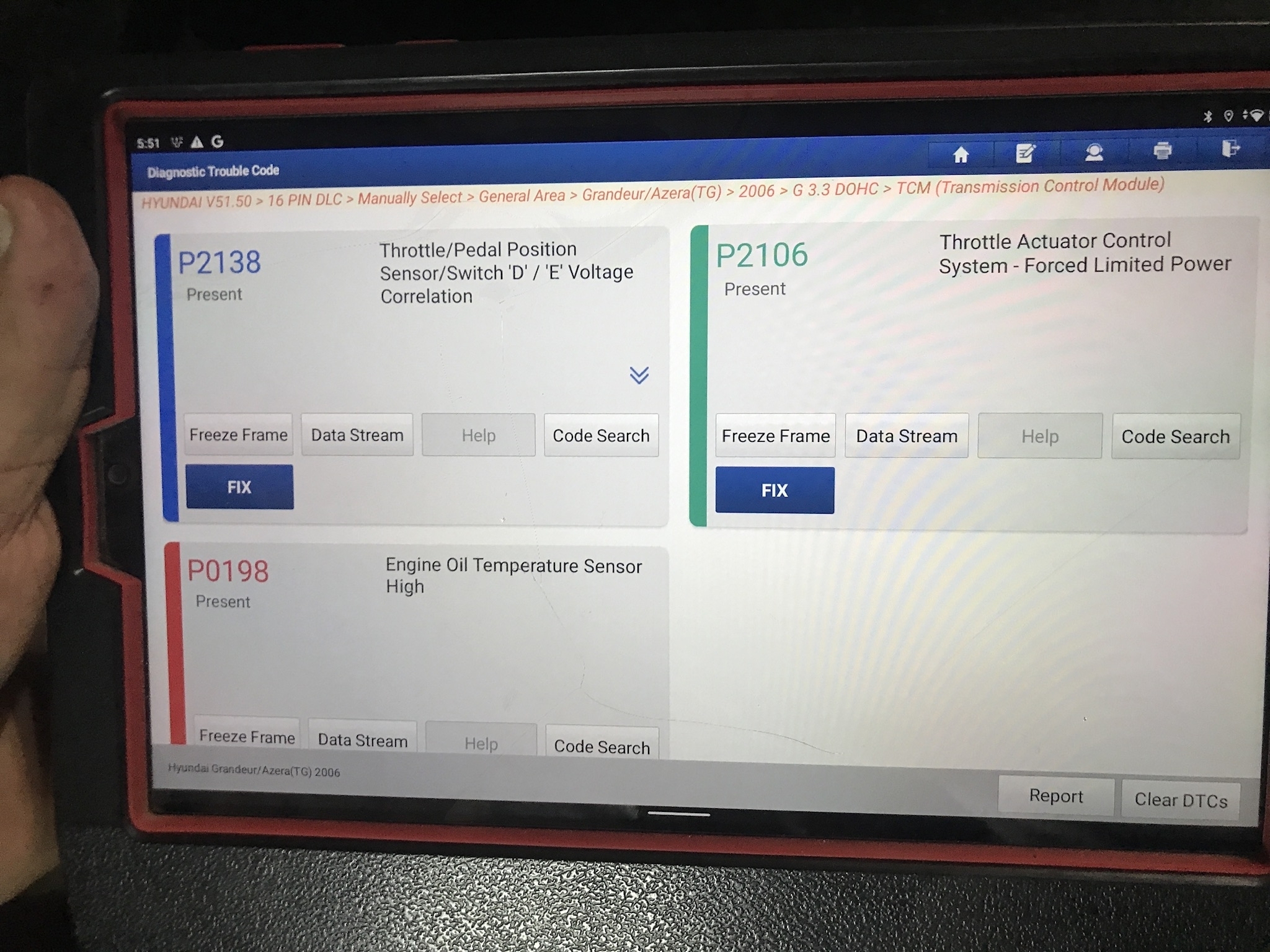

YASSERMO
Here’s the codes.
Apr 24, 2024 at 2:46 AM
  • 55,399 POSTS

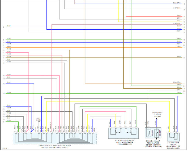

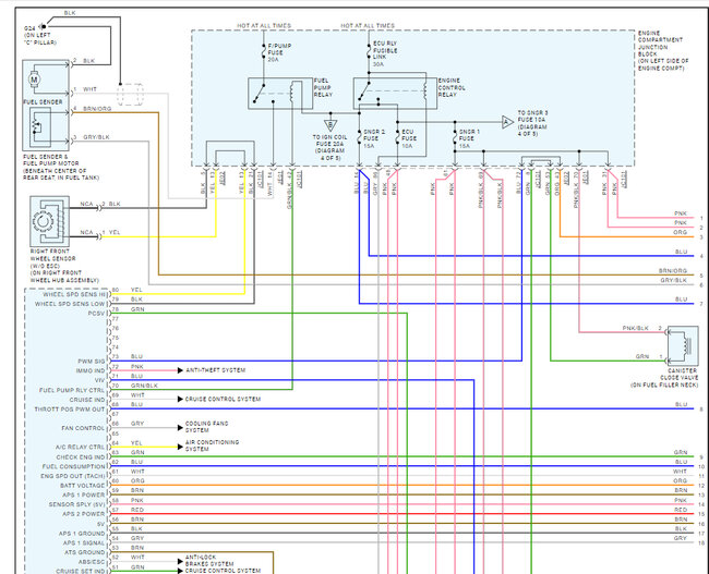

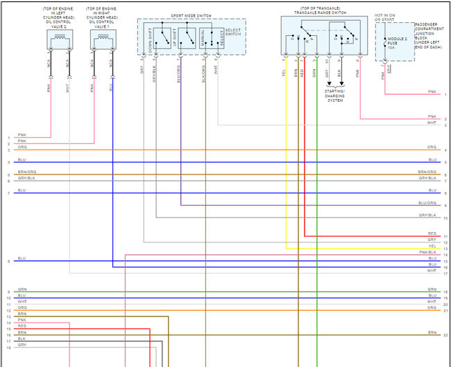

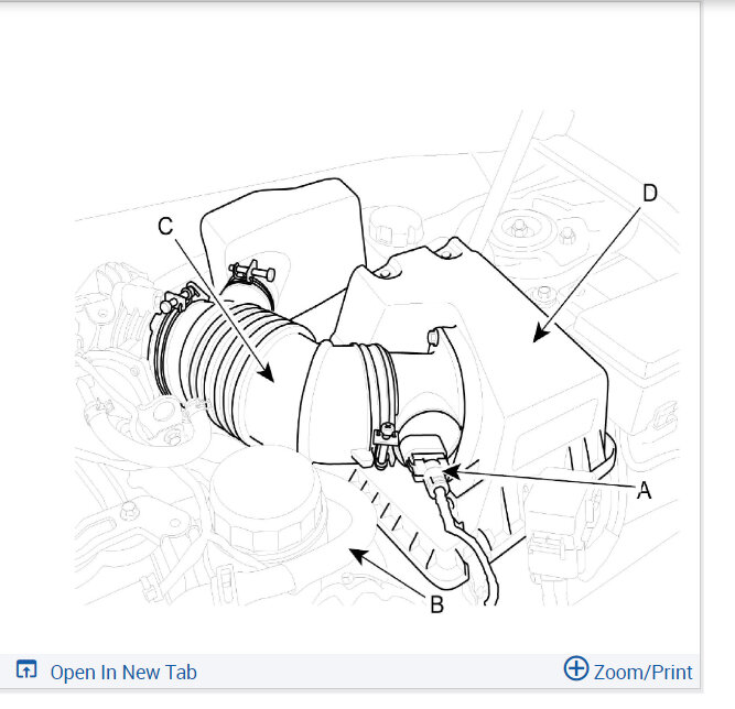

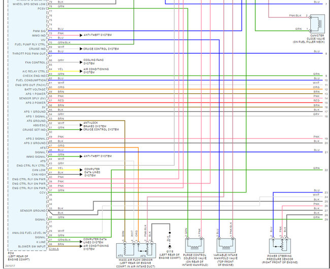

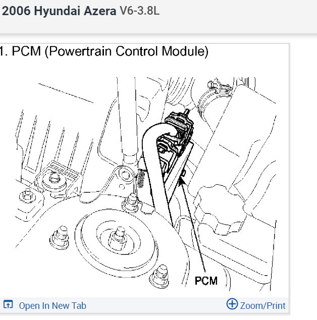

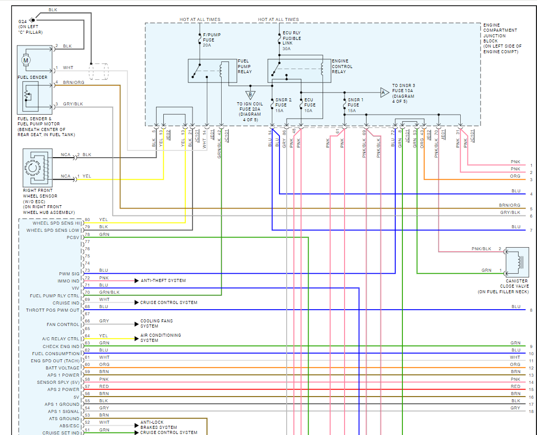

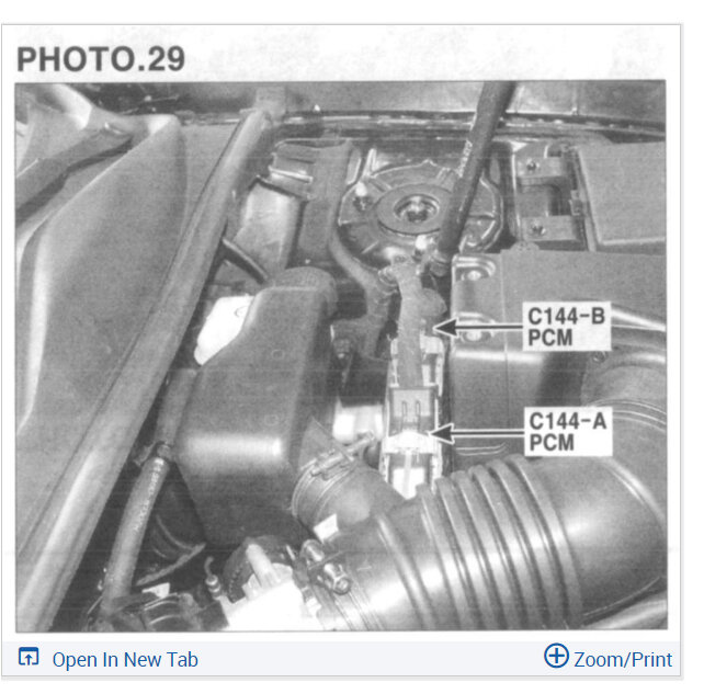

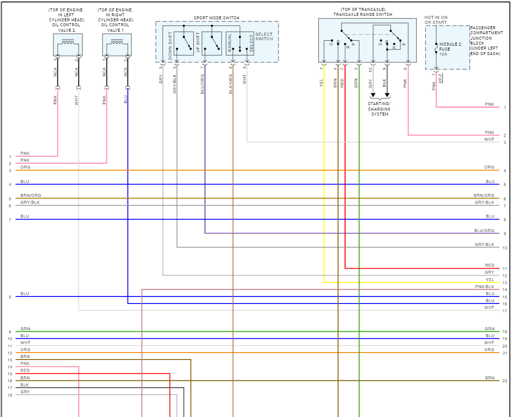

So, you installed a new throttle body, correct? Did you clear the codes after? These are for the throttle body so the only other thing is the wiring needs to be checked or the PCM is bad, here is how to check the wiring and the diagrams below with the PCM replacement instructions which you can get a preprogrammed unit by searching google or Ebay.
