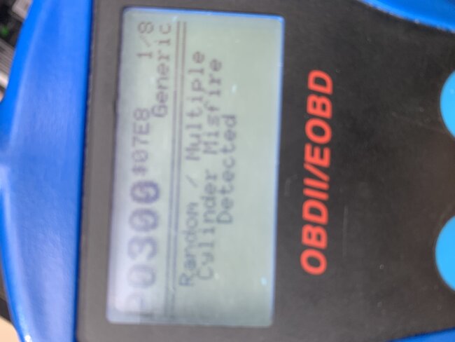

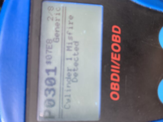

Recently I put in a new alternator, new ECM/PCM. I’ve changed the coils and plugs numerous times, but my engine light keeps popping on and once I read, the codes one day it’ll say: P301 Cylinder 1 misfire. Next day it’ll say: Random Multiple cylinder misfires. I don’t know what else it could be, and it happens a lot in Bay 1 on my engine. (These were also old codes before I changed my ECM, when I put the new one in, I cleared the codes out).

This can be a few things. By chance, can your scan tool provide live data? If it can, connect it and start the engine. Allow it to reach operating temp and check the short-term fuel trims. Let me know what they are.
Also, have you checked things like fuel pressure and for vacuum leaks? If you switch the coil in cylinder 1 with a different cylinder, does the misfire change cylinders?

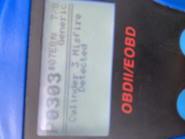

So I’ve recently put in a new ECM, alternator changed my spark plugs and coils 2 different occasions but prior to that I had a battery drainage problem (which is now fixed) but I still have the misfire on my bank 1 side of my engine it started off with Cylinder 1 then went to 3 then on to 5 I just put it on one of my basic computers and it says the possible solution: replace fuel injector wire. Can someone possibly assist me with trying to figure out what it could be. My timing chain is not making any noise or slapping against anything so it is not that.

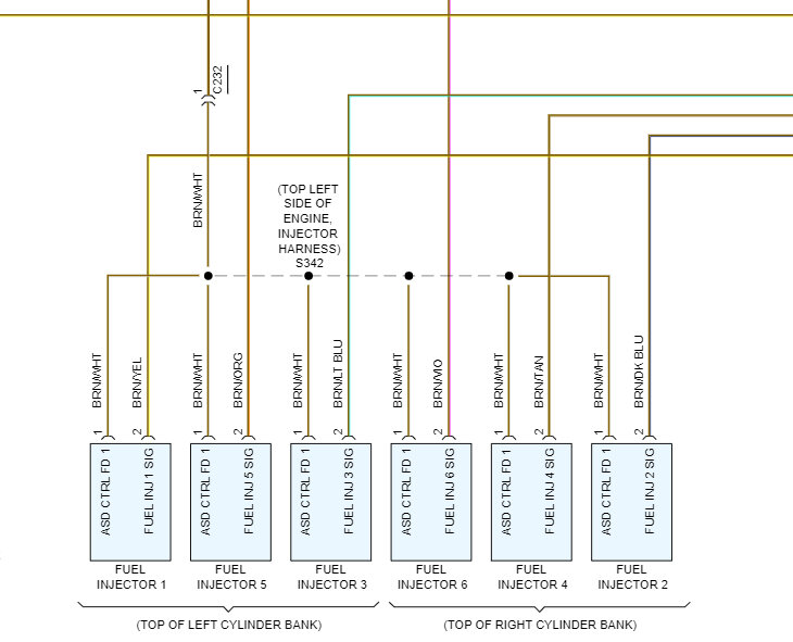

There could be an issue with the fuel injectors. I attached a pic below of the wiring schematic below. Note that each fuel injector has a brown wire with a white tracer. With the key on, that should have battery voltage. Confirm that on the cylinders that are affected.
If they have power, disconnect the connector at cylinder 1. At cylinder 1, there will be a brown wire with a yellow tracer. That is the ground path that is provided via the PCM.
Take a test light and connect the alligator clip to the battery positive and the lamp to the brown/yellow wire. Have a helper crank the engine. The light should strobe on and off.
Let me know what you find.
See pic below.

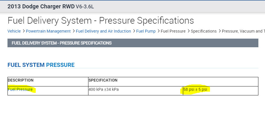

That sounds like a fuel pressure restriction in the tank. If you get the fuel below half a tank, see what the fuel pressure is. An injector won't fail because of the fuel level. Something may be limiting the pressure needed.
Here is a link that explains how to check the pressure. Also, I attached the manufacturer's fuel pressure specifications below
If you feel it is an injector issue, try the test I indicated above when the problem happens. Also, here is a link you may find helpful:
