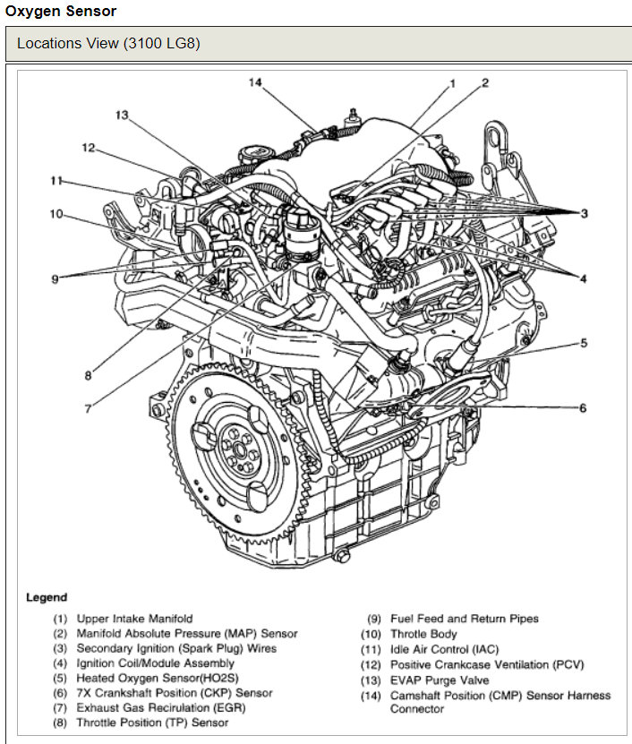

Oh we can fix it for way less, lets get started. For the P0135 heater circuit here is a guide to show you how to fix that you can get the sensor from Amazon. It is number five in the diagram below.
https://www.2carpros.com/articles/how-to-replace-an-oxygen-sensor
Here is the sensor for $27.00:
https://www.amazon.com/gp/product/B000C5WCOA/ref=as_li_qf_asin_il_tl?ie=UTF8&tag=2carprcom-20&creative=9325&linkCode=as2&creativeASIN=B000C5WCOA&linkId=8ac464d0370e53c52579cc44371b9838
You may need to jack you car up.
You will need to clear the codes.
https://www.2carpros.com/articles/check-engine-light-clear-codes
The auto parts can do it for you as well. By the way neither of these problems will effect the way the engine runs except for the o2 sensor heater but not much.

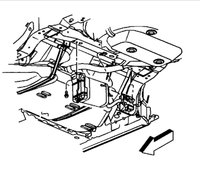

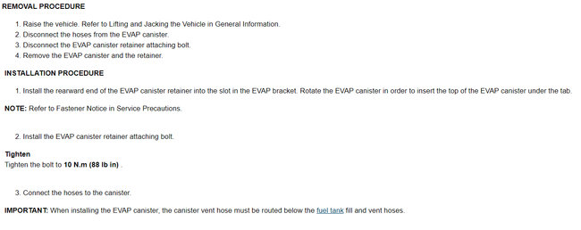

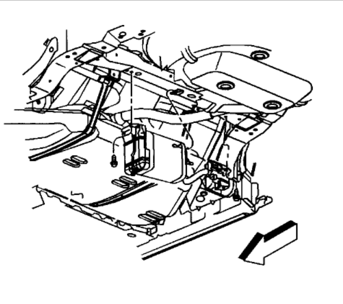

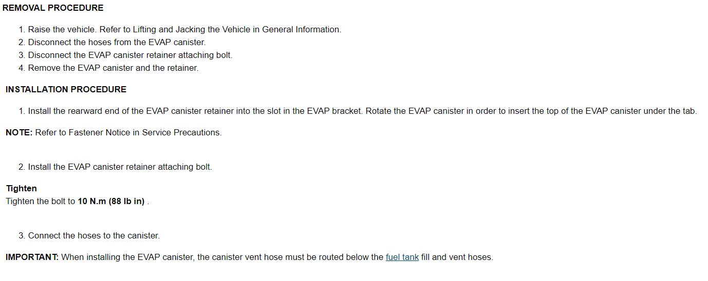

The other two are EVAP codes here are the locations of the solenoids inspect the wiring and then replace the units number thirteen on the diagram. Check on Amazon as well or the parts store will have them.
