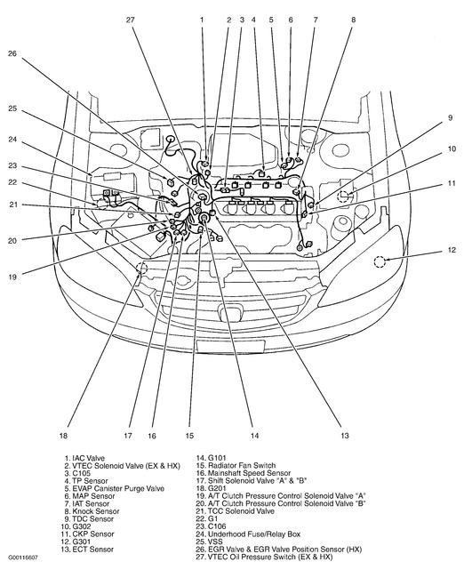

Engine light is on, the code P0325 Knock Sensor
2002 HONDA CIVIC
144,000 MILES • 1.7L • AUTOMATIC
FRED LOPEZ
MEMBER
1 POST
where is it located at the front of the engine or the back.

FOUND THIS DIAGRAM IN "PRODEMAND" IN ABOUT TWO MINUTES TIME!
(USUALLY TAKES ME HALF AN HOUR TO POUR THRU THE INFO)
WELL ANYWAY, LET ME KNOW IF THAT HELPS YOU
