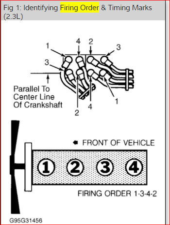

Which cylinder is number four? Code P0304 is misfire detected on cylinder number four. Starting at the front is it the cylinder that is closest?

It is the cylinder nearest the firewall. I have attached a picture showing the firing order. Hope this helps and thanks for using 2CarPros.

Thanks! Now, how do I figure out the order of the wires on the distributor?
