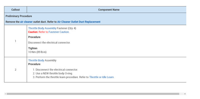

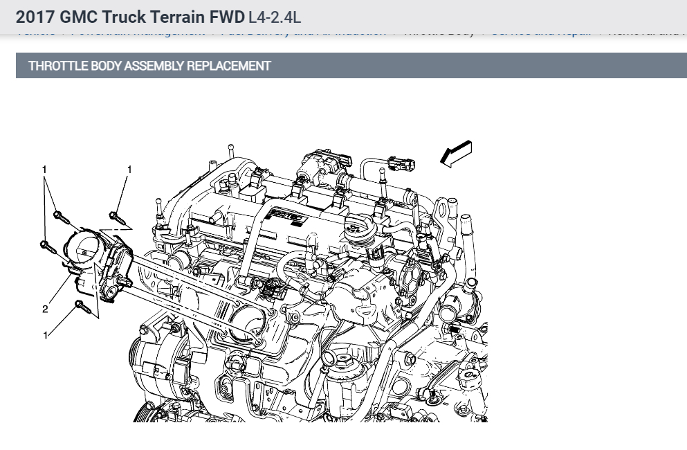

I hit my brakes, the car stalled, and check engine light came on.
May 2, 2023 at 12:57 AM
  • 55,402 POSTS
This sounds the throttle bore has gone out but to be sure we need to run the codes, here is a guide to help and I have included how to change the throttle bore out in the images below in case you need them.
