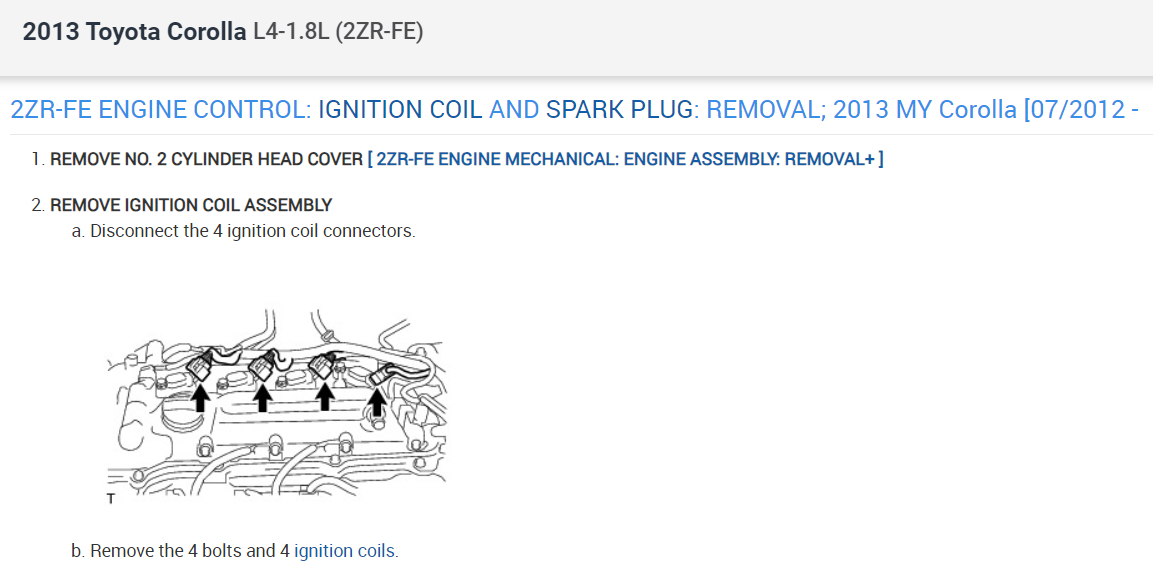

Yesterday my car's engine light and the trac off light came on and my car was rough/slowing down. I took it to my mechanic, and he changed out my spark plugs and said it's all fixed. I turned my car on, and the 2 lights were still there. My car is driving better but I still don't like that the 2 lights are on. Tonight, i did a checker and I got the p0302 code indicating cylinder 2 misfire.
Any advice?

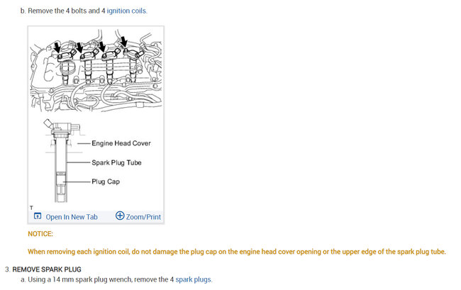

Yep, that means #2 is still misfiring, I would do a compression test and if okay replace the ignition coil on that cylinder which is a common failure.
Here is a guide to help:
And this guide can tell you more on misfire problems:

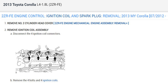

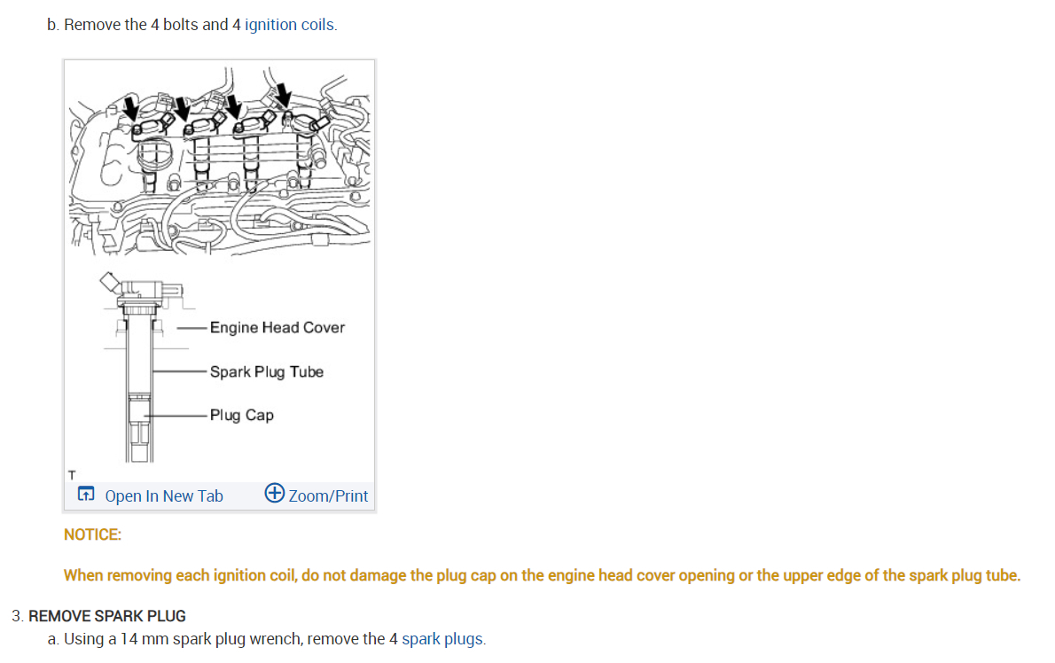

Please go over these guides and get back to us. Here is how to change the coil out. Check out the images (below).
