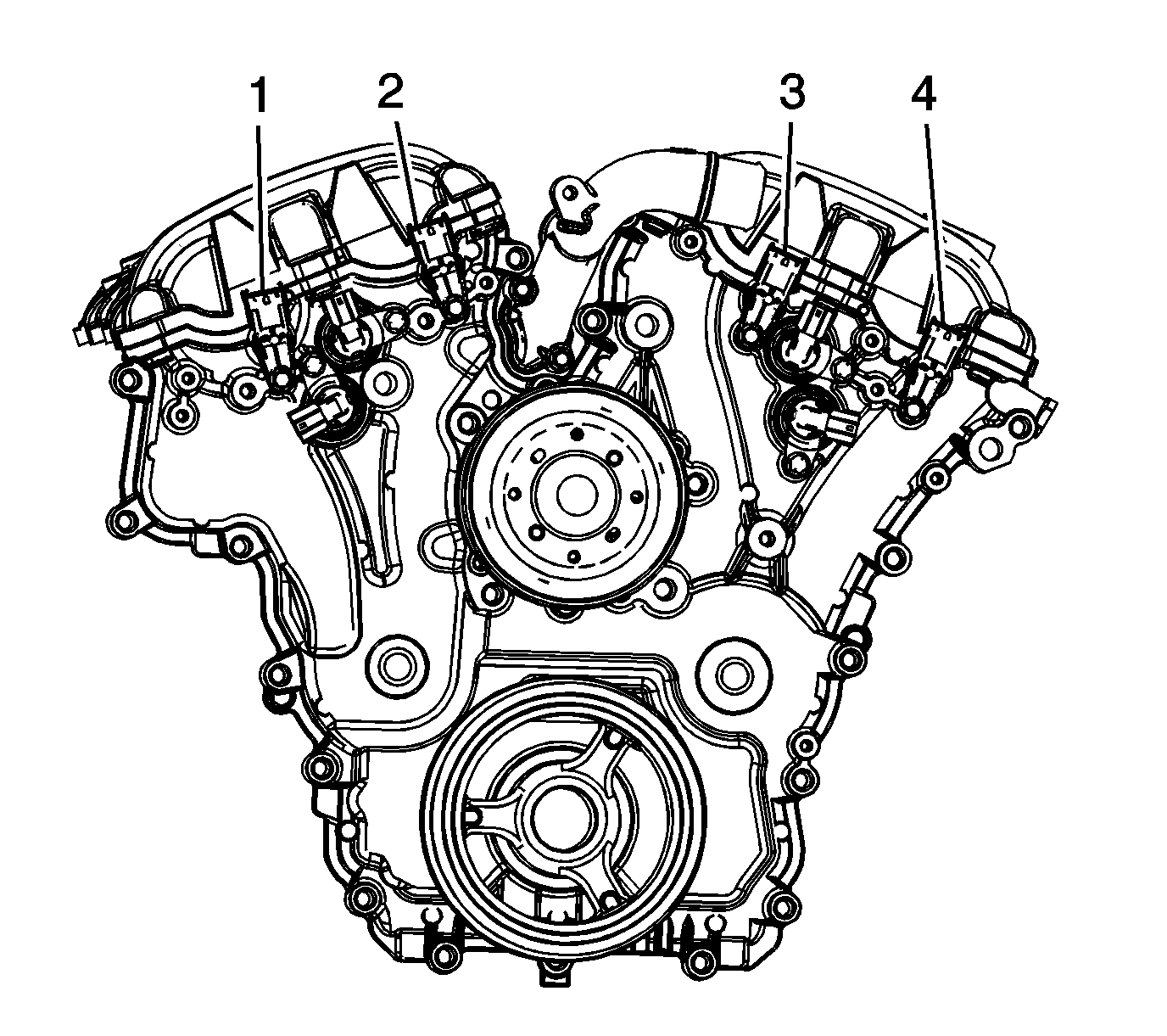

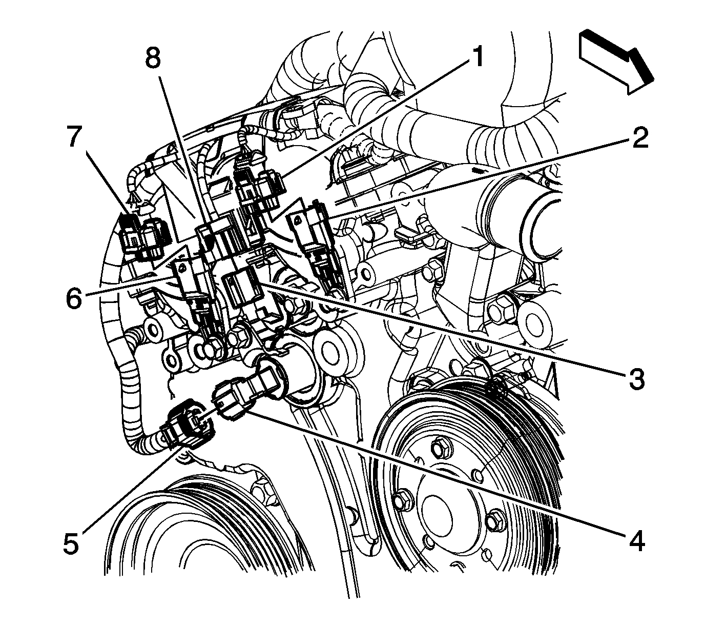

Here are the directions for replacement of the sensor. Make sure where it bolts into the engine, it is clean and nothing is blocking pressure to the sensor. The attached pictures correlate with these directions.
CAMSHAFT POSITION SENSOR REPLACEMENT - BANK 1 (RIGHT SIDE) EXHAUST
REMOVAL PROCEDURE
1. Remove the engine mount strut and bracket.
2. Disconnect the engine wiring harness electrical connector (7) from the bank 1 exhaust camshaft position (CMP) sensor (6).
3. Remove the CMP sensor bolt and sensor (1).
INSTALLATION PROCEDURE
1. NOTE: Refer to Fastener Notice.
Install the CMP sensor (1) and bolt.
Tighten the bolt to 10 N.m (89 lb in).
2. Connect the engine wiring harness electrical connector (7) to the bank 1 exhaust CMP sensor (6).
3. Install the engine mount strut and bracket.
