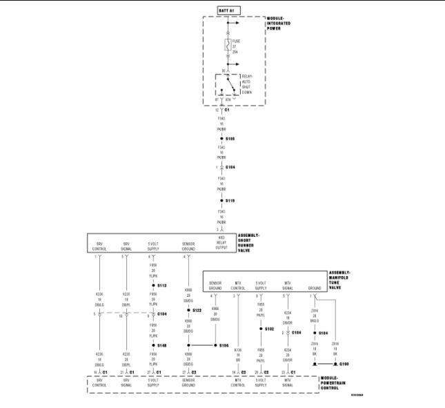

I put my car on the machine because engine light came on. It came back with code p0660 manifold tuning valve. I replaced the whole unit and the light still on with the same code p0660. What can I do next to fix the problem?
Nov 11, 2018 at 9:54 PM
Good morning.
The issue needs to be diagnosed before replacing anything. that was an expensive guess. Codes rarely identify bad parts, they show systems that have a failure.
Anyway, I listed possibilities below for the code as well as a description.
The first thing you should do is verify power and ground to the unit. Wiring diagram attached.

Always perform the Pre-Diagnostic Troubleshooting procedure before proceeding.
Diagnostic Test

5. (Z816) GROUND CIRCUIT OPEN OR HIGH RESISTANCE
Using a 12 volt test light connected to 12 volts, check the (Z816) Ground circuit in the Manifold Tune Valve Assembly harness connector.
NOTE: The test light should be illuminated and bright. Compare the brightness to that of a direct connection to the battery.
Is the test light illuminated and bright?
- Go to 6
- Repair the (Z816) Ground circuit for an open circuit or high resistance.
- Perform the PCM Verification Test. See: A L L Diagnostic Trouble Codes ( DTC ) > Verification Tests > PCM Verification Test
6. MANIFOLD TUNE VALVE ASSEMBLY
