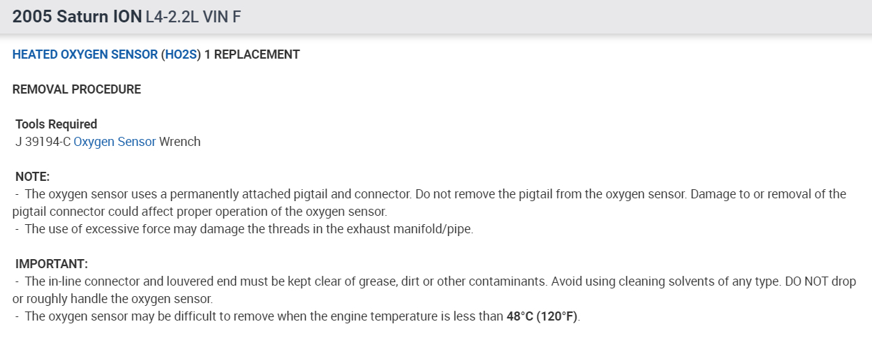

The engine light always came on when I got to a half tank, I would redo the cap and in a mile, it would go off now on steady I did a OBD2 check it can up with p0135 and p0106 should I just replace sensors or could it be more than that.
Oct 15, 2023 at 2:03 PM
  • 55,456 POSTS

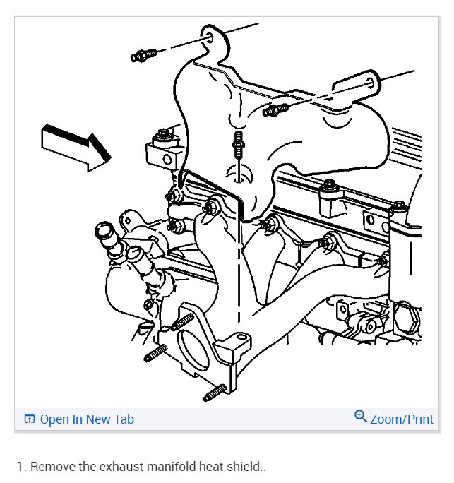

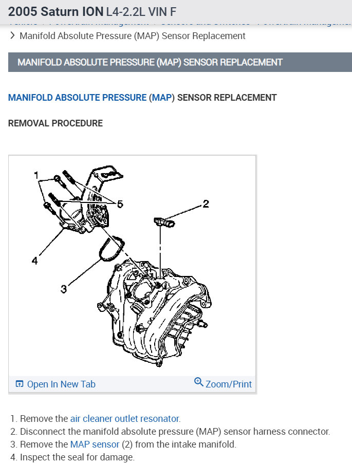

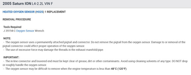

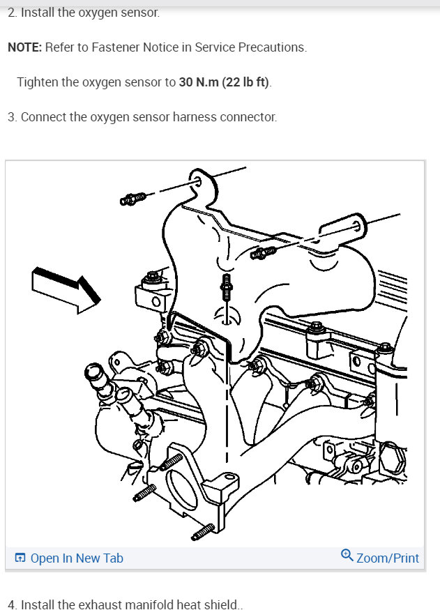

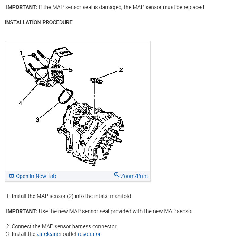

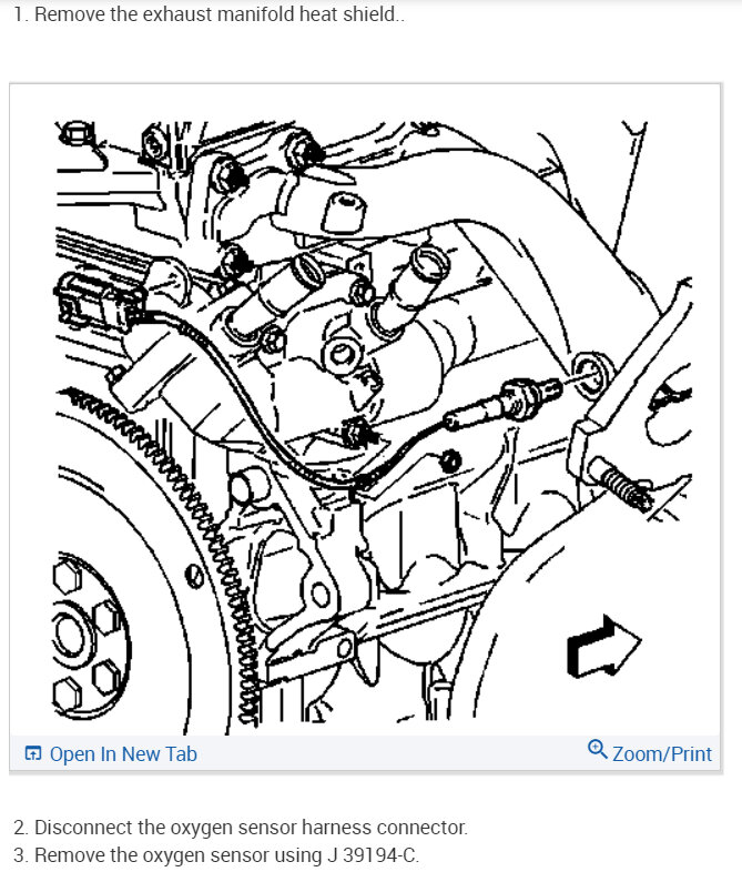

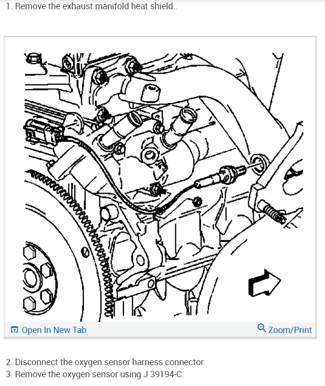

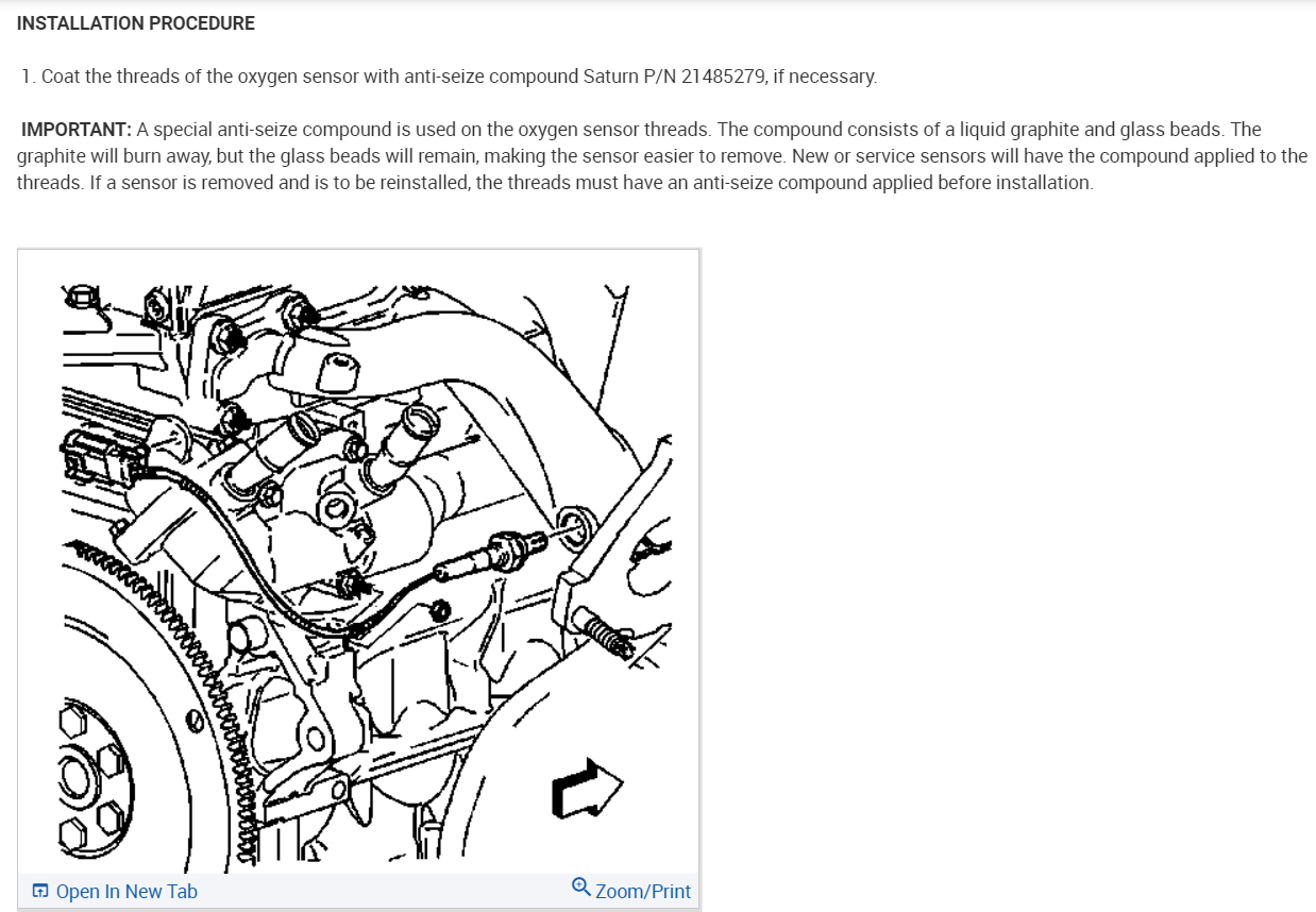

Did you replace the MAP and oxygen sensors? Here are the locations so you can confirm the correct sensors were replaced, also you must clear the codes after the repair.
P0135 - O2 Sensor Heater Circuit Malfunction (Bank 1, Sensor 1):
P0106 - Manifold Absolute Pressure (MAP) Barometric Pressure Sensor Circuit
