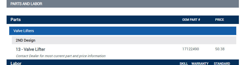

Now that the oil pressure is low it means something is wrong like the incorrect lifters were installed? Can you please shoot a quick video with your phone so we can hear the noise? that would be great. You can upload it here with your response. Lets run the codes and do a compression test to see if we can find out which cylinder is having the problem.

You said you had low oil pressure, what is the PSI?
I suspect he either installed the wrong lifters or installed longer pushrods.
Does he have the part numbers of the parts he used? If the vehicle is louder then it was then I suspect he installed longer pushrods which will keep the valves slightly open and you may have the exhaust valve hanging open during the combustion or it is opening quicker on the cam lobe.
Let's start with this and go from there.
I attached the part number for the lifters below. Let's make sure they are correct.
