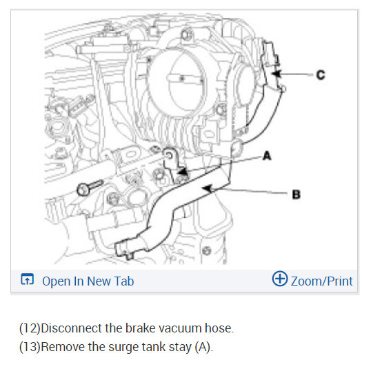

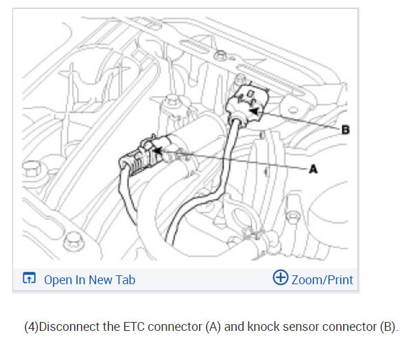

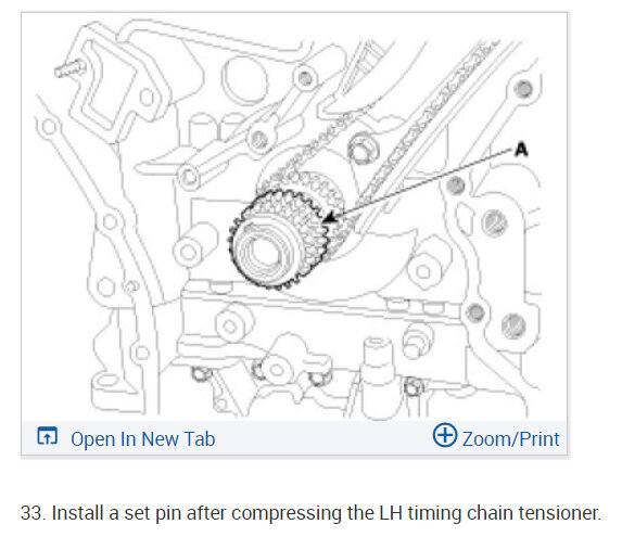

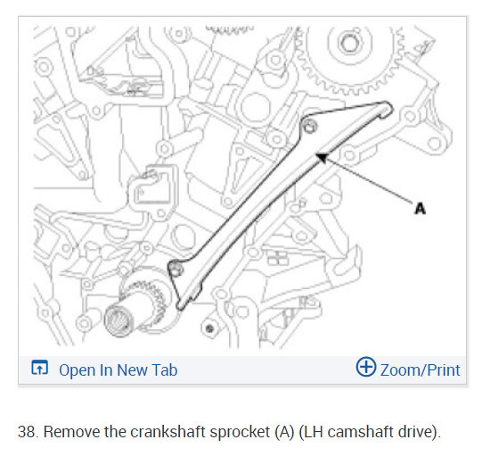

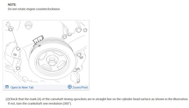

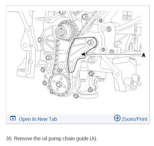

  • 55,746 POSTS

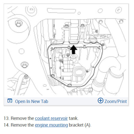

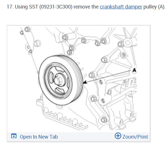

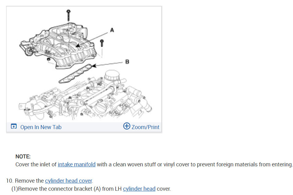

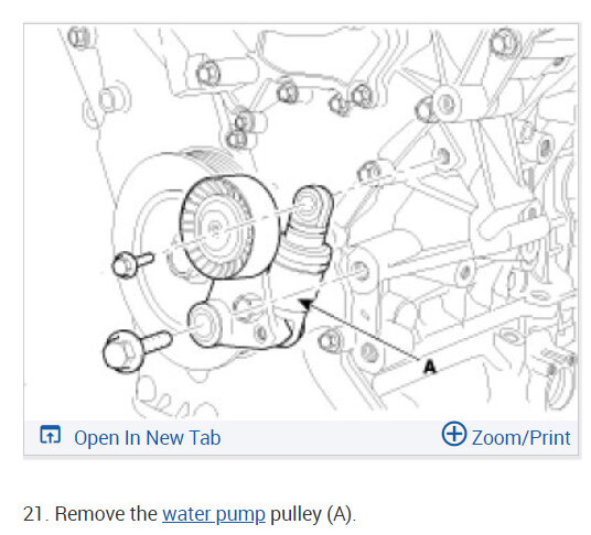

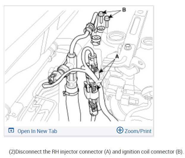

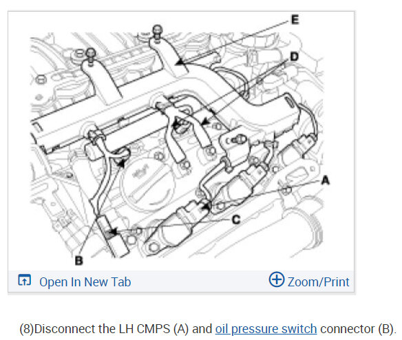

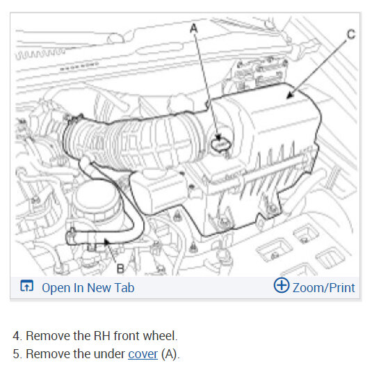

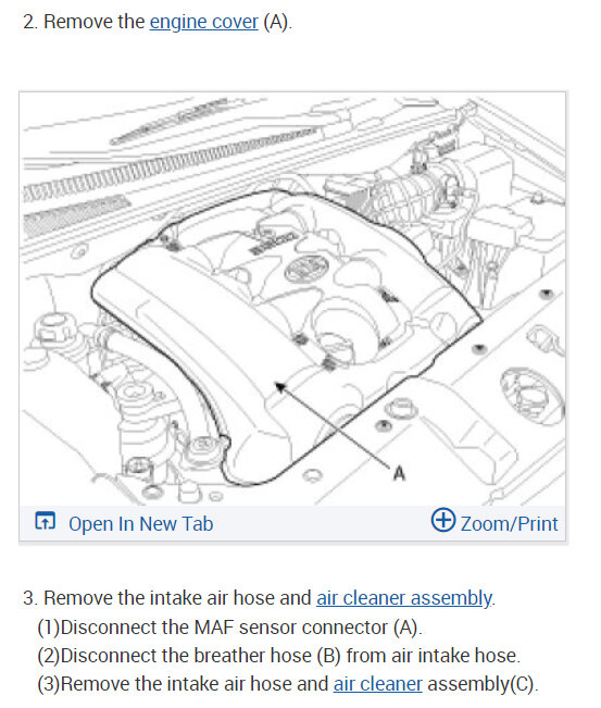

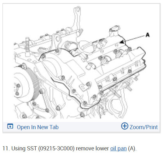

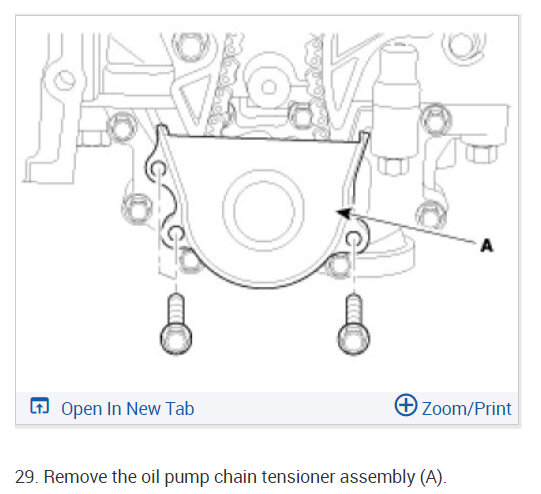

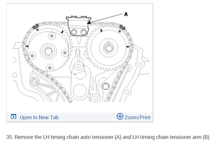

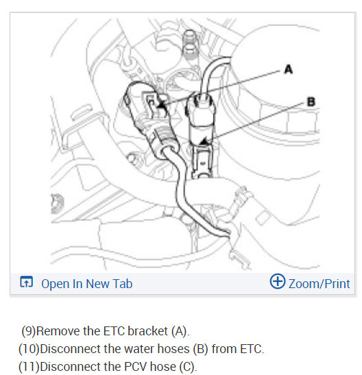

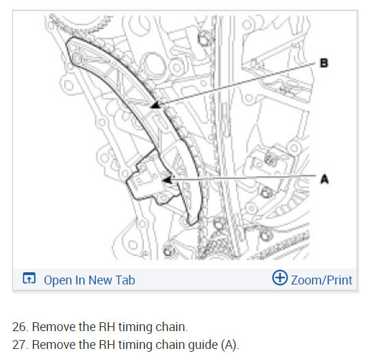

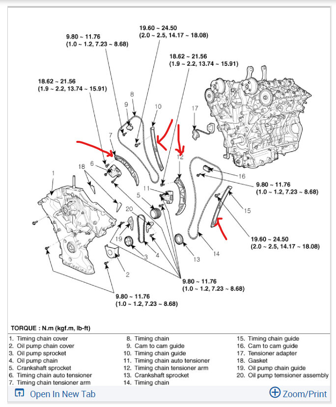

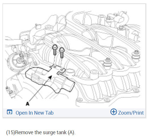

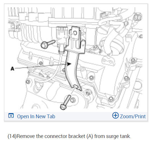

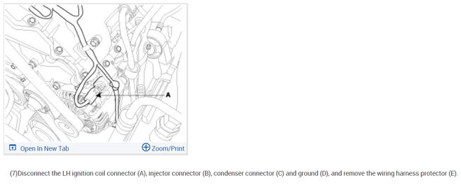

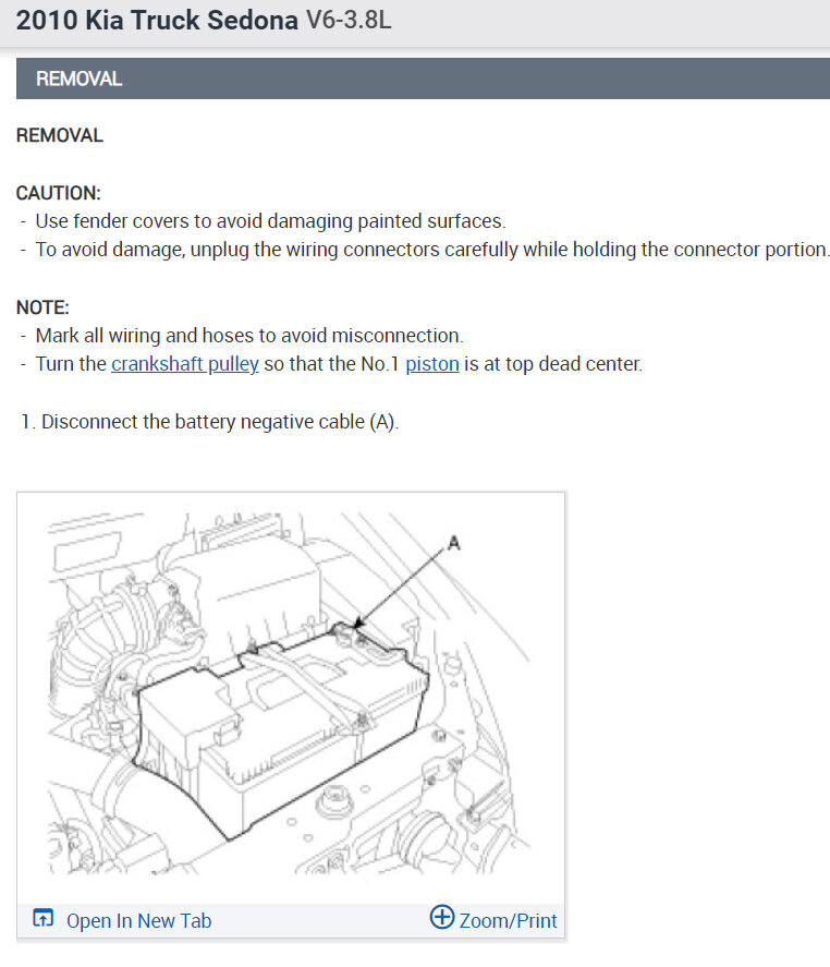

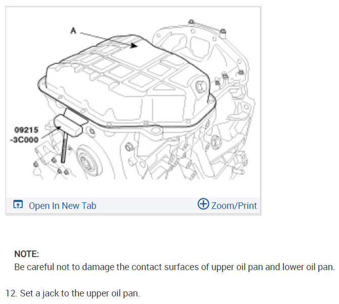

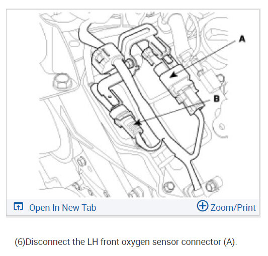

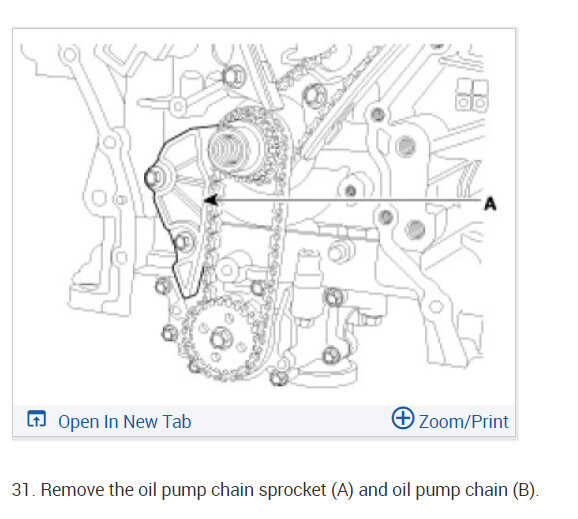

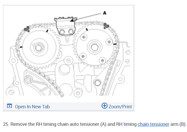

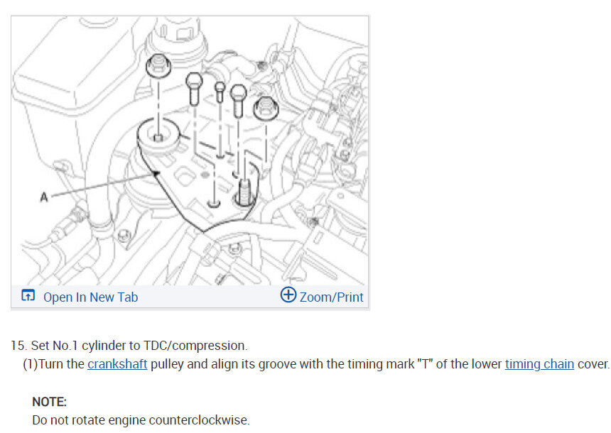

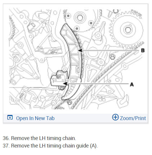

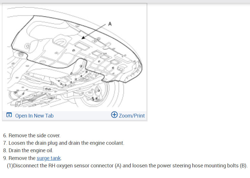

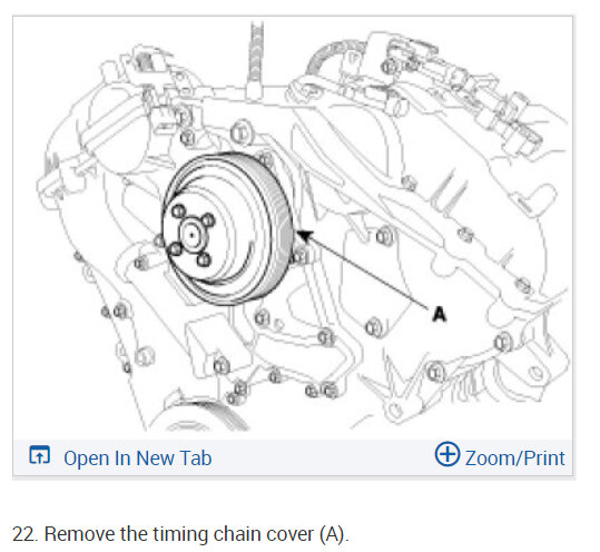

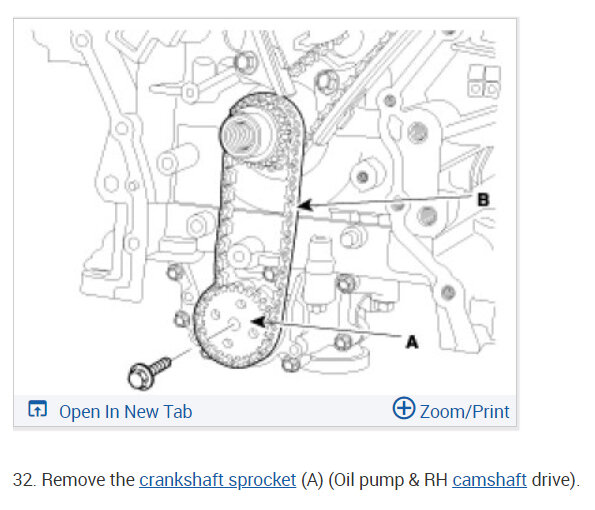

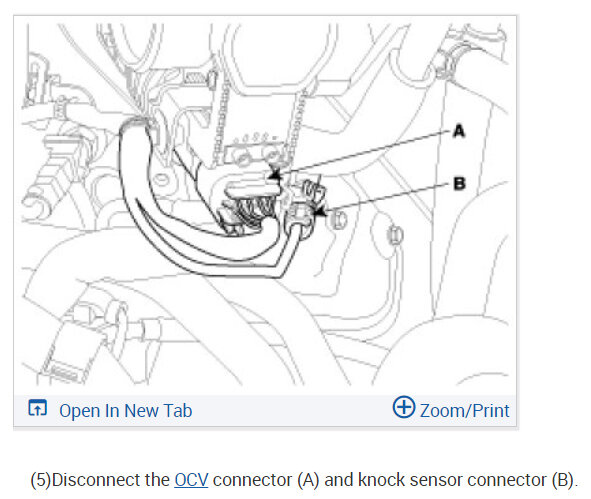

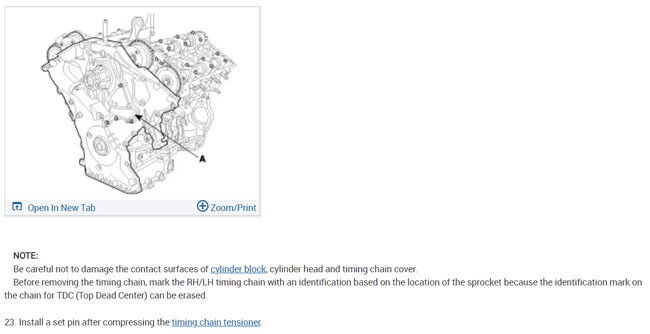

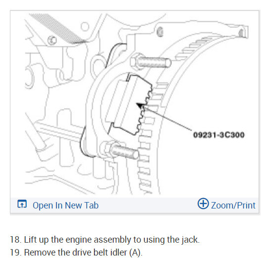

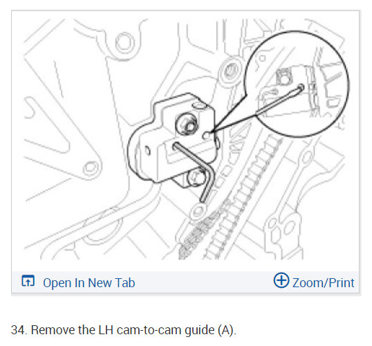

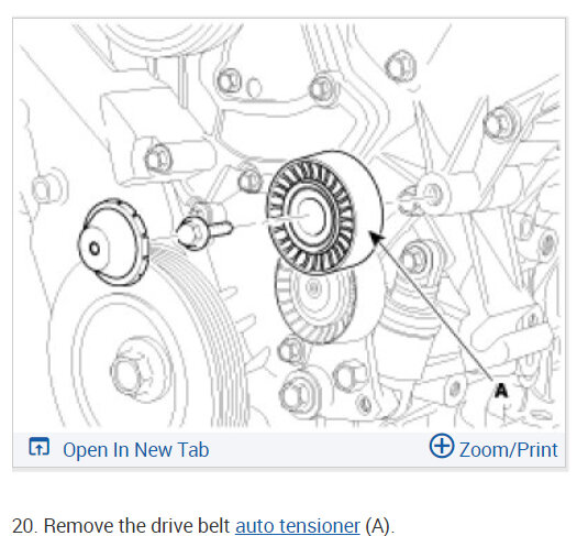

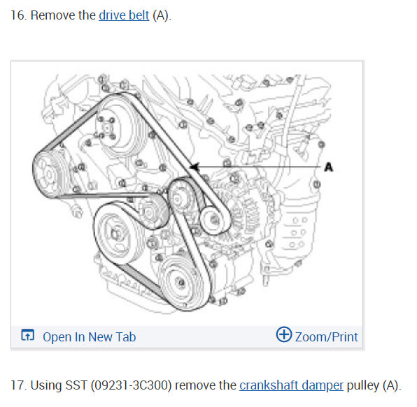

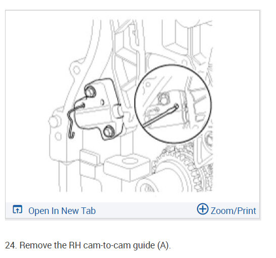

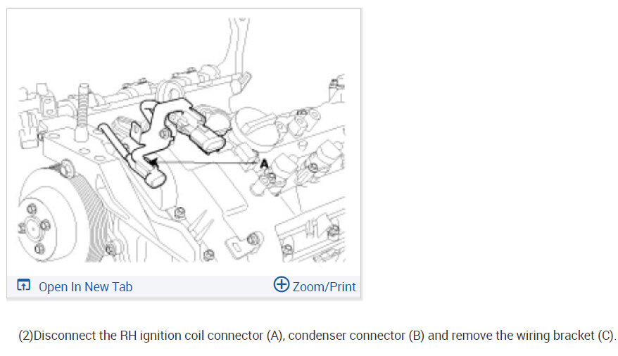

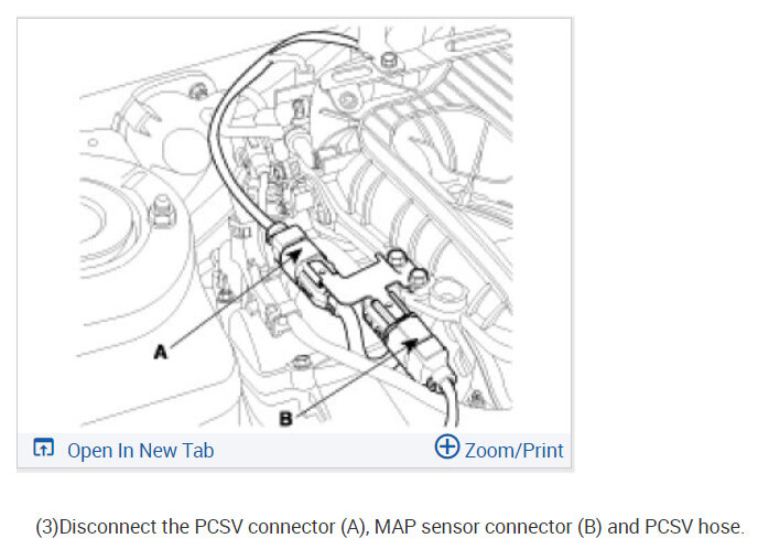

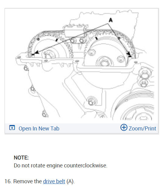

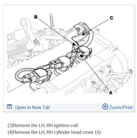

Thanks for the video, it helps. Yes to me it sounds like the timing chain guide has broken and you are hearing the chain contact the case. We can remove the timing chain cover to confirm the issue, here is how. Check out the images (below). Please let us know what happens.

Thank you. In your opinion, do you think it is worth going to all this disassembly if in fact it is the timing chain guide? It starts up every time, idles, doesn't overheat, just this noise. But it does have over 200,000 miles on it. Been a very good van though for the last 4 years.
